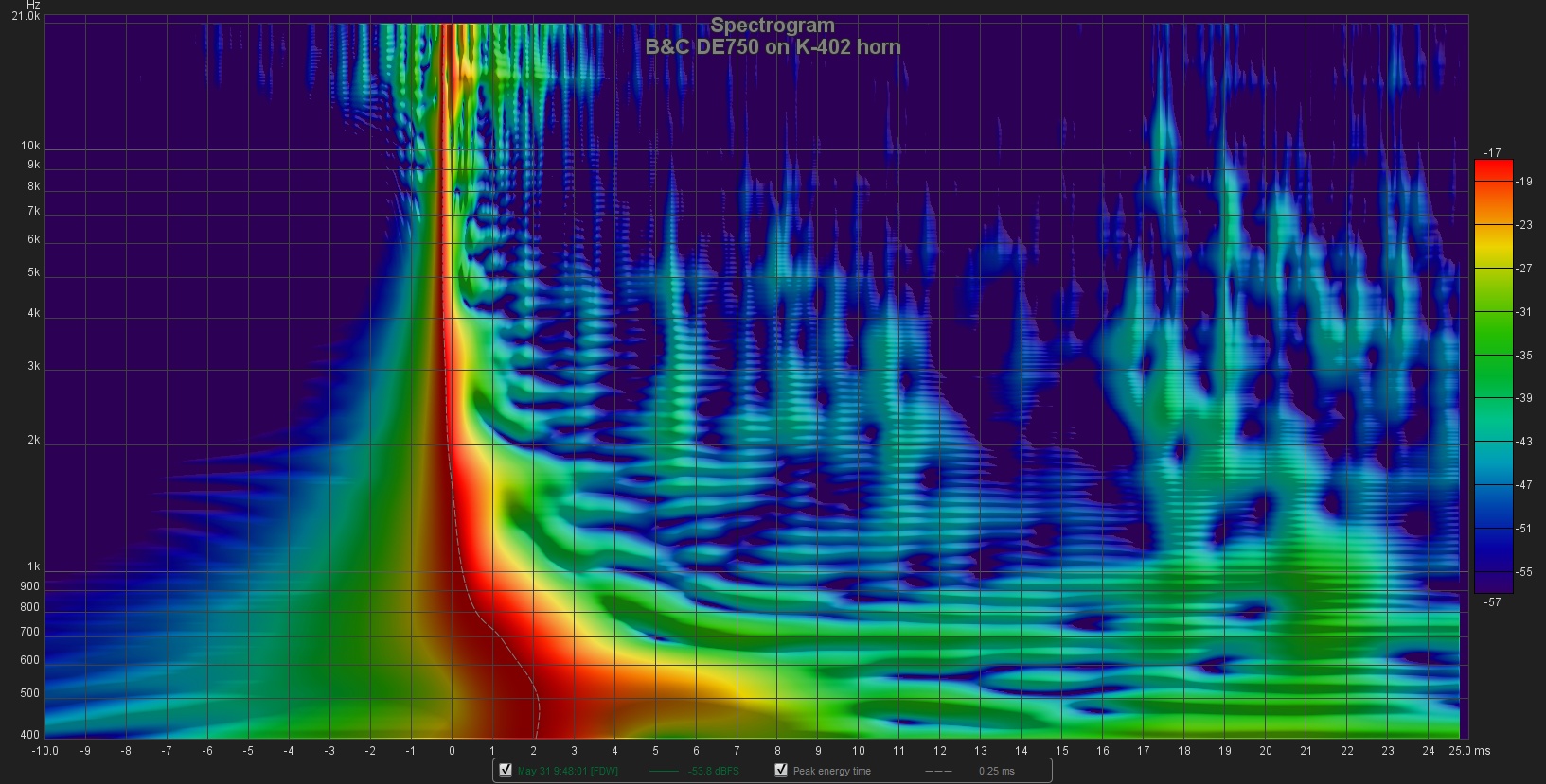

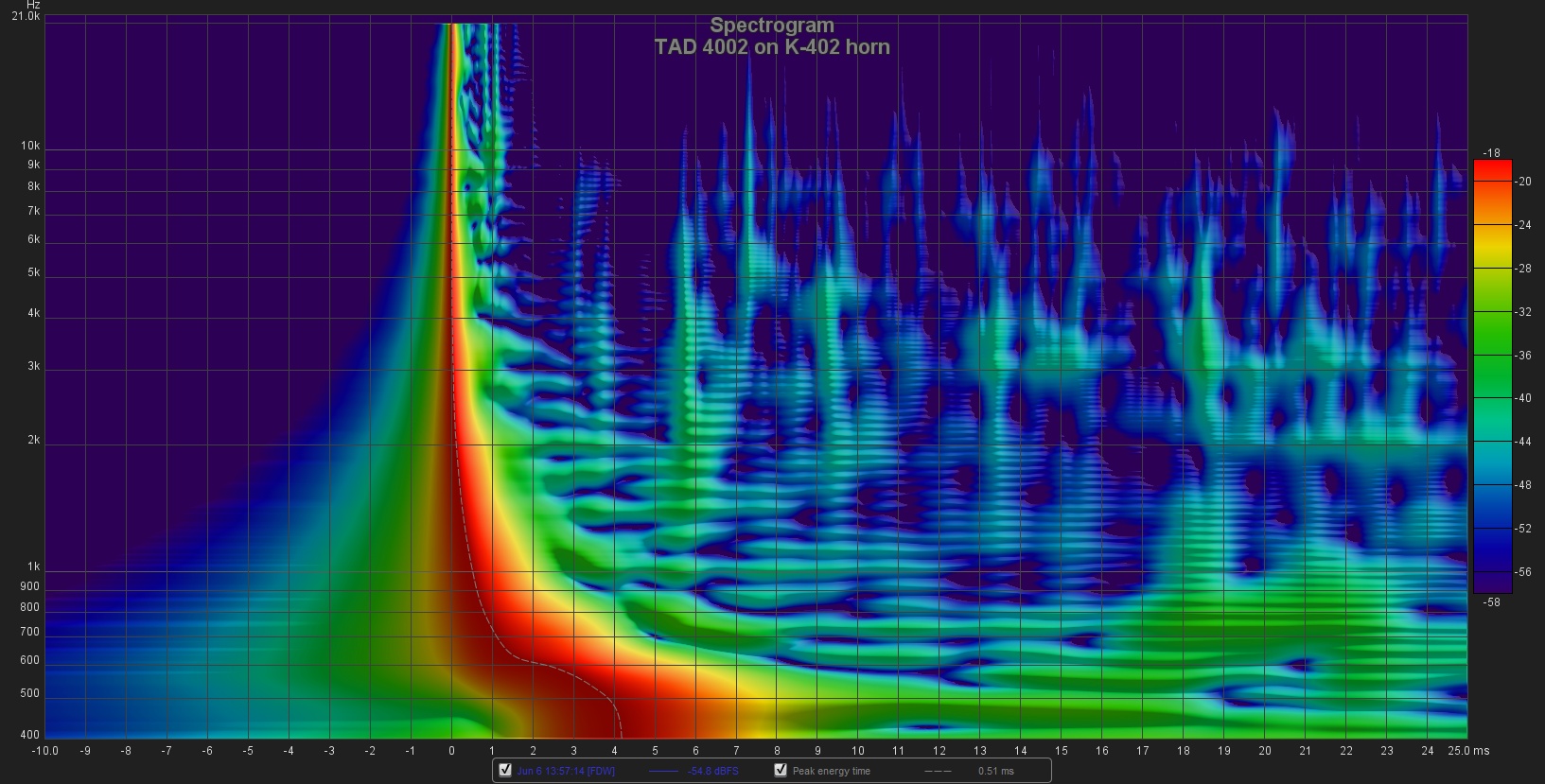

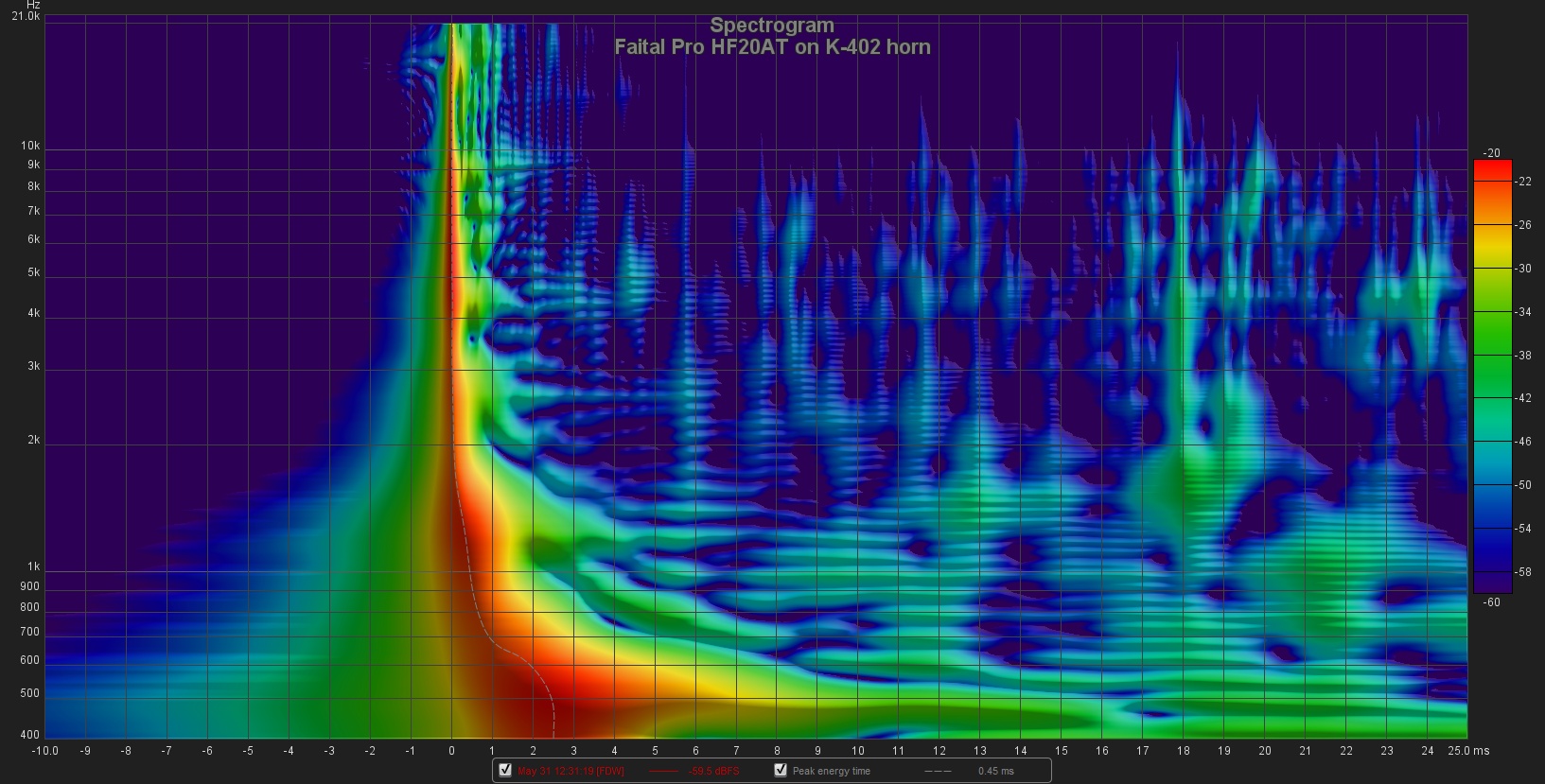

So here are the same compression driver spectrograms in jpg format:

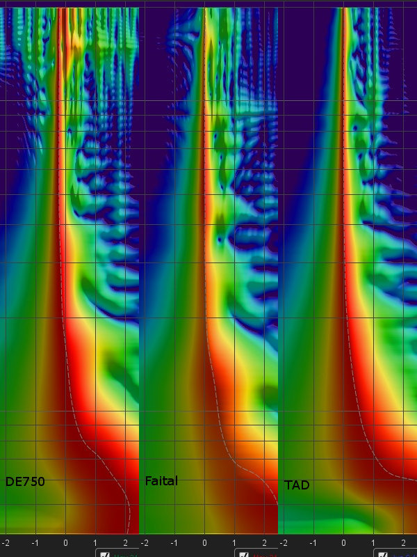

So most of the valid info is in the first ms or two, right? The JMMLC pdf indicates that HF resonances are in the first 1ms.
The Le Cléac’h plots were "done inside a very large room" and "First visible reflection of the room comes after 7.5ms", so presumably anything over this is guff.
When I look at your 3 plots, focusing on the first few ms, the DE750 looks very bad at 15kHz, which I can understand - it matches up with the big spike on the driver's spec sheet.
So: if this 15kHz spike was notched out with DSP, would it largely 'fix' the spectrogram? Is there anything else on the spectrogram that would explain why the Faital would sound better than the DE750?
My (limited) experience seems to be that even with the bad bits notched out, there is still something wrong with (big) titanium diaphragms - It'd be nice to know that there is a measurable way to show this.
The TAD seems to have the cleanest plot >10kHz. The TAD also lacks 'pre ringing' (which is something I don't understand - how does a diaphragm 'know' that a signal is coming? A Google search on the term only turns up info on digital filters).
The Le Cléac’h pdf is not an apples-to-apples comparison like this, but those plots also make the beryllium diaphragms look very good.

I posted that information in order to point out that generalizations on "2 inch titanium diaphragms" should be offset based on the relatively good experience with the Faital Pro driver(s). If the Faitals can do it well, then it can be done well using titanium diaphragms on 2" throat drivers.
In terms of what you can do with the B&C, I'd recommend using a tweeter to avoid that portion of the driver's frequency band (about 12 kHz on up), so crossing at 8-9 kHz to a tweeter works well. I did this with a P.Audio BM-D750 series I driver to a Beyma CP25 tweeter at 8 kHz and the performance measured very well.
The problem of course comes if you're trying to use a 2" B&C driver for MEH duty. I'd personally recommend a Faital Pro or dual-diaphragm BMS driver instead for MEH duty. The B&Cs that I've seen just don't damp their diaphragm breakup modes like the Faital Pros. I'm not sure what the difference is in design.
I've tried a narrow notch on the break-up mode at 13.8 kHz using the P.Audio driver, but I missed the spectrum immediately in listening, and instead went to the separate Beyma tweeter with good success.
But I was not doing a MEH at that point--rather a tri-amped "JuBelle" (Belle bass bin, K-510 midrange, Beyma CP25 tweeter) and had a very solid center channel between my two Jubs--and the timbre matched well. The only thing that it lacked was apparent source width (ASW). I created the K-402-MEH prototype to solve the ASW issue.
I'm not sure about the pre-ringing, but it may be an artifact of the up-sweep conversion process (collapsing the up-sweep into an impulse plot algorithmically) which produces the pre-ringing. I do know that there is a great deal of acoustic ringing that is occurring near the diaphragm break-up modes, and this splatters about in the up-sweep and the resulting constructed impulse response plots. If the diaphragm was well damped, or if it were as light and stiff as beryllium (about a factor of 7 improvement in stiffness-lightweight performance over titanium), you don't see all the ringing or pre-ringing.

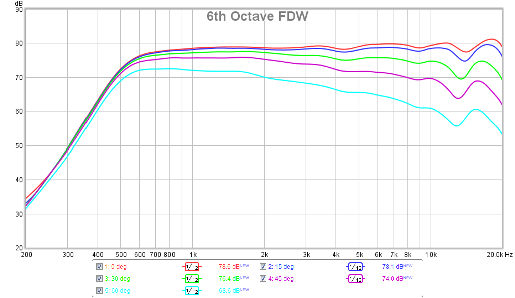

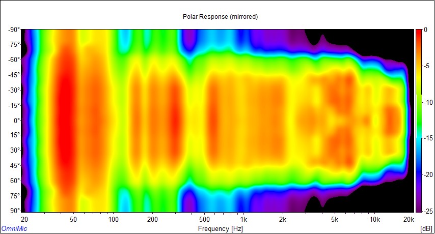

Well, you could start to open up the discussion on power, but it remains that the Ti diaphragm is behaving not like a piston but rather like a membrane, while the Be diaphragm still is behaving like a piston--at these frequencies. And as you up-sweep the drive signal, it's pushing that Ti membrane into very complex internal energy modes that change very rapidly with small changes in drive frequency.
The phase plug adds its own dynamics to the summed output on the horn throat side of the assembly, so the result isn't very easy to lump into power- or SPL-only states, but rather like a 3-D impedance state.
The effects of power output vs. SPL on-axis can begin to be seen in the spectrogram plot above 12 kHz, reproduced again here:
So the picture gets messy and the returns on the investment of time in understanding and dealing with the dynamics and the 3D effects begins to lessen in its eventual payoff. The good thing is that the human hearing system really can't hear the harmonics or discern much about the summed SPL direct arrivals vs. power summation of the closely off-axis energy, It all begins to sound like direct arrivals due to the higher absorption characteristics of the horn walls and perhaps phase plug materials (for polymer phase plugs) at those frequencies, as well as the inabilities of the processing portion of the human hearing system (being a basic 1ms system that I mentioned earlier) to sort out the differences. You're basically at the detection-only portion of the audio spectrum, and the sensitivity of the detection portion of the hearing system is rapidly declining, perhaps even more rapidly due to presbycusis.
