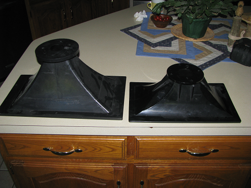

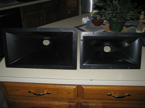

The smaller horn is the K-510, which has much better performance in terms of polar control:
attachment.php
attachment.php
Chris

The horn profiles and mouth roll out are different. One uses a straight-sided horn with unknown coverage angles and either an exponential or truncated tractrix flare.
The other uses a straight-sided horn section with full tractrix flare, plus "mumps" in the corners (a patented horn feature) which controls the "waist-banding" near the horn's axial fc. It was designed to hold its polars more constantly vs. frequency.
The two horns look similar, but they're really not--at least in terms of their performance.
Is this better performance something you've measured?
In some comparisons, the cheap / generic horn has had better polars than the 'impressive' one, e.g:
Yes. I think that the anechoic polars of the Klipsch K-510 are already posted for the vertical direction. The horizontal direction is better. If you're recommending the other horn, I assume that you already have its polars. They're okay.
