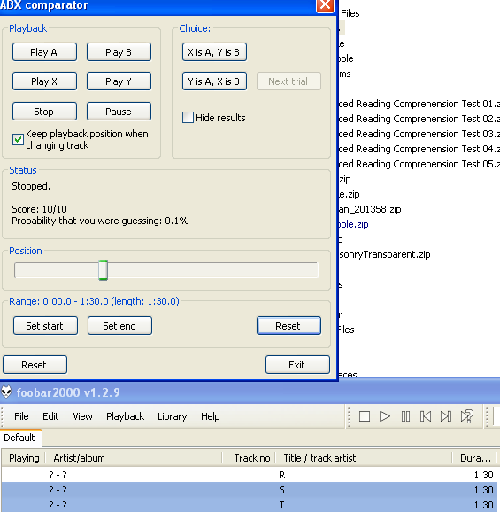

For me, I don't like all files. When I was going to sleep last night, I turned down the volume a lot, but then completely turned it off before going to sleep. But to choose which one I prefer is not difficult, because I prefer accurate sound.
Even between two files that are close (I believe it is direct vs 100% feedback), yesterday in severely sick condition I could do 6/6 only from listening to the singer inhale (one is more accurate)! And from the other song, the brush on the drum is more accurate from this one file.
Basically, I just listened to the accuracy of the voice in all of these files. The most accurate (not difficult to pick) I believe is DIRECT.
Differentiating between the most accurate (DIRECT) and the most artificial (I believe it is MOOLY'S CIRCUIT) is very easy. I have 100% certainty in the ABX but I just stopped at 10/10 because I have many deadlines at work.
ADD:
BTW, Direct and 100% feedback is different but I think I'm "okay" with any of them (not a lot different in preferences).

Jay, your foobar result shows you can hear a difference but which do you prefer to listen to.
T of course. T and S is between the most accurate and the most artificial.
