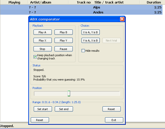

Hi Mooly, great test and great music! I have 5/6

This test was not easy, I had to make several breaks, took headphones down from my head and relaxed before next trial. It needed great concentration, at least for me.
That's good and in a way I'm pleased because I think you might be surprised what the difference in hardware really is on this one. It goes some way to laying to rest a "nagging doubt" and "audio myth" :)

I have learned a lot during these ABX tests. 1st, I have learned how to LISTEN in ABX. It needs different listening behavior compared to in-room listening. No wonder that random collection of listeners found in the street has no results. 2nd, the differences that are often overlooked and trivialized may be proven by ABX. 3rd, human hearing abilities differ :)

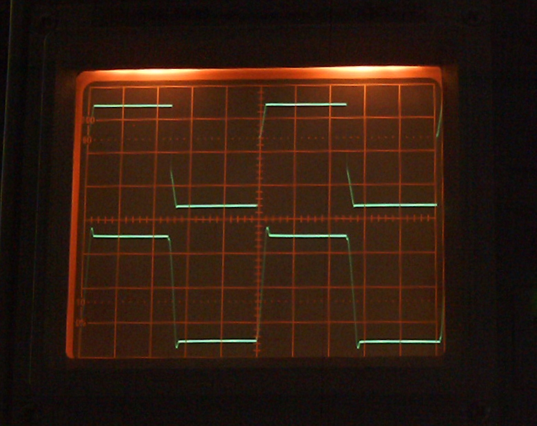

Sine testing shows no real phase shift at all even out to 100kHz.
Squarewave testing shows an expected and little commented on "effect". Top trace is the input to the test circuit (6 volts pk/pk). Notice how the input to the test circuit is actually distorted. That is caused by the non linear loading of the input stage of the test circuit hardware. This effect only becomes apparent above around 1.8 volts pk/pk input levels. The signal source is a 50 ohm generator so that effect is pretty severe to do that. Its an effect thats easily fixed but could we argue its audible as it stands ?
