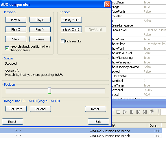

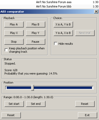

Here is ABX result; I paused to take screen shot. I can't believe that I am not guessing:
If I can get 2/3 in next trials, I'll be amazed.......

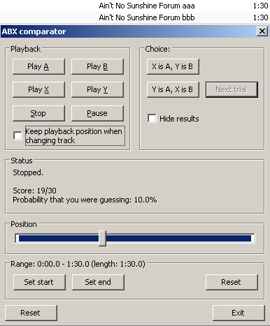

I continued trials, with pauses along the way, out to 30 trials:
The above suggests very little difference between two tracks.
I haven't done ABX for realigned tracks, but suspect that my score would go down.
I don't know what I'm cuing on, but result is statistically significant.
Perhaps it is that tracks are not aligned?

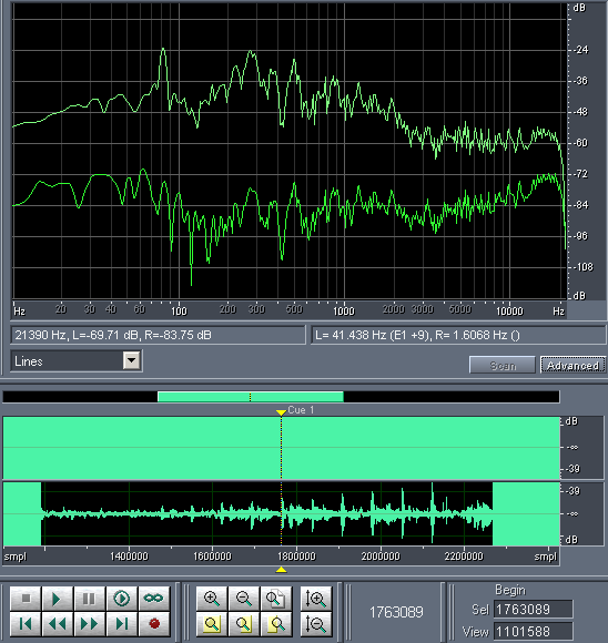

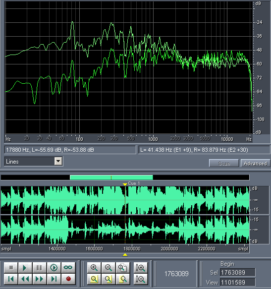

Loading tracks into CE and subtracting aaa left channel from bbb left channel results in this spectrum:
Above, convergence of spectra >2kHz suggests differences that may be cues for differentiation.
Close examination of the wave shows that aaa is delayed approximately 2 samples. When bbb is delayed 2 samples and bbb-aaa is performed this is result:

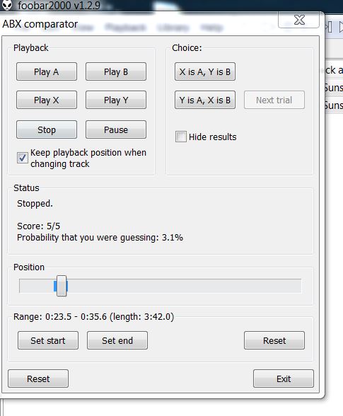

That's a very good result. Although it seems you can tell a difference, do you have a preference for one over the other ?

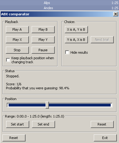

My Alps v Andes ABX result:

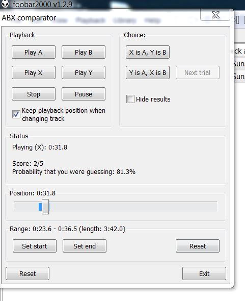

was a joke. I was getting good statistical results, but not the high roller dead ringers here. So when I blew the opening trial for the above pictured result, I decided to go for worse than a just guessing result. I've done some ABX with identical copies of files to see if something in software might be culpable; results really do look like guessing.
Foobar ABX always loads same file order for A and B; nothing wrong with that. For initial listening I do some A/B comparisons to see if there is something that I catch onto. I start by concentrating on bass sounds, and transients with space in between. I look for solo transients of instruments/voices, and then closely overlapped pairings. If nothing jumps out about bass, then I relegate concentration to mostly HF.

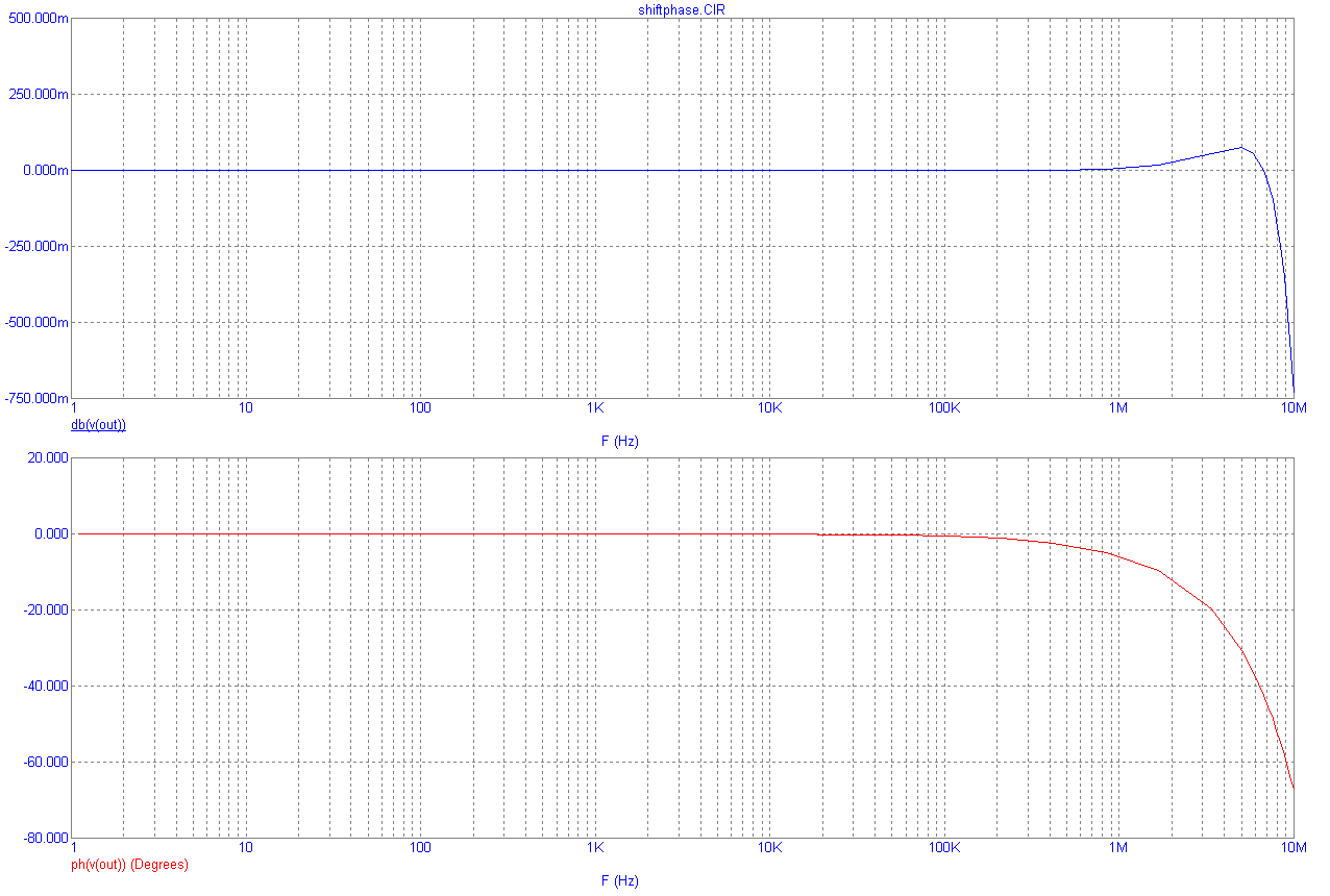

With cascaded unity gain buffers all working at full bandwidth, PMA's assessment of phase margin is a good one. Intermodulation is set up as the phase margin disappears, and is lumped as Op amp function with unity gain feedback, including path length and signals it is exposed to. This is the upward tailing seen in:
This behavior aliases into audio bandwidth and is seen in circuit behavior. This is seen both in DC region of spectrum and up at Nyquist end too. Multiple devices multiples the common behavior. Depending unity gain feedback loops, feed forward can also occur at some level.
