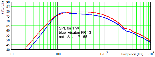

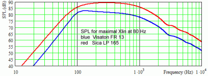

Comparison of the Visaton FR 13 with the Sica LP165.25/280 ER
I use the same open baffle of 30x20 cm. The Sica is mounted symmetrically at 20 cm height. The filter network stays at 3.3 mH and 12 Ohm resistor.
First the respone at 1W. Bigger size leads to generally more SPL at all levels. But the lower Qts value reduces output around Fres:

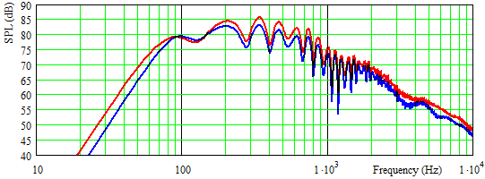

Same with all reflections included:

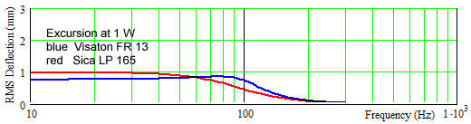

Excursion at 1W does not look to make much difference:

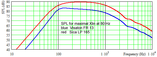

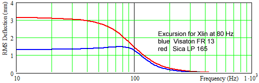

But if you look at the excursion at Xlin and 80 Hz (assumed lowest relevant frequency), the Sica with Xlin=2mm outperforms the FR13:
The relevance is better demonstrated if we look at the maximal output for both drivers when Xlin at 80 Hz is the limit:
In this case the FR13 is powered with 3 W and the Sica with 10 W.
Rudolf

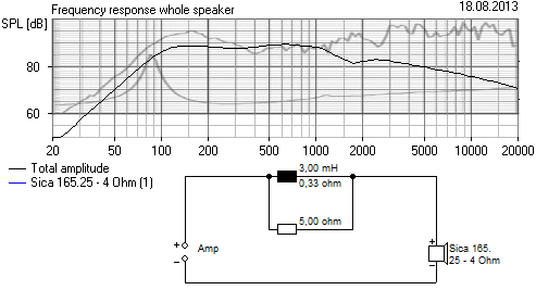

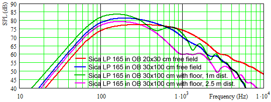

I simulate the Sica LP 165 in an open baffle of 1 m height and 30 cm width - centered at 80 cm from bottom. Shown is the response with a 1st order low pass at 100 Hz in blue. Compare to the 30x20 cm baffle in red:Please, if anyone has any floor speaker design with the Sica post it here. In this case size does not matter, only that the design take full advantage of the speaker.
I added the floor influence for 1 m listening distance in green and for 2.5 m in purple.
Above curves are without a bypass resistor to "rescue" the heights. Therefore I did another simulation with Boxsim and a real filter network:
The grey background is the infinite baffle response of the Sica LP 165 from Sica Breitbandlautsprecher LP165.25/280ER
The fine line in the foreground is the response for the T/S parameters of the Sica in the 30x100 cm open baffle with coil and bypass resistor applied. Note how the rising treble response of the Sica will only partly compensate the treble loss of the minimalist filter network. Probably you will need a super tweeter to fill the loss.
