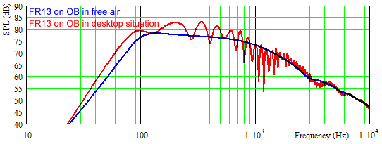

You must have gotten that wrong. If 24 inch is the back wall distance, there has to be a constructive addition at 142 Hz (with 24 inch the value of a quarter wavelength), followed by some comb filtering. See my result for 40 cm wall distance:Second plot is using a single driver in the tiny baffle of 20 cm wide x 30 cm tall set at 24 in from back wall as typical on a desk. There is so much cancellation of front and back wave that there is no bass. The freq response is just awful.
I don't see anything like this constructive/distructive interference in your picture.

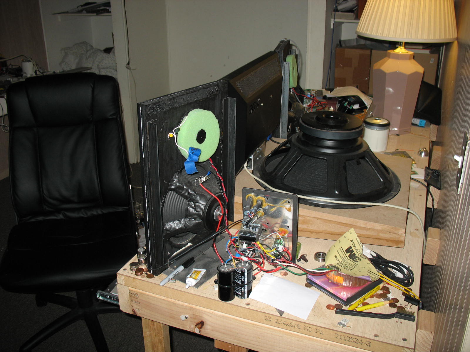

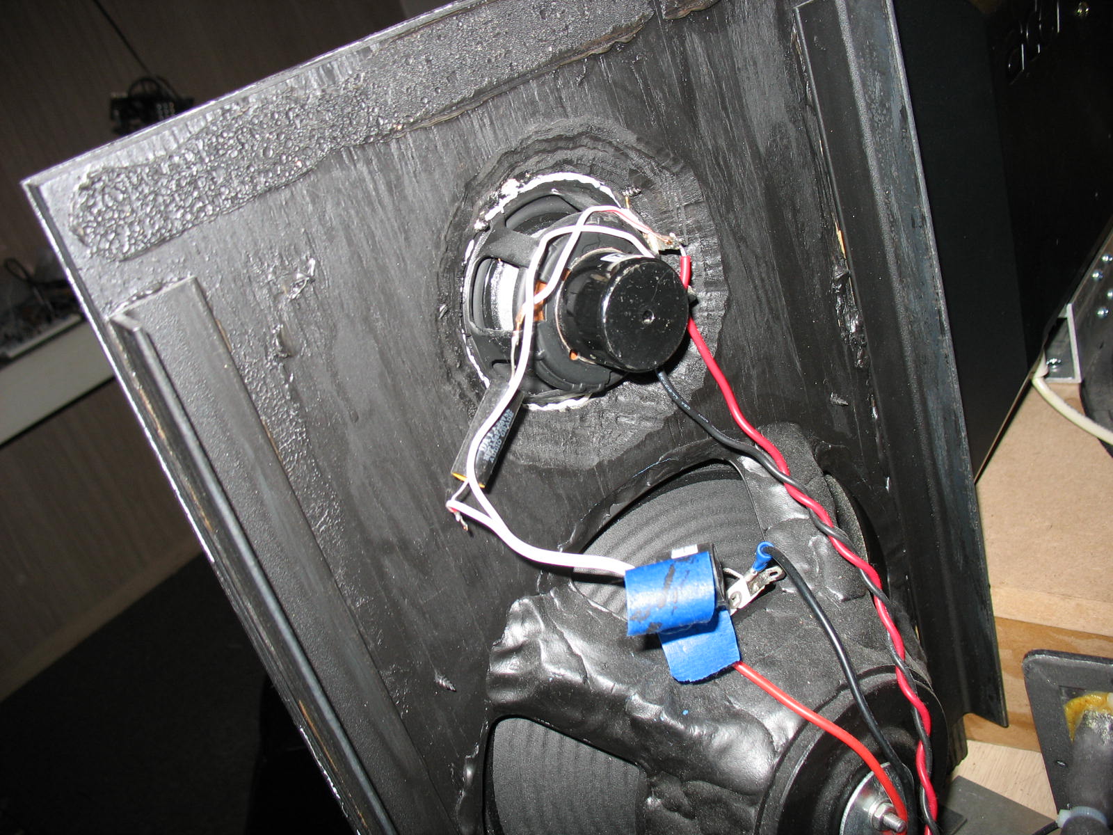

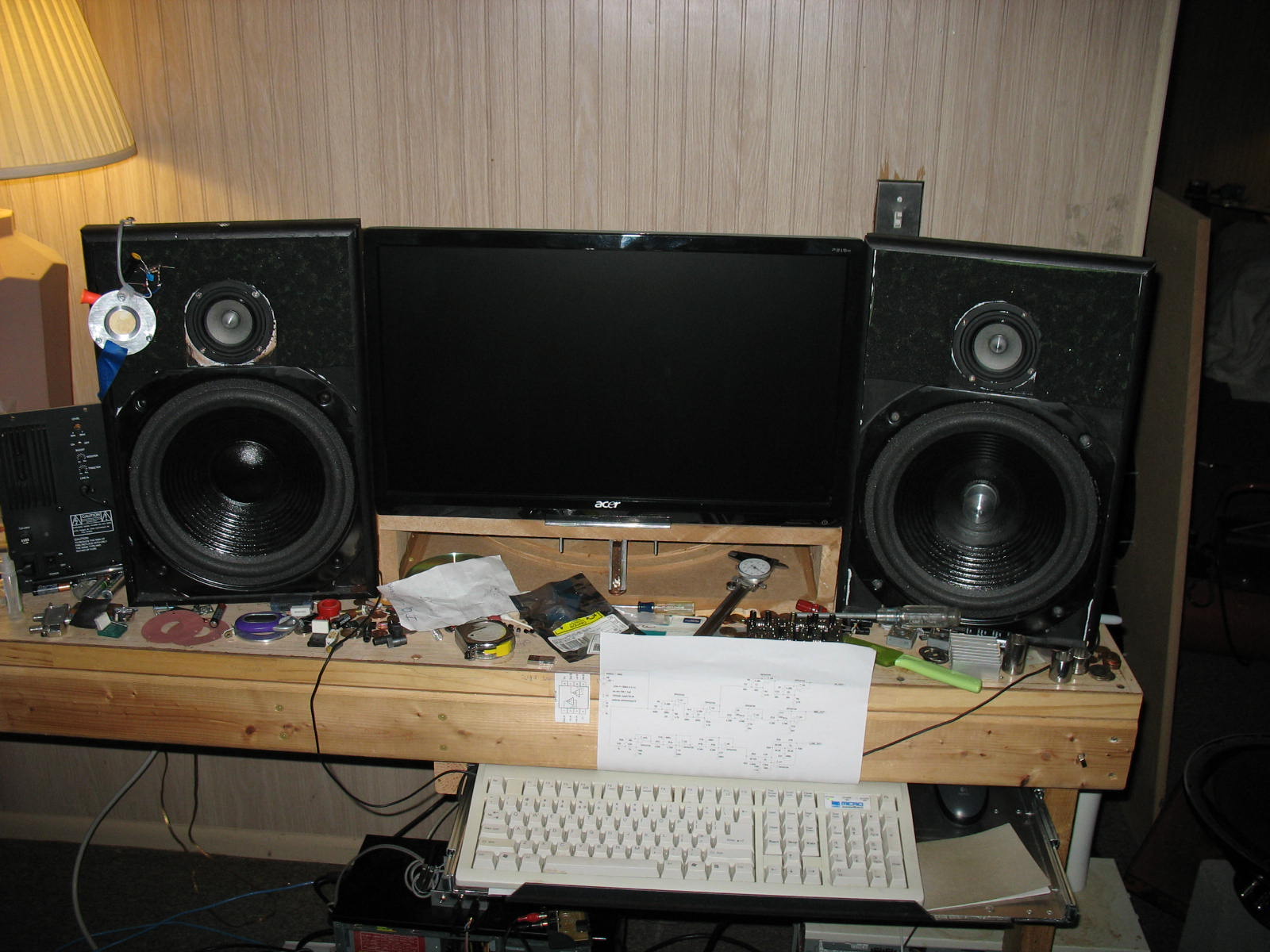

Okee dokie here are some pics. I hope no one was hoping for pretty. Some things just never make it out of testing, or take years.
Just a few notes:
Most of the time I sit about a half meter from the speakers. Drive comes from two (discontinued, I think) Dayton plate amps with 2 LM3886's each and have been Completely re-wired. It would have been easier to build from scratch but that wasn't apparent at the time of purchase.
When I started working on this application the biggest thing I was trying to avoid was the sound of a cheap bandpass box tuned to 60Hz and stuffed underneath a desk. I also didn't want two 3 cubic ft boxes on the bench. Obviously with the wall so close and me so close, big OB air just isn't going to happen. Actually I toyed with the idea of making a full enclosure for the fullrange, and may still try it. As I said, the best thing about these speakers is their bottom end extension and transient response. The big woofer under the monitor does ruin the latter. In addition to the corner desk test I did set this up on another desk location in the middle of a room. That sounded terrible too... So obviously YMMV with this stuff. I've never done any simulations or measurements on this system.

I do not know how Rudolf is able to achieve a frequency response that doesn't start to roll-off until 100 Hz with the FR13 as show here.
Doesn't seem to agree with the measurements by Linkwitz, or with my AkAbak sims which show falloff occurring in the range above 500 Hz. A flat response down to 100 Hz would normally require a closed box to isolate the back wave from cancelling with the front wave.

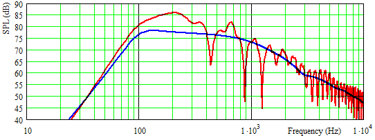

I gave a try at simulating an 8 in Peerless 830869 woofer in a 12.5 in wide x 3.5 in deep baffle, 24 in above the floor and 36 in from a back wall and here is what I get below. The black curve is the combined SPL and the red is the front wave from the direct radiator, the green is the back wave. There are a couple of dips due to the back wall and floor bounce cancellation effects, but the bass fall off starts occurring 400 to 500 Hz, consistent with Linkwitz measurements of 8 in woofer.
Am I missing something here?

But all the frequency response plots that I have seen so far, suggest that the bass starts falling off at 6 dB/oct from about 400 Hz for a very nice 8 in Scanspeak 21W/8554 Kevlar driver in a 12.5 in wide baffle....
Ah, the light goes on. I repeat: Desktop OB is an oxymoron.
