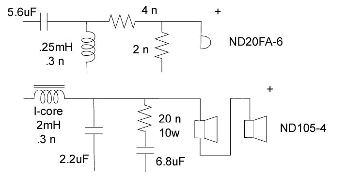

2nd order, zobel on the woofers, L-Pad on the tweeters 3.3 kHz XO
report back when you are finished. And pictures.

One day I'm going to be able to know exactly what that all means, but right now, you might as well be speaking in french. all I understood was 3.3khz crossover, lol.
I suppose I should read up on what all those orders mean.
1st, 2nd, 3rd, 4th orders are crossover slopes, 6dB per octave, per order. So a 4th order is 24dB per octave.
A ZOBEL is an impedance compensation network. Typically a drivers impedance rises with increasing frequency due to voice coil inductance, so a ZOBEL makes the circuit appear resistive instead of reactive.
An L-pad is two resistors in the shape of an "L" used to attenuate (lower the volume). Most often used on a tweeter. You could attenuate with only one resistor, but the second resistor holds the circuit impedance down to a desired level.
Thanks for the explanations. I'm having quite a bit of fun learning about all of this.

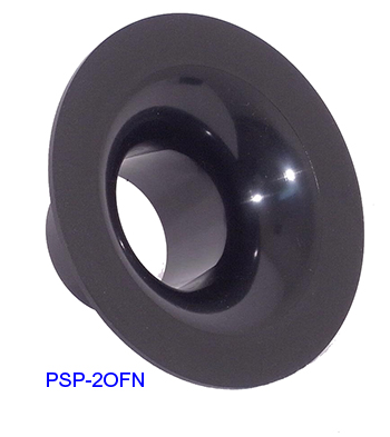

Only 1 thing : the flares behind speaker baskets should be 45° truncated cone ,not rounded .
Thanks! Unfortunately, those rounded flares were the only option for me. I am already over-budget for this build with having to buy the router bits. The trimming and roundover bits together were $38. Perhaps when I build a set for myself I might be able to pick up a 45 degree bit, but at this point its not an option for me. I imagine the roundover should work still work fairly well though. The roundovers are actually 1/8" recessed into the board as well.
Just use a file. You can get a flatter cone that way. But I'm sure it will be alright anyway of you sealed them up.
