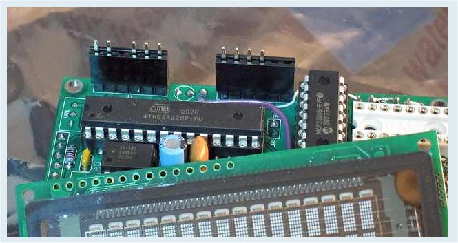

Jeff , there is a lot of advanced pga32xx material here -
http://www.diyaudio.com/forums/analog-line-level/167977-volume-remote-control-module-pga-2311-a-3.html
Looks like linuxworks made your comment , Jeff (post 7).
Also looks like he went commercial with his atmega328 LCD module (below)
it is "gone".
All the other "line level" people are just "beatching" about the chinese junk.
Only a few designers (that keep it all to themselves).
We NEED to design an "open source version".
Edit - I was wrong - source and circuit is there ...
http://www.amb.org/audio/lcduino1/
