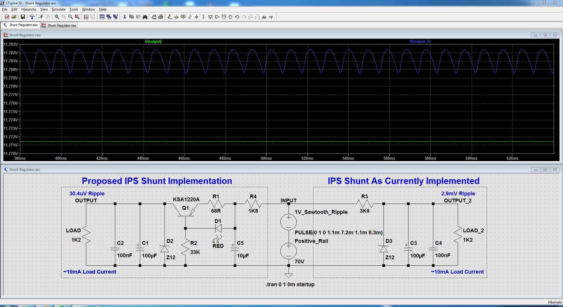

I finally got a chance to look at your schematics. Nice work! I'd like to do something this elaborate eventually for my theater system but with room correction. HDMI switching and decoding would be good too. Right now I've got a Yamaha RX-V2700 cooking my equipment closet. It needs more power and less heat.
Thinking too much, maybe?
Just a thought, bear with me for a moment...
One of the things about the IPS sections that have shunt regulated circuitry that I always thought could be improved just a little is to eliminate the need for a builder to calculate / experimentally derive the dropper resistor value to ensure proper function. At the expense of some minor added complexity, not even in the direct audio chain, we could completely remove the power supply magnitude dependence. Any thoughts on integrating something like the following:
Using a CCS to feed the shunt regulator that is set to pass an appropriate current to make the design effectively adjustment-free. That way the shuntie always works as intended, without regard for supply voltage (within reason).
I only suggest such a thing because there have been a few instances of needing to do some troubleshooting solely because the shunt regulator wasn't working due to too high a dropper resistor value being used (or conversely testing with too low a power supply voltage). Sometimes folks don't realize that the values typically published for the SlewMaster are usually optimized for about +/-70V rails and operating at lower voltages may require different dropper resistor values.
Any thoughts? Superfluous complexity or potential boon for 'first time, every time' function? I have a tendency like anything that 'takes care of itself' where possible. It does remove even more ripple / garbage off the rails as another bonus. The basic shunt reduces ripple -51dB and the CCS shunt is -72dB, and the CCS shunt with voltage dropping pre-filter is -90dB (simulated results). Of course, we are already following a capacitance multiplier on the OPS so this may just be gilding the lily, but I thought I'd throw it out there.
No , not a bad idea. I actually considered a more complex shunt.
But then , imagine the spooky with 10% more components. This was my
quandary. I opted for the oversized 3.3K.
Your idea might solve the only small issue with some of the symmetrical
IPS's. What happens on shutdown ?
12V zener rails shut down first ... this does mute the ips (no squeal) ,
but the VAS goes high Z , and there is no servo control. The OPS
will usually "pick" a rail to discharge - making for a small thump.
On the other hand , having the input powered on shutdown (your "fix")
might allow the amp to show it's "voltage dependent phase margin errata".
Just "food for thought"....
OS
