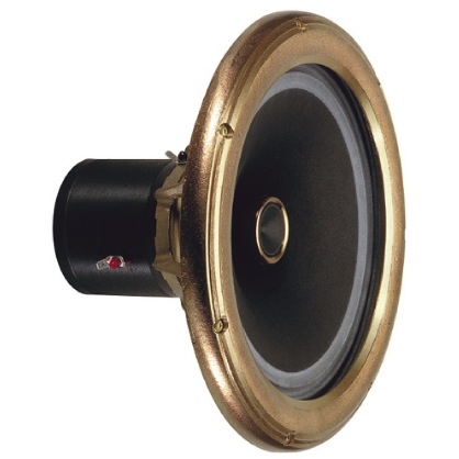

In the center hand made large open baffles : PHY/ HP wide range drivers ,
PHY/HP

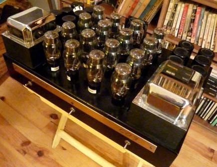

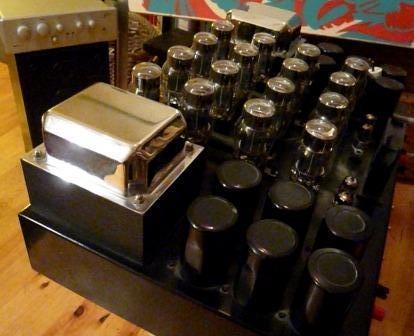

Audiomat OTL tube amplifier Output Transformer Less ,passive pre, with CEC transport and DAC.
Music has such intense emotions!!
Amplifier topology was oposite to SIT Némésis with 16 tubes for stereo and not output signal transformers.

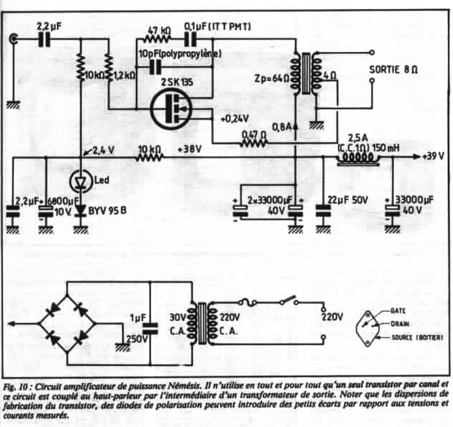

Try 32-ohm pri, 8-ohm sec, B+=80V, Id = 1.1A .2% @ 1W if the sim is to be believed.
hi michael , i will probably have a pair of Tango FG50S to try in place of the CCS on my THF51S Lamp i have a 60V B+ any idea for the Bias Id with this config ?
THF51S Nemesis Tango FG50s , ugly , heavy but what a sound !
32ohm primary 60V 1.5A no fear
Nice juanitox. How hot does your heatsink get?
just warm 45°C against 58°C with the CCS

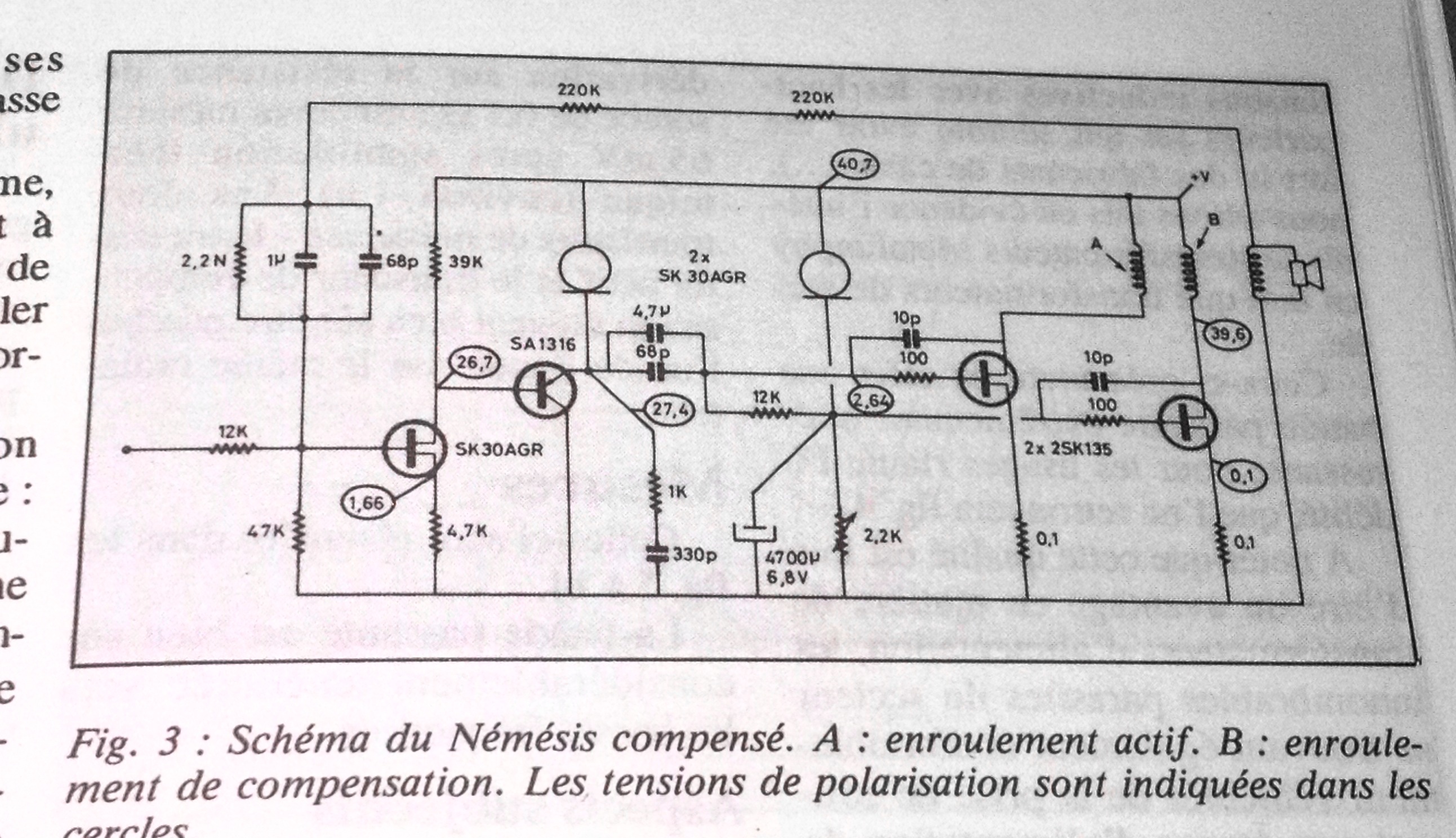

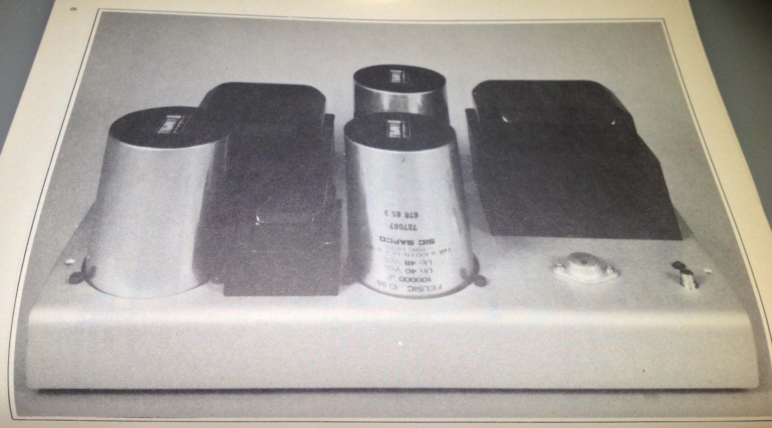

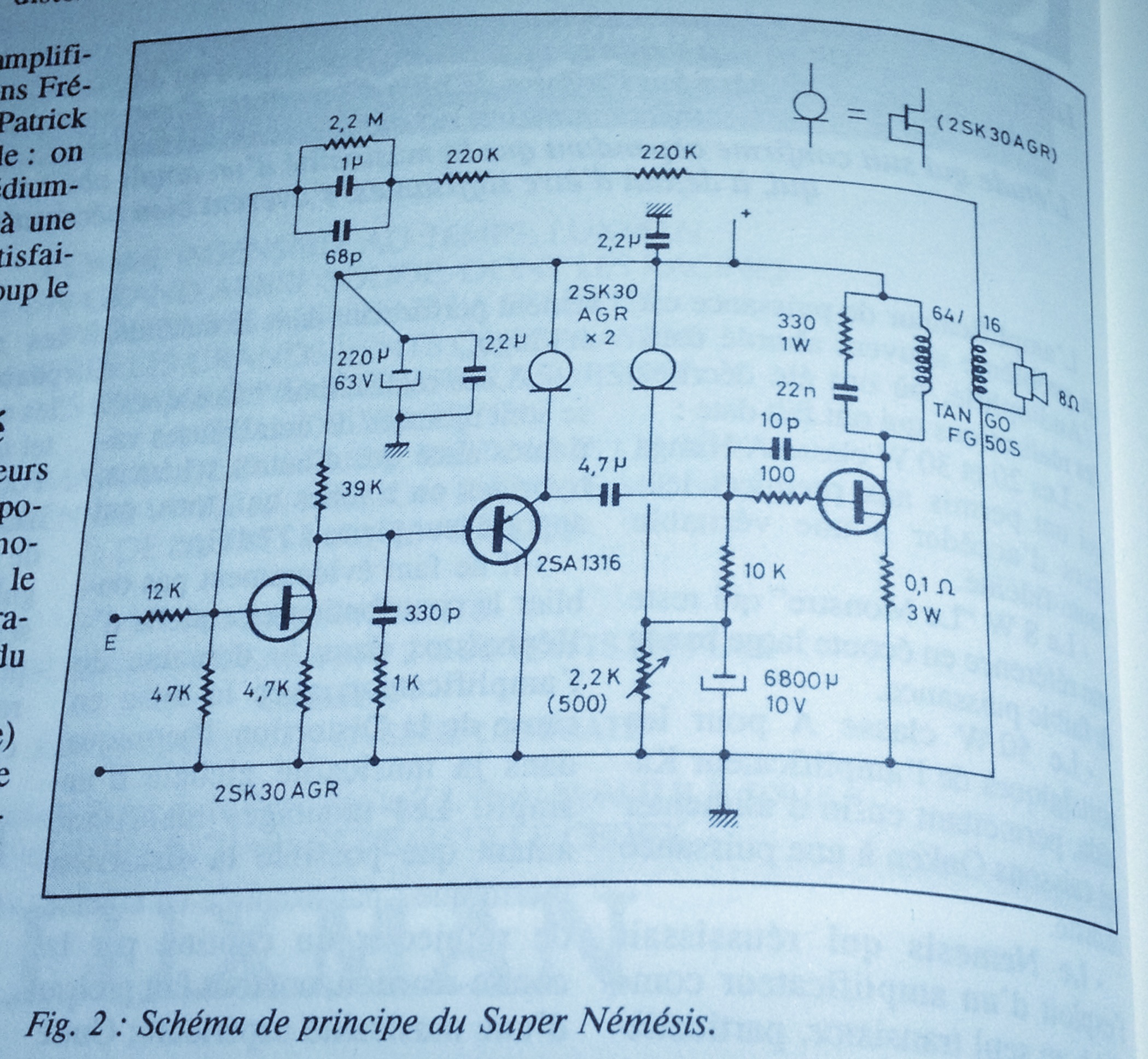

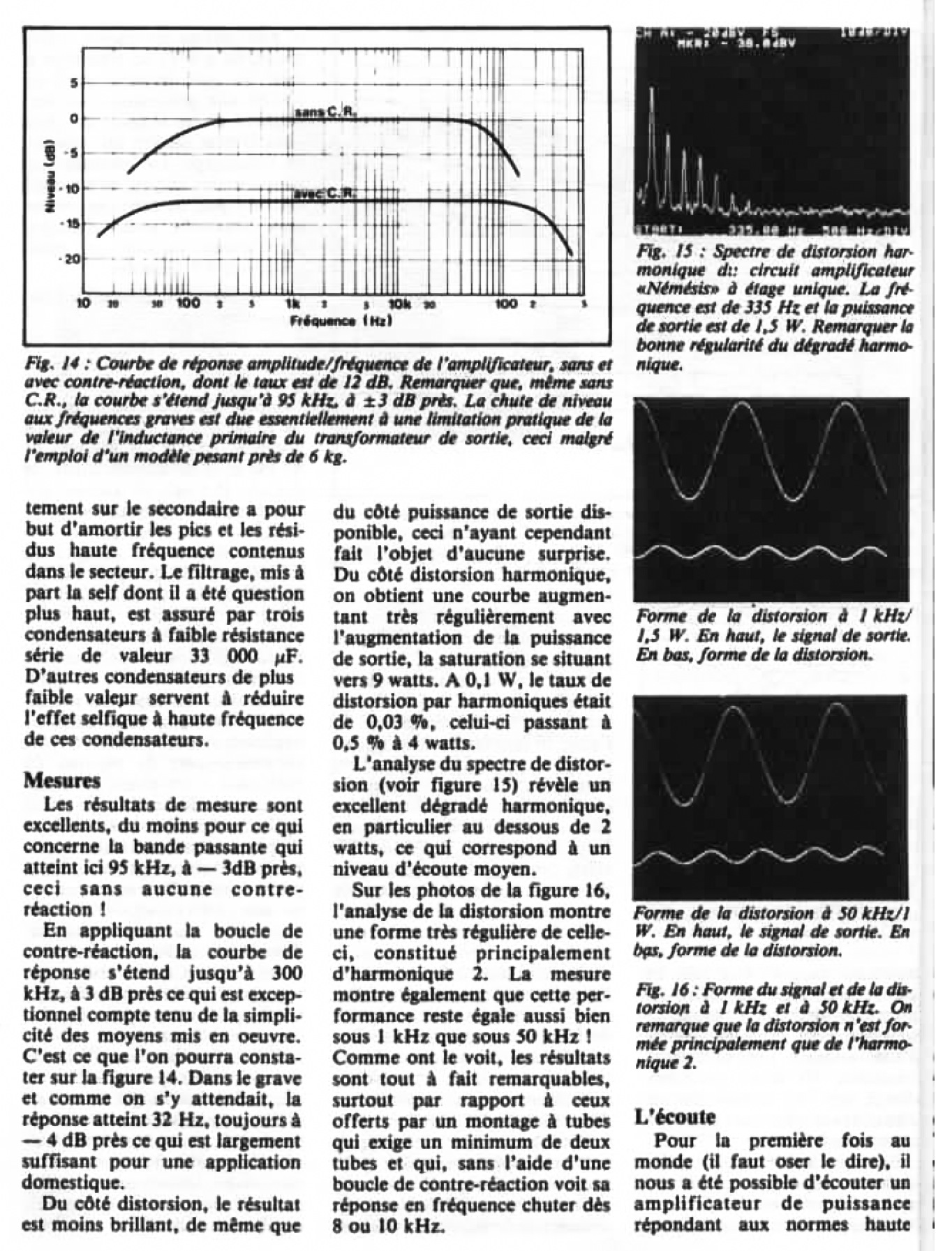

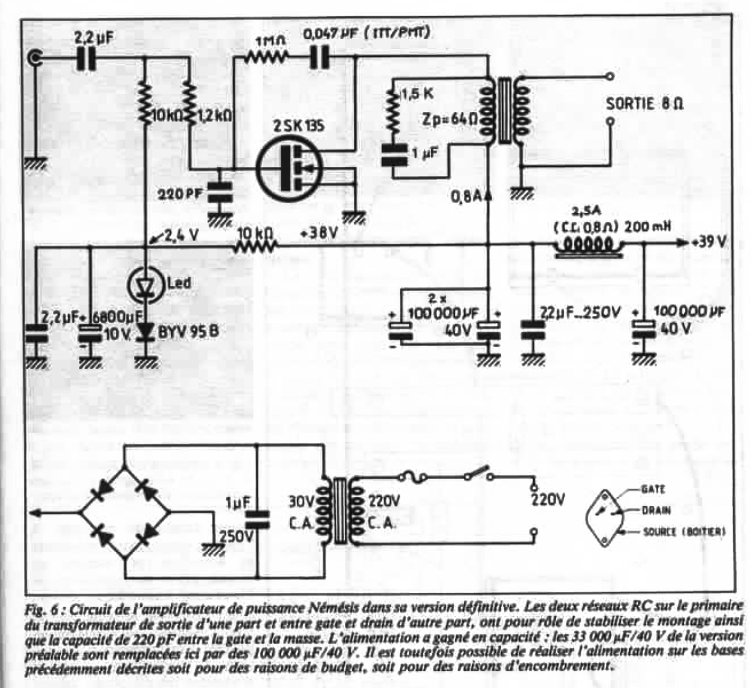

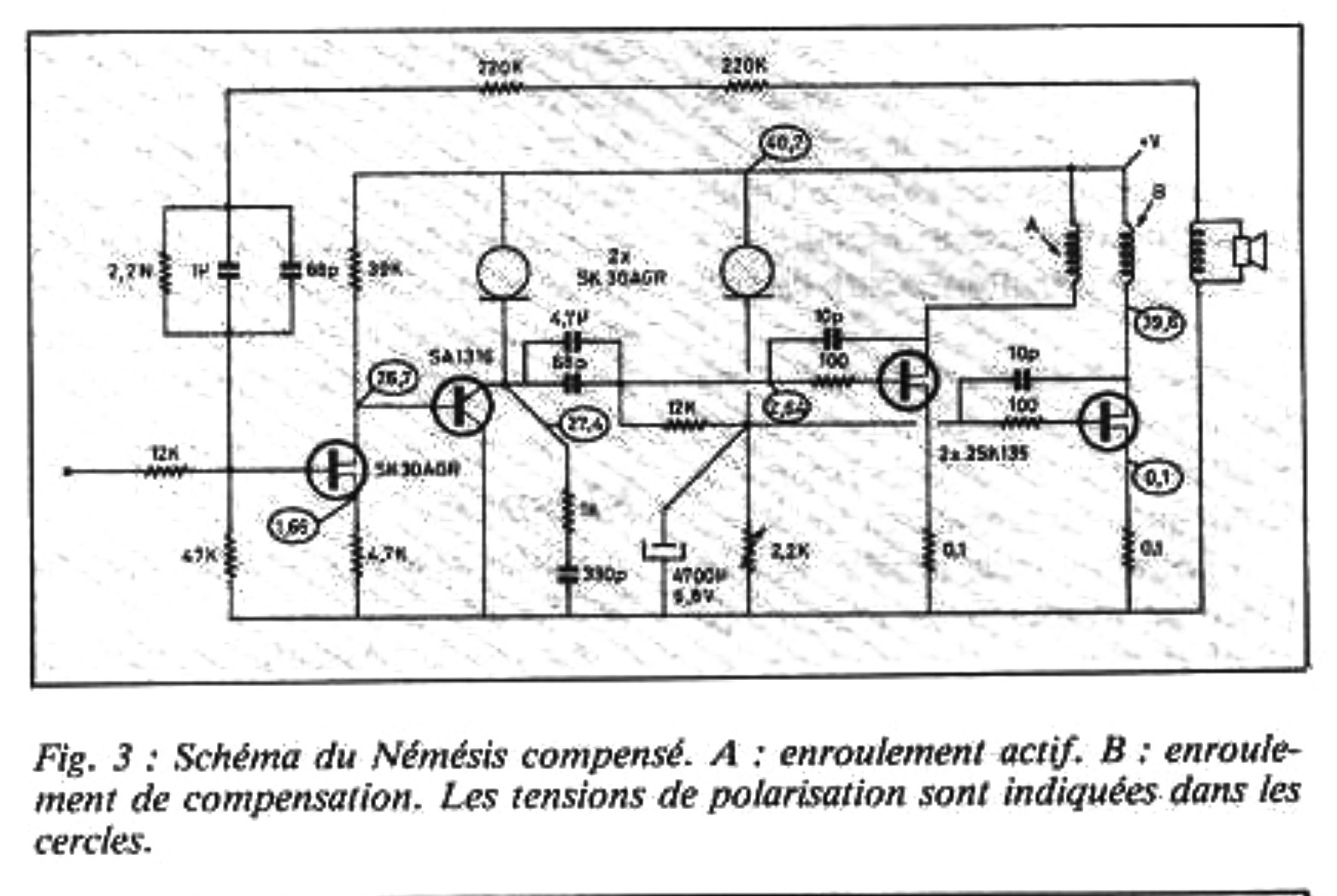

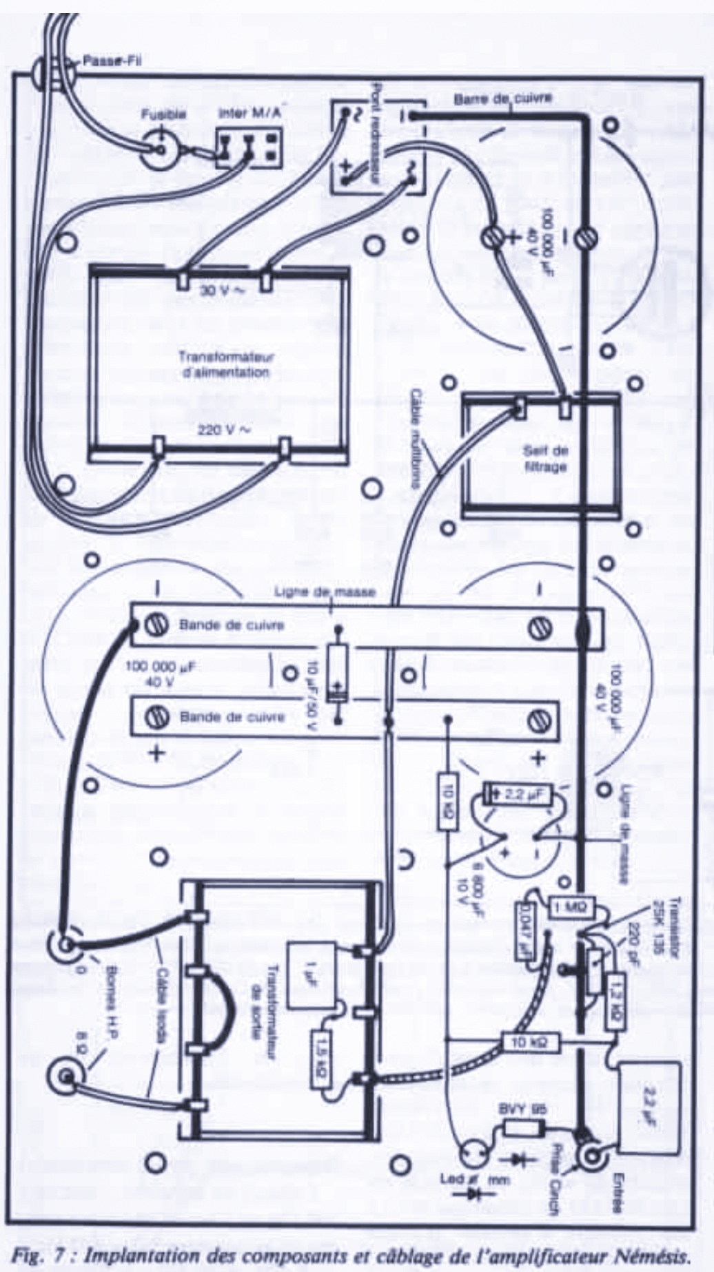

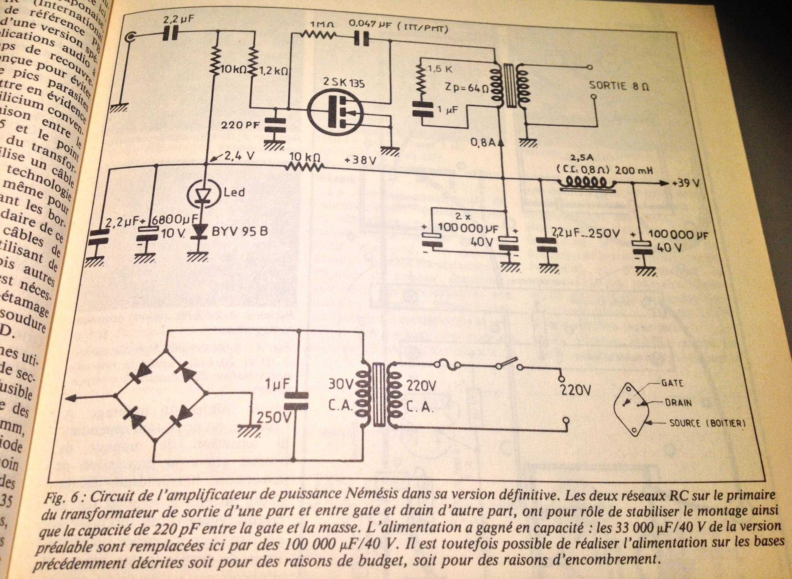

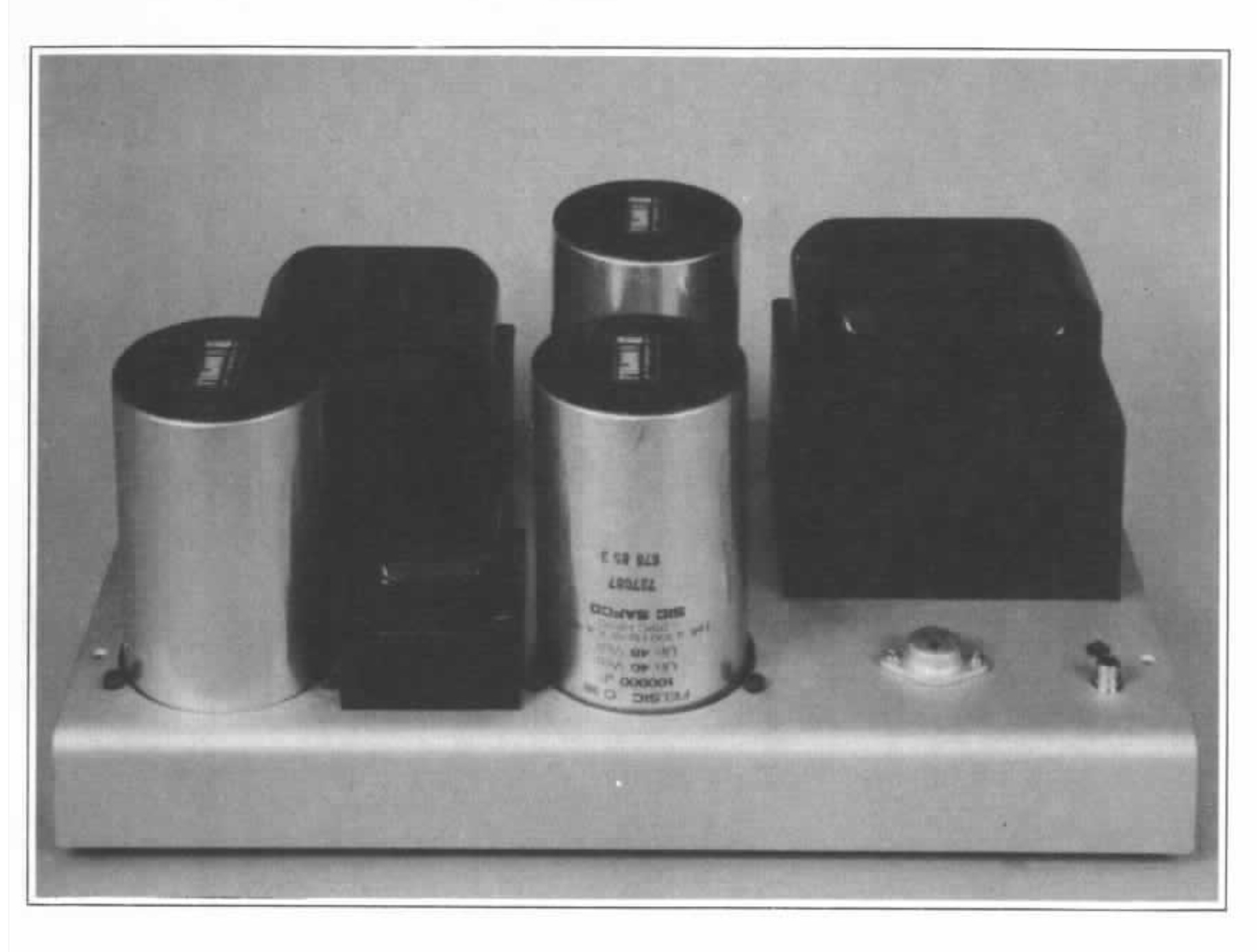

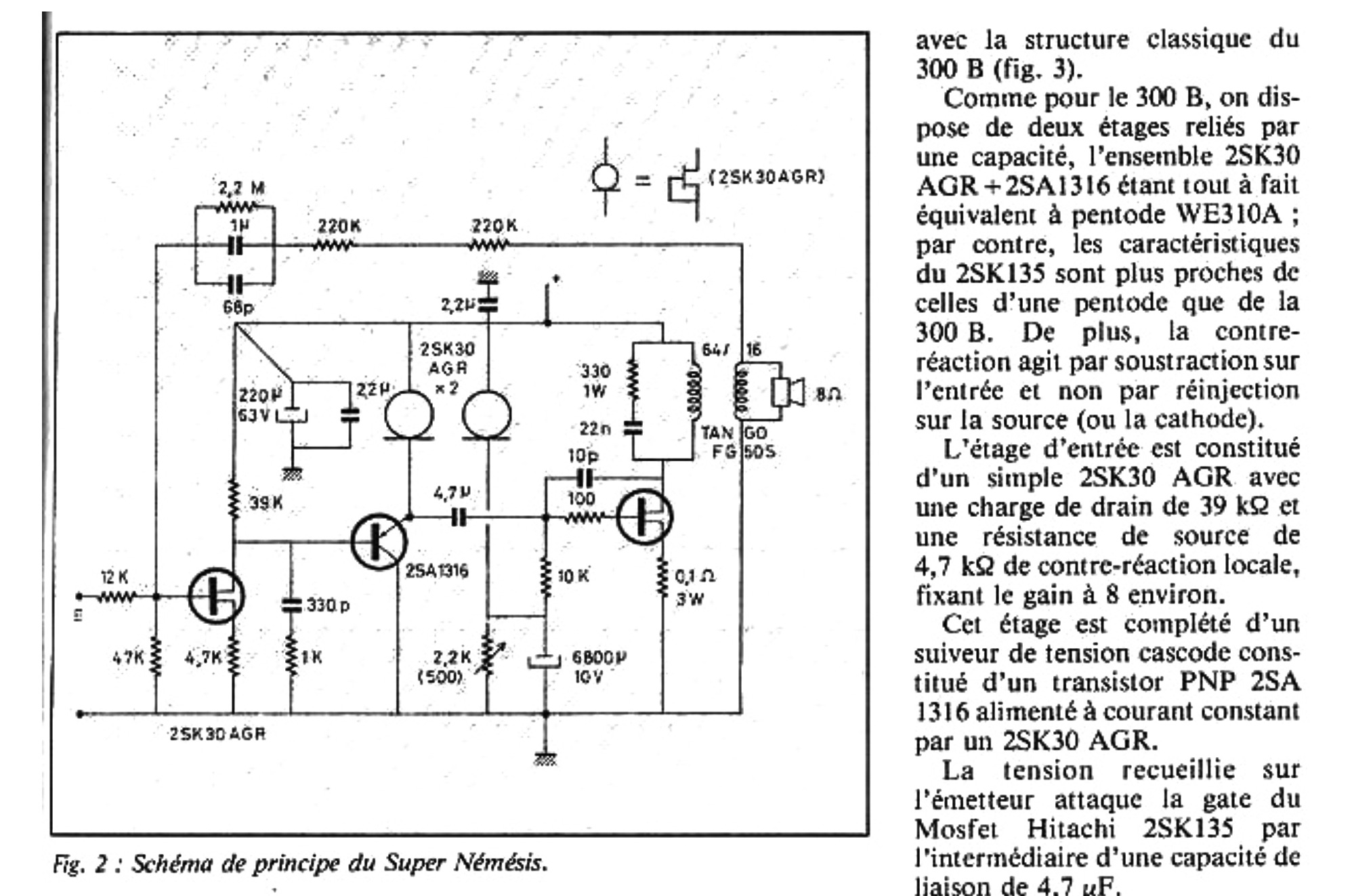

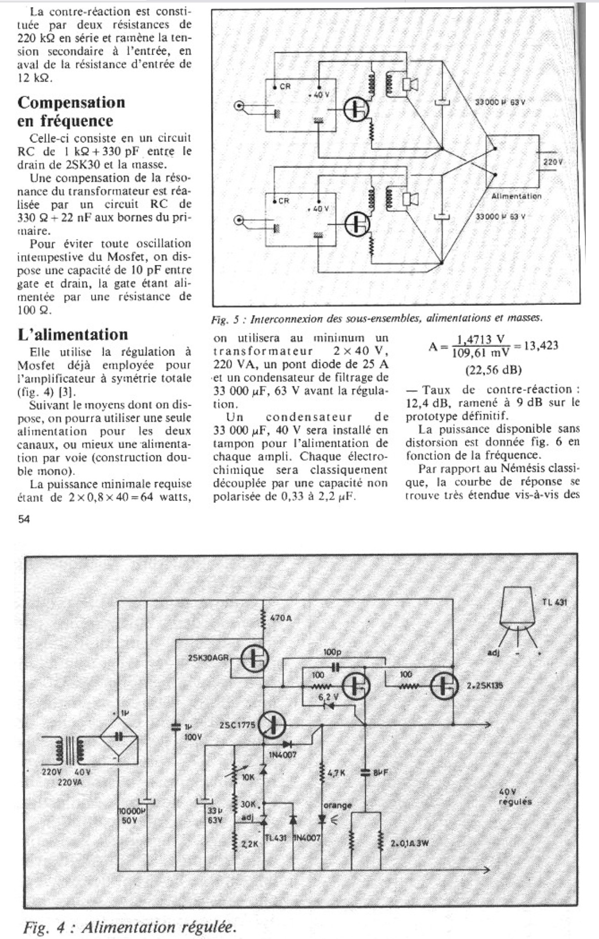

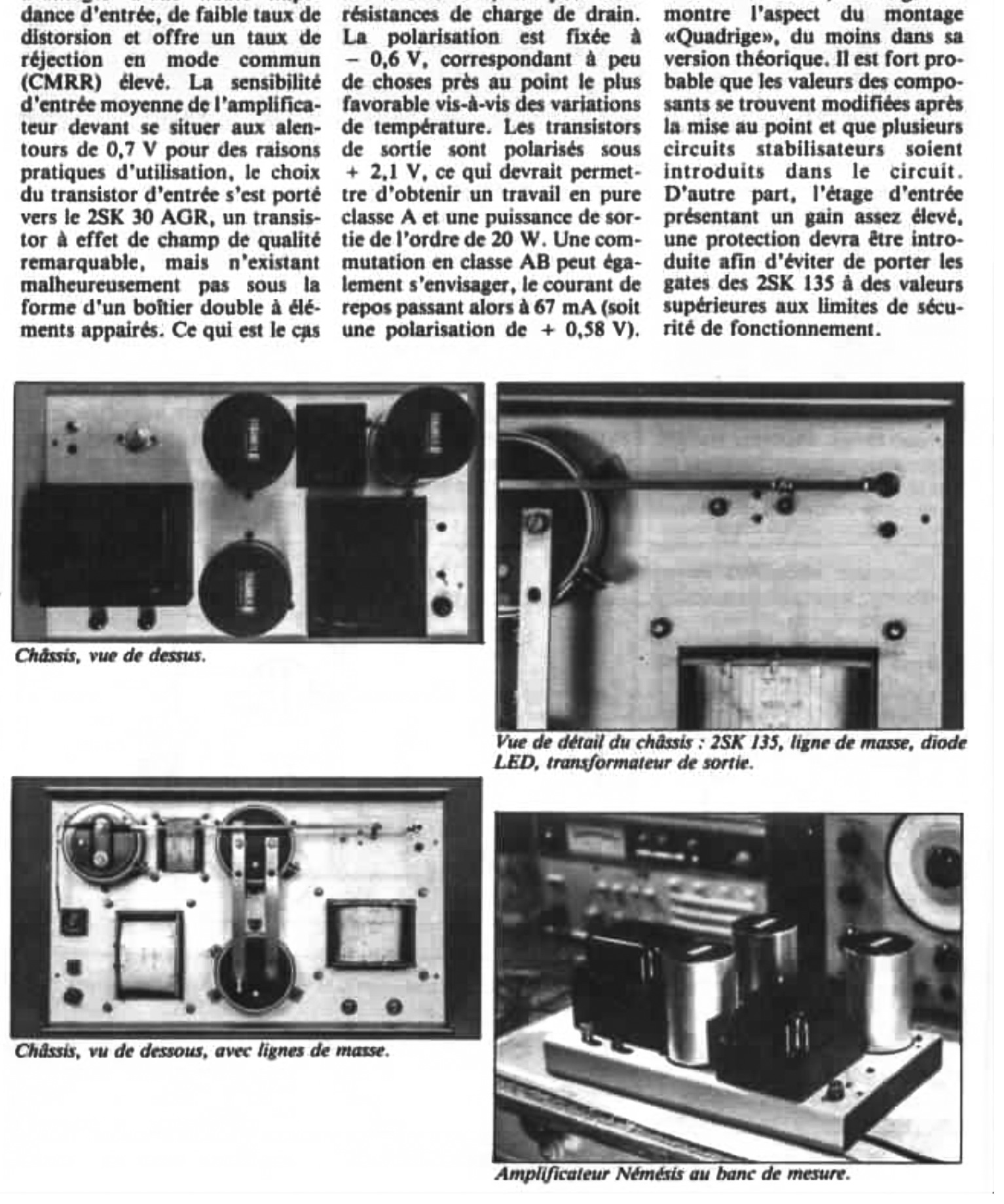

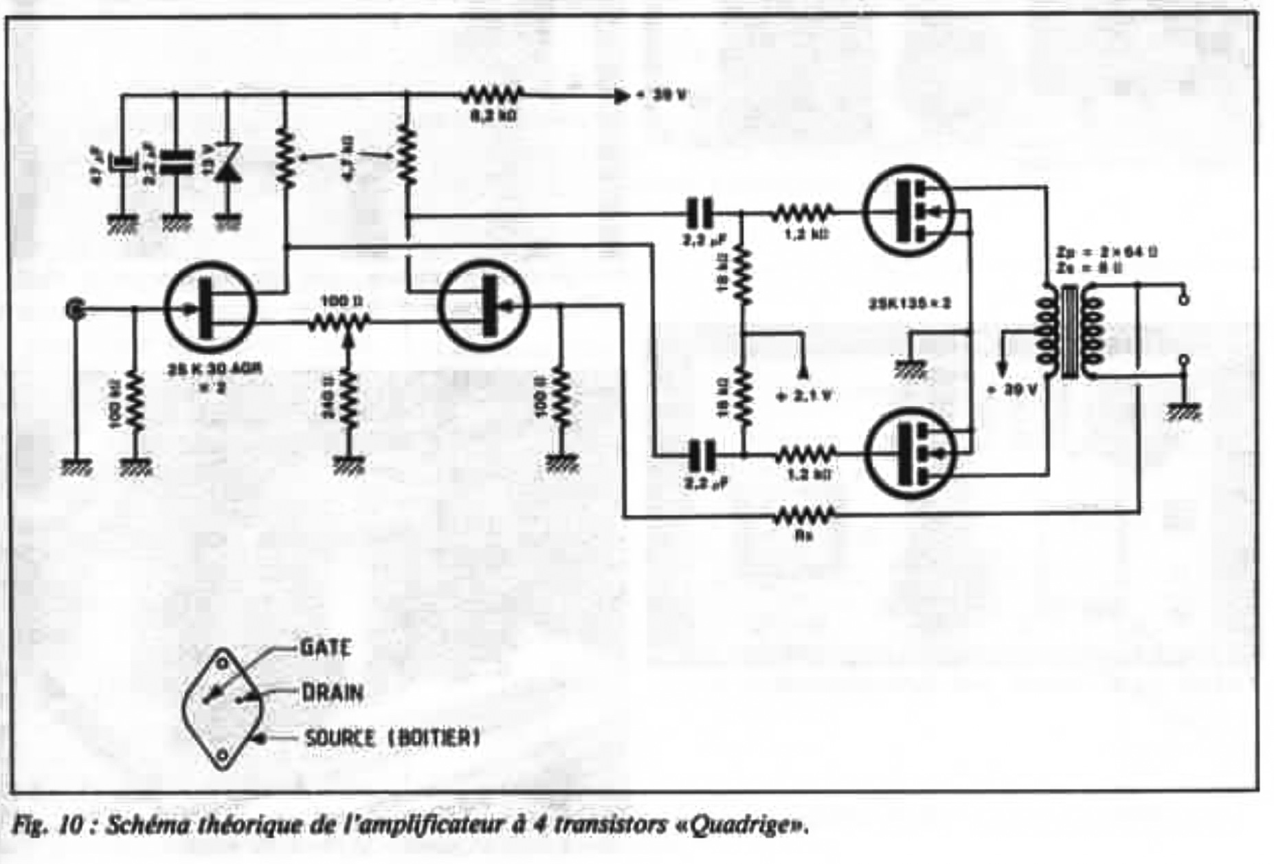

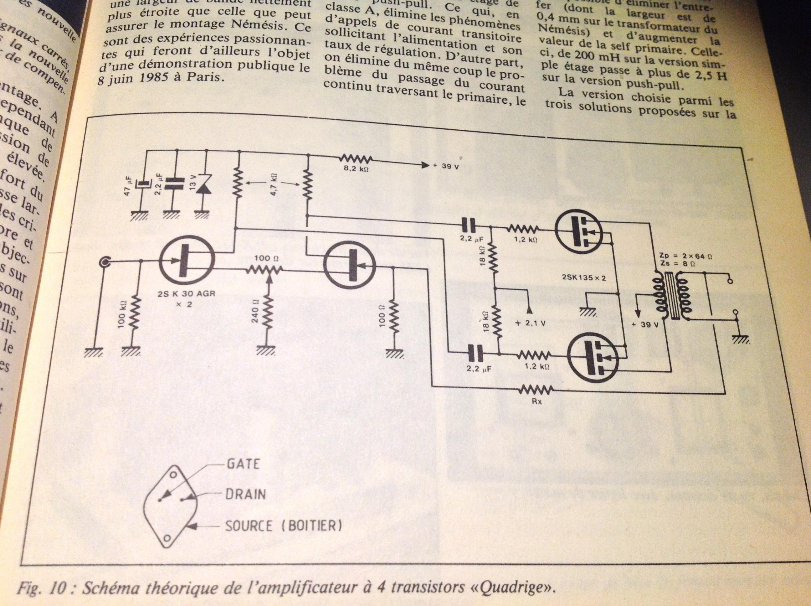

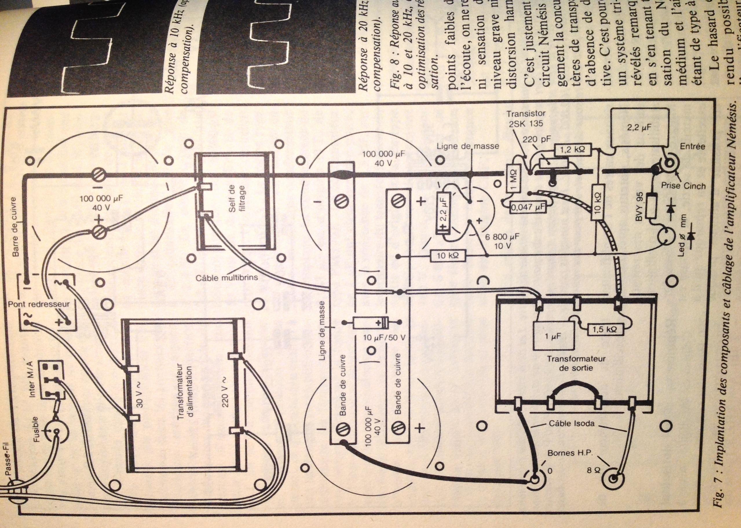

Response to member Sergiu2009 request of Némésis schematics
This one is from first "L'Audiophile" article and frequency response without and with the feedback, distortion etc.
Photo Nr 3 is a definitive version then push-pull version "Quadrige"

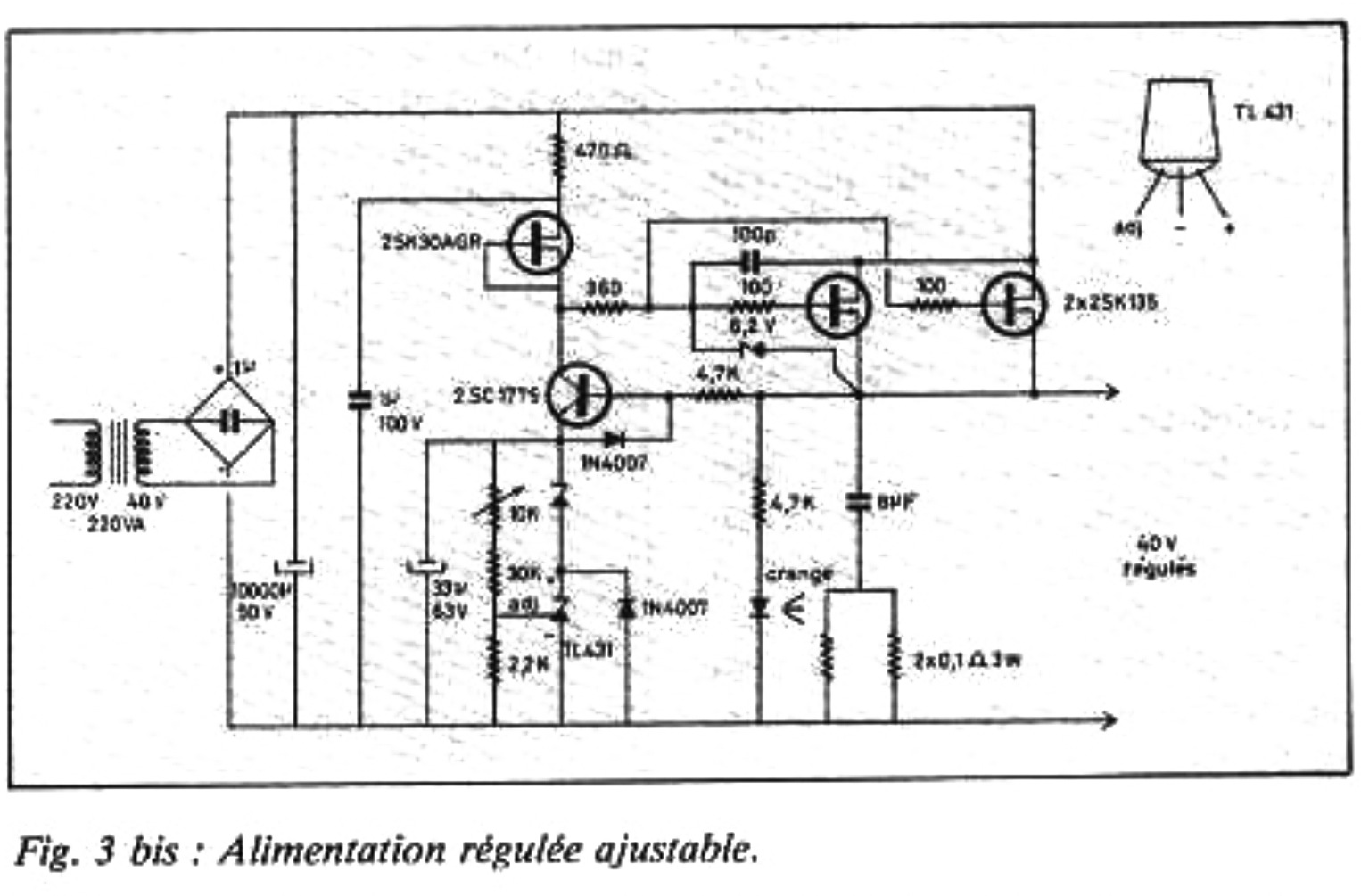

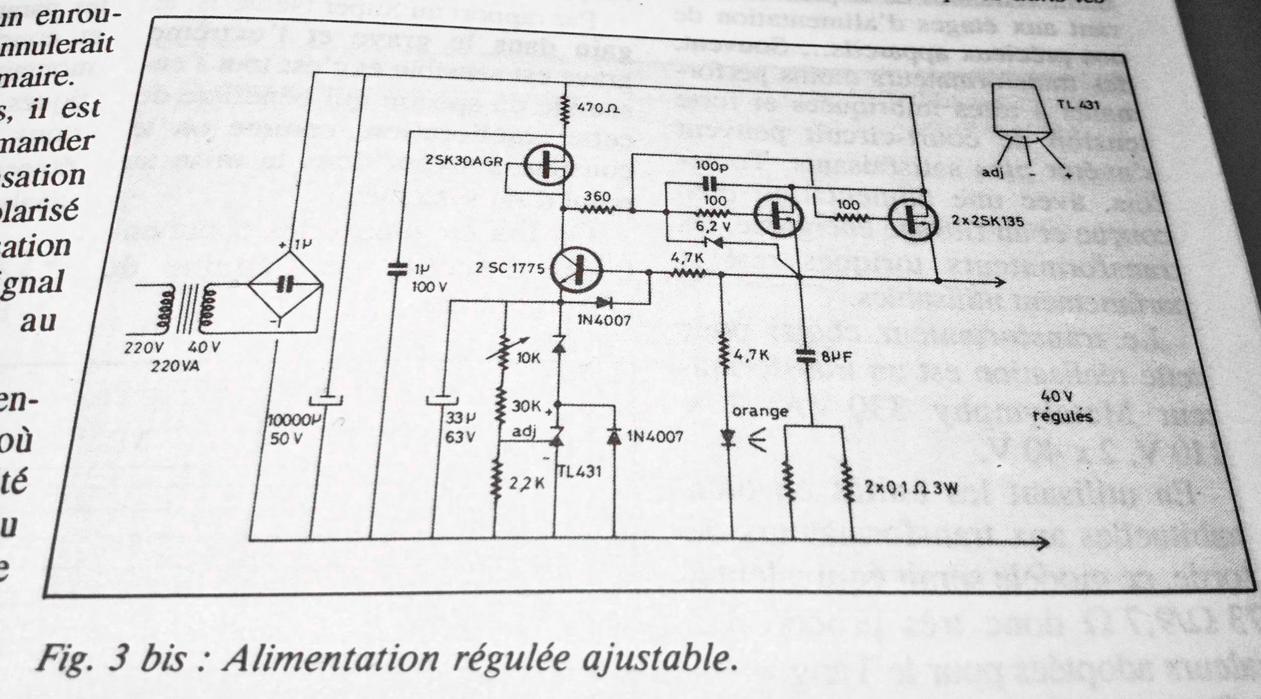

"Super Nèmesis" and " Compensated " with regulated power supply.
Photos made on my bench this night, better schematics quality from original "L'Audiophile" paper version

Construction notes :
Super Némésis | 2.2 KOhms multiturns trimmer for low distortion adjustement, current 0.8 A for voltage mesurement on the 0.1 Ohm of the 2SK135 source resistor = 80 mV
Compensated Némésis | adjustement on Vr 1 trimmer around 0.1 Ohm source resistor find 650 mA = 65 mV take after 1 hour temperature stabilisation
Compensated version output transformer are 330 watt's power toroid with 2x 110 V primaires ~ 73 Ohms 2x (A) (B)
and 1x 40 V secondaire ~ 9.7 Ohms
No need for exotica high cost output transformer ex: Tango
Mr. Hiraga write compensated version are most equal on all frequencies ( much better low bass )
Classic Némesis or Super are destinated for bi amplified audio wonders Greetings
