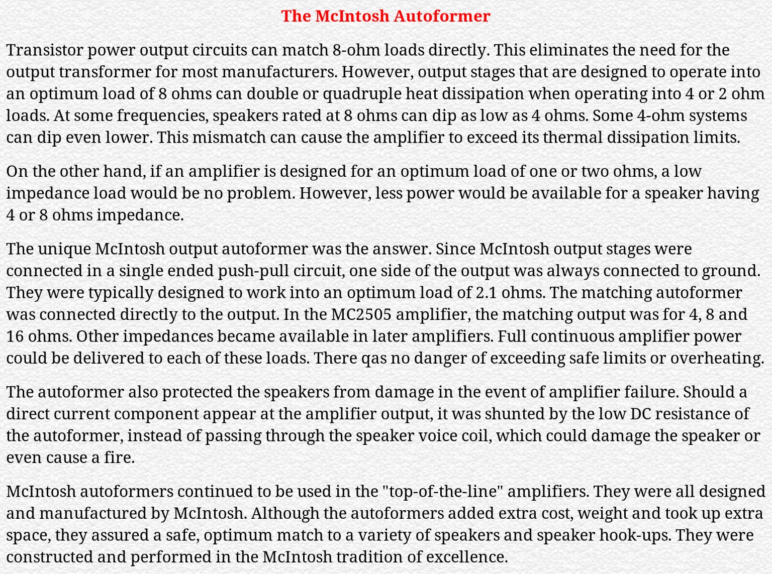

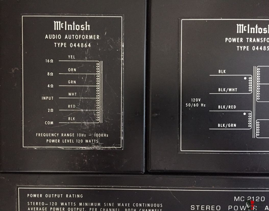

McIntosh , as example - many of them having autoformer at output , still sounding as powerful mediocre Drek

Looks like autoformer at the amp output was not totally explored by talented Wizards
I think the idea was for OTL amps but you could just capacitively couple it.

I agree - when amp is made for having them implemented , it can be gorgeous .... same as any other well constructed one
though , I'm simply dismissing idea of Divine Intervention , just because some gadget is having autoformer on output , or just because some Tin Box is having flashy name on it

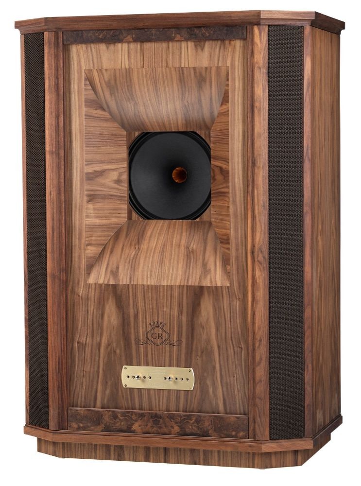

Was Tannoy Westminster Royal + push pull tube amplifier + EAR Yoshino CD player.
