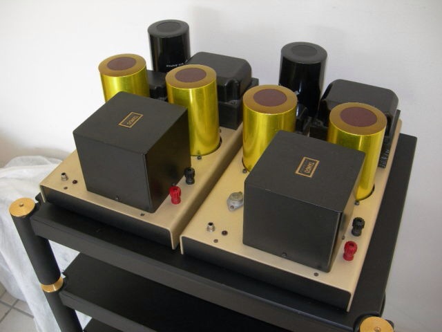

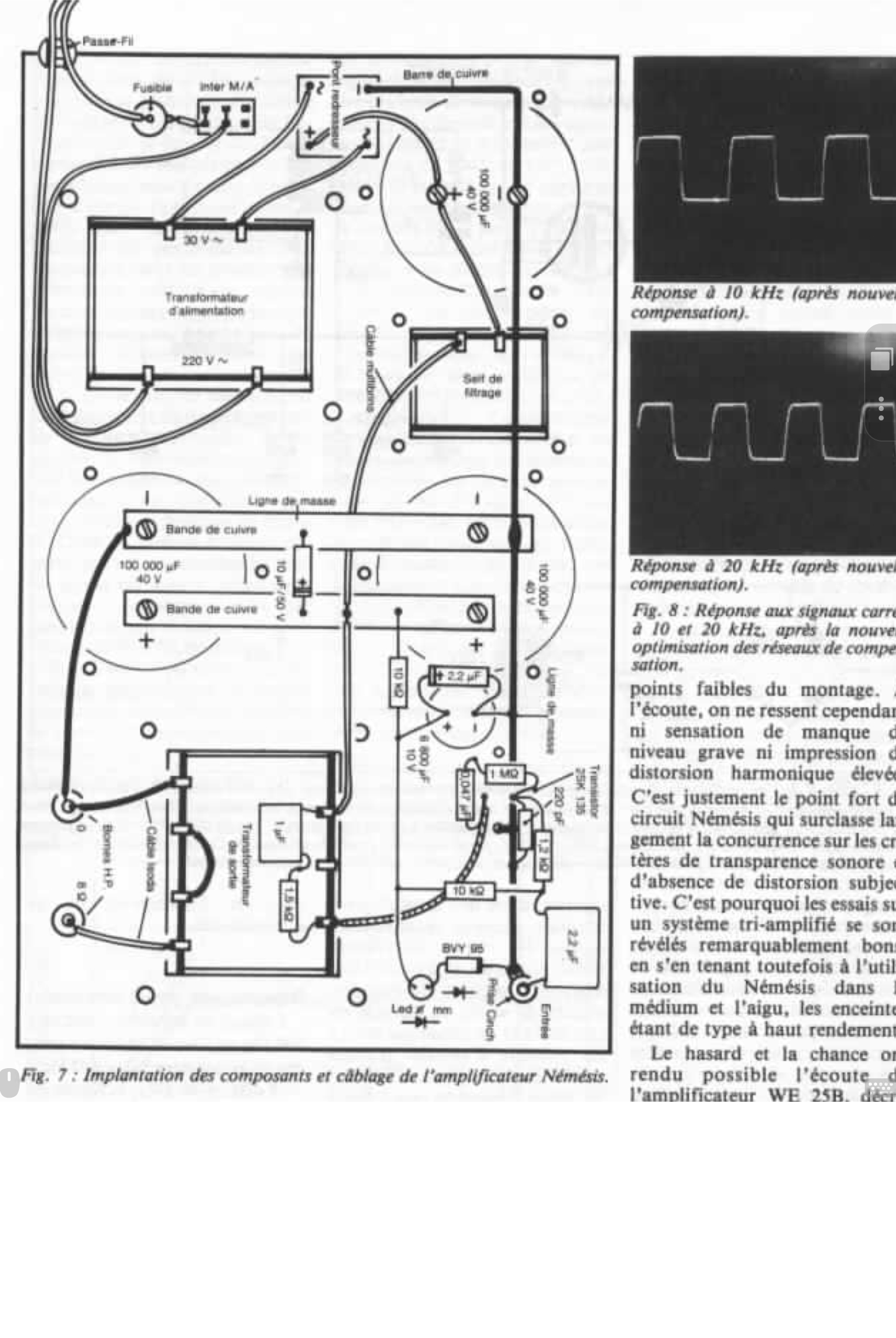

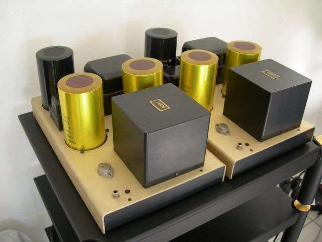

Hello Eduard & Nagini
Photos show just for historical ( not my amps ) and hope inspiring in new builds.
Transistor attached to chassis was the only "heat sink" used and all was make with point-to-point technique.
Jean Hiraga bring them from Japan to France for sell few kit's in 80's " old good days".
Némésis is ancient Greek Divinity name , interesting to know who she are.
Best regards

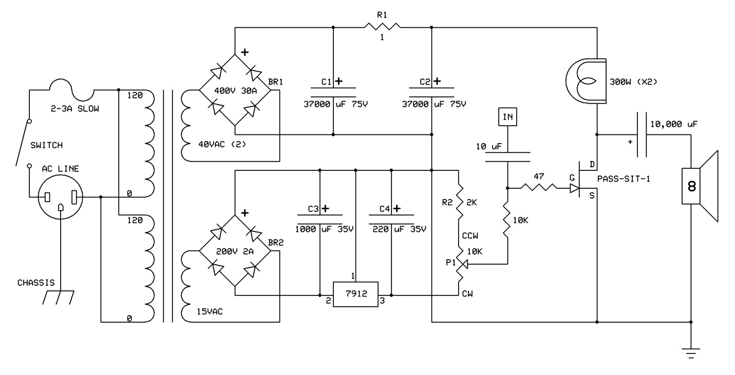

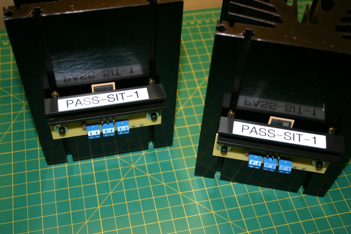

Treasure Pass Sit-1 that need smart Mr Rothacher heat sink solution with screws adapters so Nagini can play more fun game
and compare sound from other topologys as well maybe ?
Thanks photos courtesy by Audiohobby.com

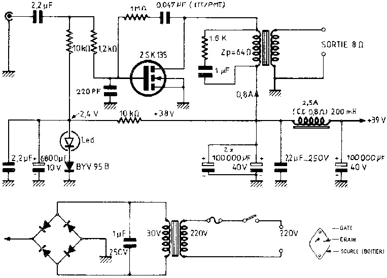

@soundhappy: thanks for your ideas! I was think I will build the PASS SIT 1 transistors with output capacitors (try to find Rubycon Black Gate 10000uF or Audio Note KaiSei 10000uF/63VDC) but now I have FG-50S so I will build SIT Nemesis:p
I will choose the best parts for this amp:
+ Plitron transformer, Audio Note KaiSei capacitor, Lundahl choke and Cree SiC rectifier in the power supply.
+ I apply ZEN V3 active regulation too:rolleyes:
+ Replace input capacitor with 600:600 input transformer:cool:
Thanks soundhappy! I built Arch Nemesis and Ironamp, both have a very good sound and I know the quality of parts are very important so I will get best parts for this amp.
The name Ironamp became cause: input transformer, VFET TO-3 case and output transformer. The PASS SIT 1 with TO-247 case so I think it's just some modify from origin SIT Nemesis for better sound because I have no best input capacitor. My target for input transformer is Tango NN-6 or NN-600-600 with Permalloy core:p
