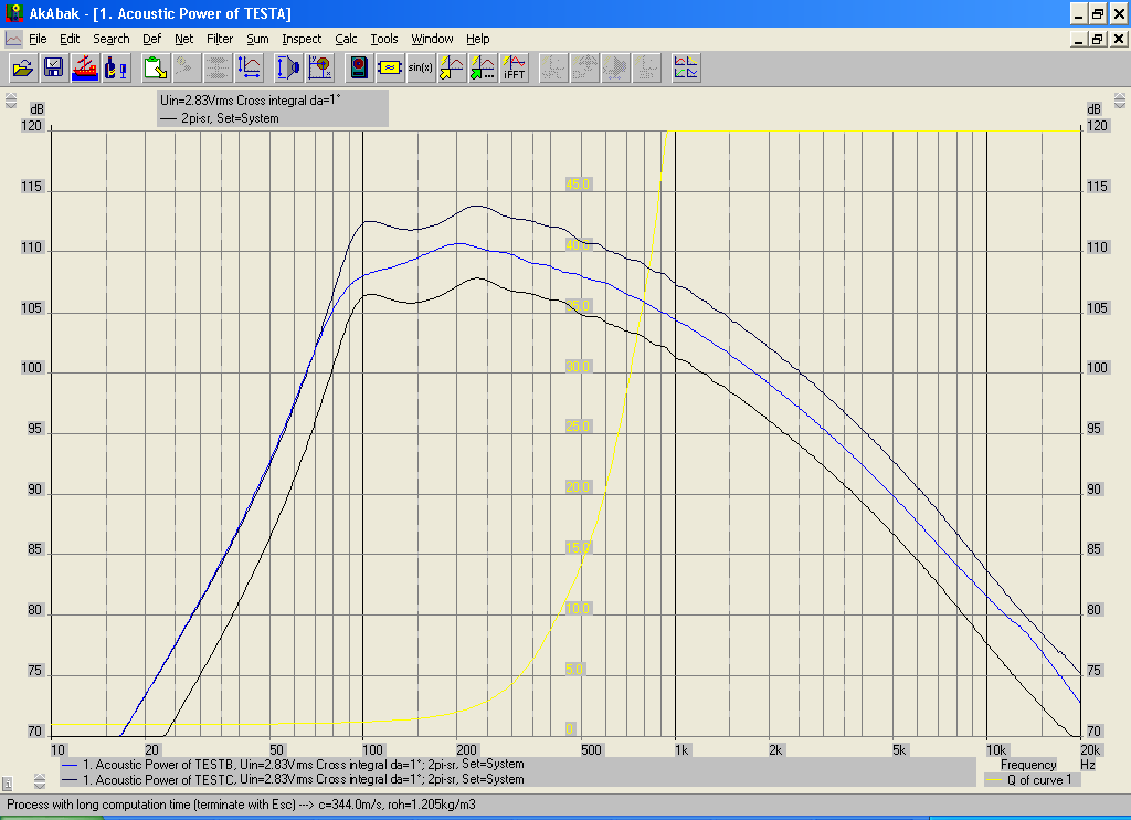

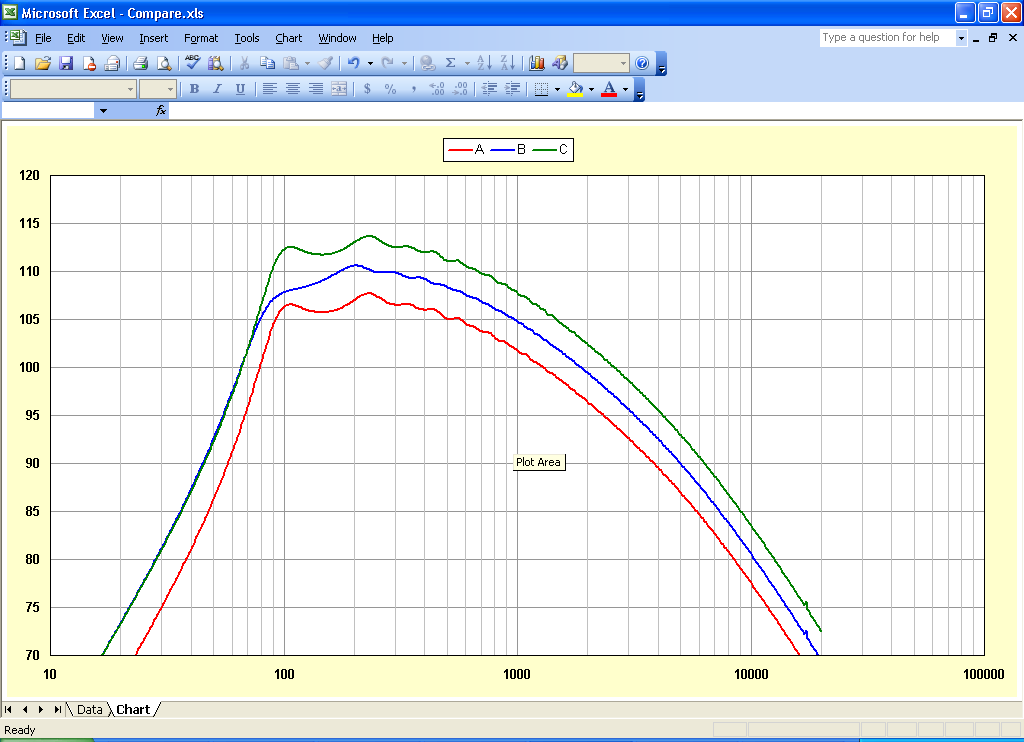

Hi Everyone,
The first screenprint shows Hornresp results generated using the proposed new Multiple Speakers tool. The data has been exported to Excel for comparison purposes.
The second screenprint shows the equivalent AkAbak results. The two sets of results are essentially identical. There are slight differences above 10000 hertz, but these are of little practical significance.
Hornresp results:
The red trace shows the reponse for a single conical horn with a single driver, radiating into 2 Pi space.
The blue trace shows the response for a single conical horn, similar to the one used to generate the red trace, but with two drivers connected in parallel and the cross-sectional areas doubled, also radiating into 2 Pi space.
The green trace shows the response for two conical horns, each similar to the one used to generate the red trace, but connected in parallel and also radiating into 2 Pi space.
It would seem that the green trace results are similar to the measured results obtained by Art and Wayne.
The really interesting thing though, is that the level of the green trace is approximately +3 dB compared to the blue trace at higher frequencies, when it would seem that the two systems are effectively acoustically identical - the blue trace being generated using two drivers in a single horn having a mouth area of 2A, with the green trace being generated using two horns, each having a single driver and a mouth area of A.
I have not yet released an update to Hornresp, but will do so just as soon as the new multiple speakers model is fully validated and reason for the apparent anomaly described above is better understood.
