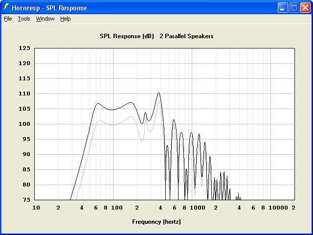

Hi Art,
The fact that in most respects Hornresp sims are very close to reality is proof that your theory is, for the most part, sound.
Just to clarify - it is not my theory :). Hornresp simply uses the standard lumped-element loudspeaker model, similar to AkAbak.
From what I can see of the two William Cowan 60Hz tapped horns connected in parallel, the LF response has increased by about 2 dB compared to the upper response.
In theory, for two speakers connected in parallel compared to one speaker, the difference at high frequencies should be 3 dB and the difference at low frequencies should be 6 dB. When SPL levels are not normalised for comparison purposes, this is exactly what Hornresp shows for the William Cowan 60Hz tapped horn example - see attachment (6 dB difference at 40Hz, 3 dB difference at 400Hz).
The Hornresp sim for the SH15 shows the low corner dropping almost 10 Hz using four cabinets, a much larger spread.
In your example (four speakers compared to one speaker) the difference at high frequencies is 6 dB and the difference at low frequencies is 12 dB - as expected.
Looking at the LF response of one and two of a 2x10" tapped horn with a similar rolloff as the William Cowan horn, I see no difference, in other words, the 2 dB (or so) increase Hornresp predicts does not occur.
It just doesn't make any sense. With two speakers, the horn mouth area is effectively doubled, but the measurements suggest that there has been no change in LF acoustical loading due to the increased mouth "piston" size. I would have thought that there should be some change.
Do you have any real-world measurements that reflect the theoretical dropping of the LF corner in TH that Hornresp predicts?
Unfortunately I don't have any real-world measurements of anything :). I am totally reliant on data provided by people such as yourself, to test the validity of the Hornresp models.

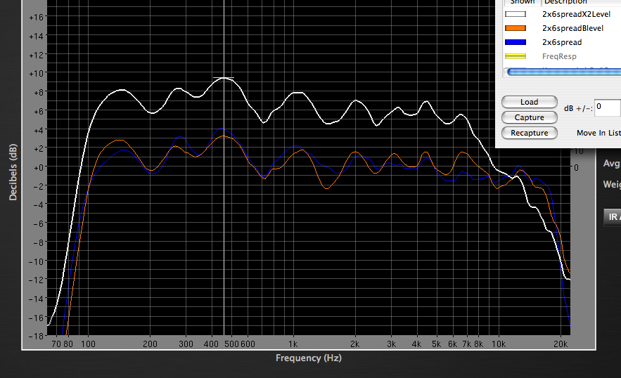

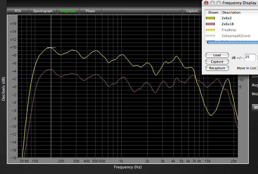

David,
After hearing and measuring the 6 dB increase across the frequency range down the center of left /right stacks, commonly referred to as "power alley", I was surprised to hear your model uses a reduced upper response.
To test that "lumped-element loudspeaker model theory", I did some testing using a pair of small horn loaded speakers today.
The small speakers each have a pair of Eminence 6" and APT tweeters on conical horns, the lows are ported.
The tests were done with the mic on axis 2 meters from the speakers, which were on stands elevating the acoustical center to 2 meters, approximating a full space reading.
Tests were done with the speakers together, and also at 2 meters on center spread between them. Speakers were "toed in" to point at the test mic.
In both cases, the average level difference between one and two was uniformly about 6 dB throughout the range of the speakers.
Above 5000 Hz, the gain (or loss) is erratic due to the wavelengths being so small and the speakers , being on unlevel ground were not exactly equidistant to the microphone, causing dips in response (AKA “comb filtering”, or cancellation).
Also of note, because the speakers used are not perfectly matched (as can be seen in the lower two “2x6spread” screen shot) summation is not exactly 6 dB, though quite close.
Real-world measurements of these horn loaded top cabinets and TH low cabinets indicate to me that some of the theory you base the Hornresp model on could perhaps use some adjustment to reality.

Hi Art,
The Hornresp model doesn't use a 'reduced upper response' - it simply calculates the SPL by applying the following standard formulas and generally-accepted techniques (as documented in Leo Beranek's "Acoustics", for example).
Assuming:
c = 344 metres per second
rho = 1.205 kilograms per cubic metre
Pref = 2 * 10 ^ -5 newtons per square metre
W = acoustical output power in watts
A = spherical surface area in square metres through which the sound radiates
Then:
Sound intensity in watts per square metre I = W / A
Sound pressure in newtons per square metre P = (I * c * rho) ^ 0.5
SPL = 20 * Log10(P / Pref) decibels
CASE 1:
For a single speaker with an output of 1 acoustic watt at high frequencies, where the sound pressure is measured in free space at a distance of 2 metres:
W = 1
A = 4 * Pi * 2 ^ 2
SPL = 20 * Log10(((1 / (4 * Pi * 2 ^ 2) * 344 * 1.205) ^ 0.5) / (2 * 10 ^ -5))
SPL = 103.14 dB
CASE 2:
For two speakers each with an output of 1 acoustic watt at high frequencies, where the total sound pressure is measured in free space at a distance of 2 metres:
W = 1 + 1 = 2
SPL = 20 * Log10(((2 / (4 * Pi * 2 ^ 2) * 344 * 1.205) ^ 0.5) / (2 * 10 ^ -5))
SPL = 106.15 dB
Assuming constant directivity, the theoretical increase in far-field SPL at high frequencies for two speakers compared to one speaker is 3 dB not 6 dB. This is clearly documented in many authoritative reference texts, including the JBL Professional Sound System Design Reference Manual.
Thanks for taking the time to conduct the tests, and for advising me of the results.
I cannot explain your latest measurements - they appear to be defying the laws of physics in that there is twice as much power coming out as is going in. I am reluctant to arbitrarily adjust the Hornresp results to fit your unique reality :).

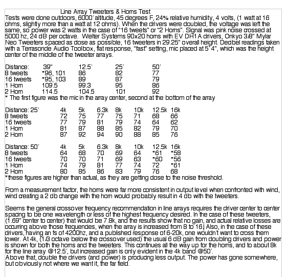

On February 16, 2005, I tested HF horns and small dome tweeters in a line array outdoors.
The results are below.
They are also consistent with the 6 dB increase in level addition of coherent sources, not some “unique reality”.
Anyone doing similar tests outdoors will get similar results ;).

Even though to many, a 1.5 dB difference does not amount to much, the fact that your FLH do show a LF increase, and both types of my quite different TH show no LF increase in pairs should be of further interest to David McBean.
Art
I have a hard time figuring out the logic of your calculations, the only flaw I can see is that they disagree wth actual testing, which is done in dB SPL.
Hi Art,
I found the error in my calculations - I was summing the sound powers rather than the pressures :). Not sure how I came to do this as I got it right in the Combined Response tool, which operates quite similarly in many respects (apart from having a phase difference between the two signals being combined).
The calculations should have been as follows:
Sound intensity from one speaker I = 1 / (4 * Pi * 2 ^ 2)
Sound pressure from one speaker P = (I * 344* 1.205) ^ 0.5
SINGLE SPEAKER:
SPL = 20 * Log10(1 * P / 0.00002) = 103.14 dB
TWO SPEAKERS:
SPL = 20 * Log10(2 * P / 0.00002) = 109.16 dB
The difference is now +6.02 dB - exactly as it should be :).
I will post a message on the Hornresp thread when the error has been corrected and an update is released.
Thanks again for all your help.

I still am curious about this:
It appears that the 12Pi's 30 Hz measured response increases by about 1.5 dB over the 6 dB overall response increase going from one to two, how does that compare to your Hornresp LF prediction for two cabinets in half space?
Hi Art,
Kind regards,
David
Cool, will this have an effect on the simulated LF response of multiple TH ;)?
I hope that in evaluating the multiple speaker SPL output level you will not loose the radiator size and frequency dependent relationship of the acoustic radiation resistance.
Hi Oliver,
That is the one thing that still puzzles me about Art's test results - and now those also posted by Wayne for dual cabinets.
I would have expected to see an additional 3 dB gain at low frequencies due to the mutual interaction between the two closely-coupled radiating horn mouths - which serve to increase the radiation resistance and therefore the acoustical output power.
I understand why it is not shown in my AkAbak simulations - the program is assuming that the two speakers are separated, not closely coupled.
At this stage I am not exactly sure what to do :).
