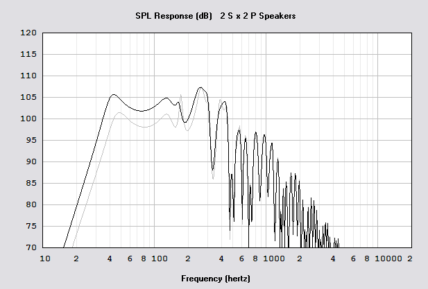

OK, just so I'm clear since I still haven't built/measured a TH; you're saying that this simmed ~6 Hz downward shift of a single Vs 2S-2P and the ~12 Hz Vs 4S-4P [eg = 2.83 V, 2 pi] is all due to increased on -axis directivity? Or is HR being overly optimistic?
TIA,
GM

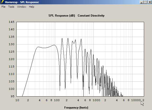

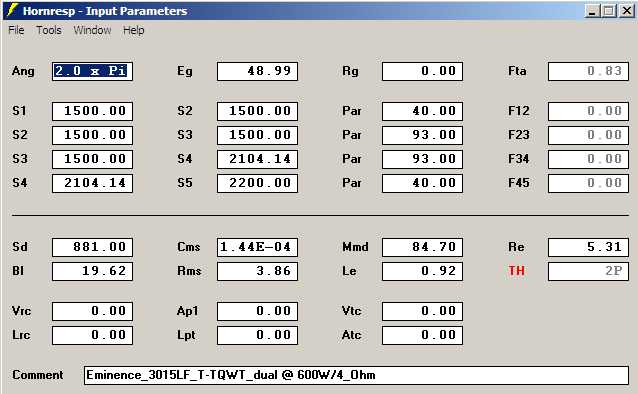

4. As an alternative for Crescendo: how about going the route that justin went with bjorno's T-TQWT? Maybe as a dual, a very easy build, and not as big as a tapped horn. Doesn't look like that would be hard to try.

My observation is that HR is overly optimistic in predicting a downward shift of the low corner in TH response.
On axis directivity increases more in multiples at upper frequencies than lower, so even if Hornresp took directivity into account, the result should be more upper frequency (around 100 Hz) on axis SPL increase rather than more LF.
My actual tests with one TH compared to two show the response goes lower only by a minute amount, and that amount hardly changes when the second cabinet is unpowered and shorted.
Tom Danley or Ivan Beaver have posted charts of the TH-115 with one, two and four, the low corner hardly changes at all.
Typical TH behave more like a BR (which hardly go lower in LF corner in multiples) than FLH, which do go lower in low corner and level in multiples.
Art

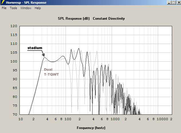

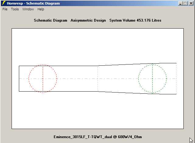

For maximum output with low end extension to 30Hz, and without regard to the size it's the stadium horn.
Using Don Snyder's data: the stadium horn is 48"H x 25.44"W x 36"D, that's 720.4 L_external. In Hornresp - with the segments set to Par - the volume is given as 606.824 L_net. When you take a look at the Hornresp simulation, you will see that this horn can be tweaked a little to smoothen out the response, and to reduce the size a little bit, but it's pretty close as it is. Unlike the SS15 this one does not look like jbell spend a lot of extra time refining it, but it still came out fine.
The stadium horn will reach 11.6mm displacement @ 260W into 8 Ohm (Eg=45.61V) @ 41Hz. The T-TQWT Dual will reach 11.4mm displacement @ 600W into 4 Ohm (Eg=48.99V) @ 42Hz. I'm attaching Hornresp Spl response screens at these levels and at 1W. Depending on which frequency you pick the T-TQWT Dual is quite a bit louder (at a bit more than twice the input power) at that excursion level.
I have not drawn the T-TQWT (for the external volume), but it seems simple enough. In Hornresp the net volume is 453.176 L_net. That's a good 150 L smaller than the stadium horn (or 921.9 L_net for 6ea.). So you're trading of volume for a second driver and roughly twice the required power, but you're gaining 3 to 4 dB more output and a flatter response (in the simulation).
And then there is the question, what does it sound like, and how does it project? Would one be better for outdoors, and the other better for indoors? And so on....
Just as theory predicts. ;)
Seems reasonable based on what I know and the TP, TH sims I've typically done in HR show barely a 1 Hz offset from [1] to [8] speakers, but then it turned around and made FLH like predictions with a TH layout that's a bit different than any I've seen posted by others, so it makes me wonder if HR is wrong.
GM
