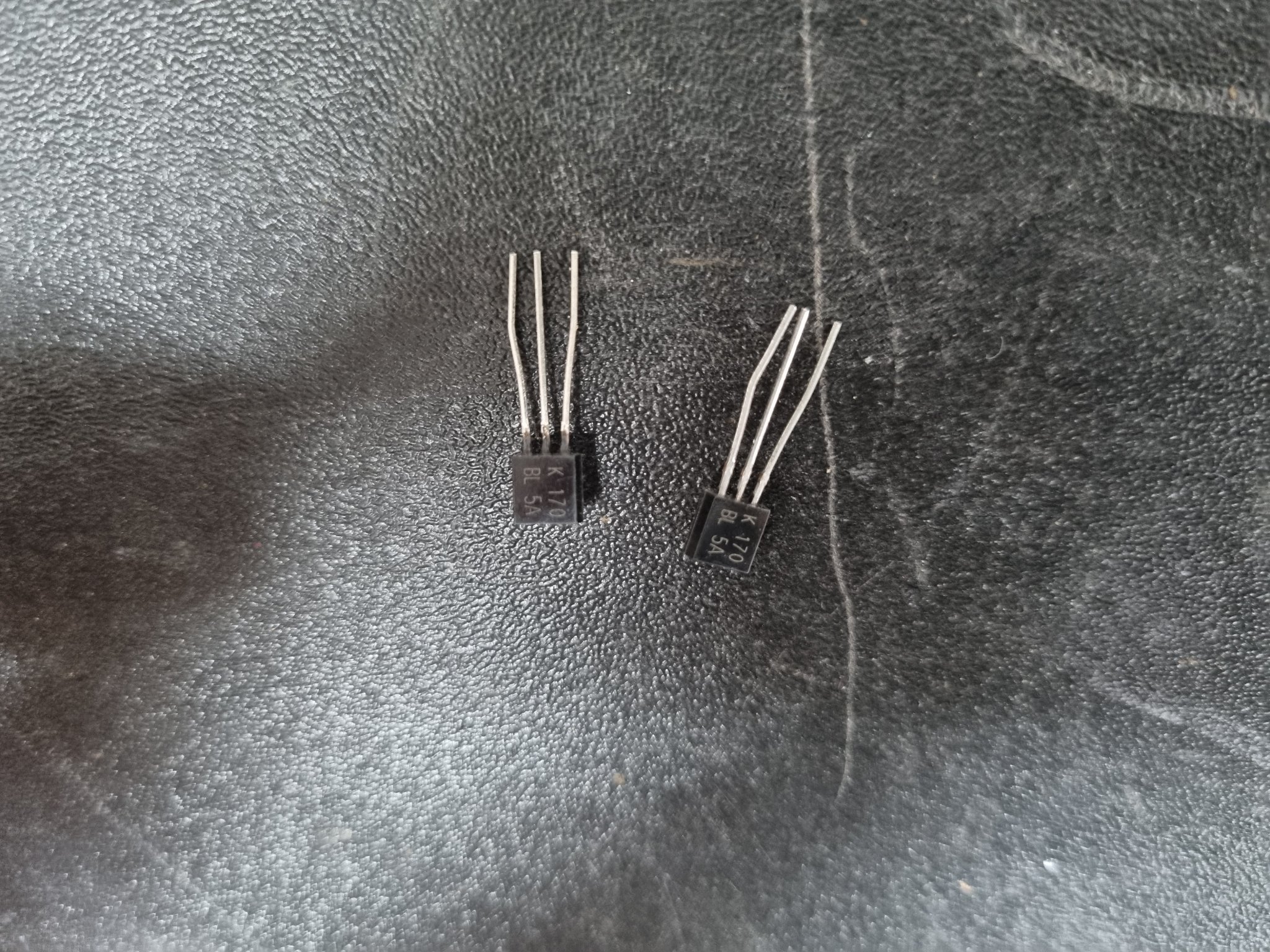

Take some close up pictures and post them so we check if they are at least visually original.Transformers = transistors offcourse.... The 2SK170BL seem quiet hard to be found,
I have bought a few now with the following that have the following Idss on the bags; 7.13-7.14-7.22-7.23-7.63-7.64-7.68-7.71-7.89-7.92-8.21-8.23mA.
I probably can use some of them for sure, but seems i am missing a pair between 8.2 and 8.5mA matched within 1%.
I do have a bench supply, so i can test them on 10V Vds and see if they measure the same as the value thats on the bags now.
I will try to post some closeup pictures of a few this afternoon. I didnt know they were this hard to find, else i would have ordered them together with the PCB's at teabag. I did a quick google search and found quiet some stuff, but most webshops who have them on their site are sold out en others or china for sure.

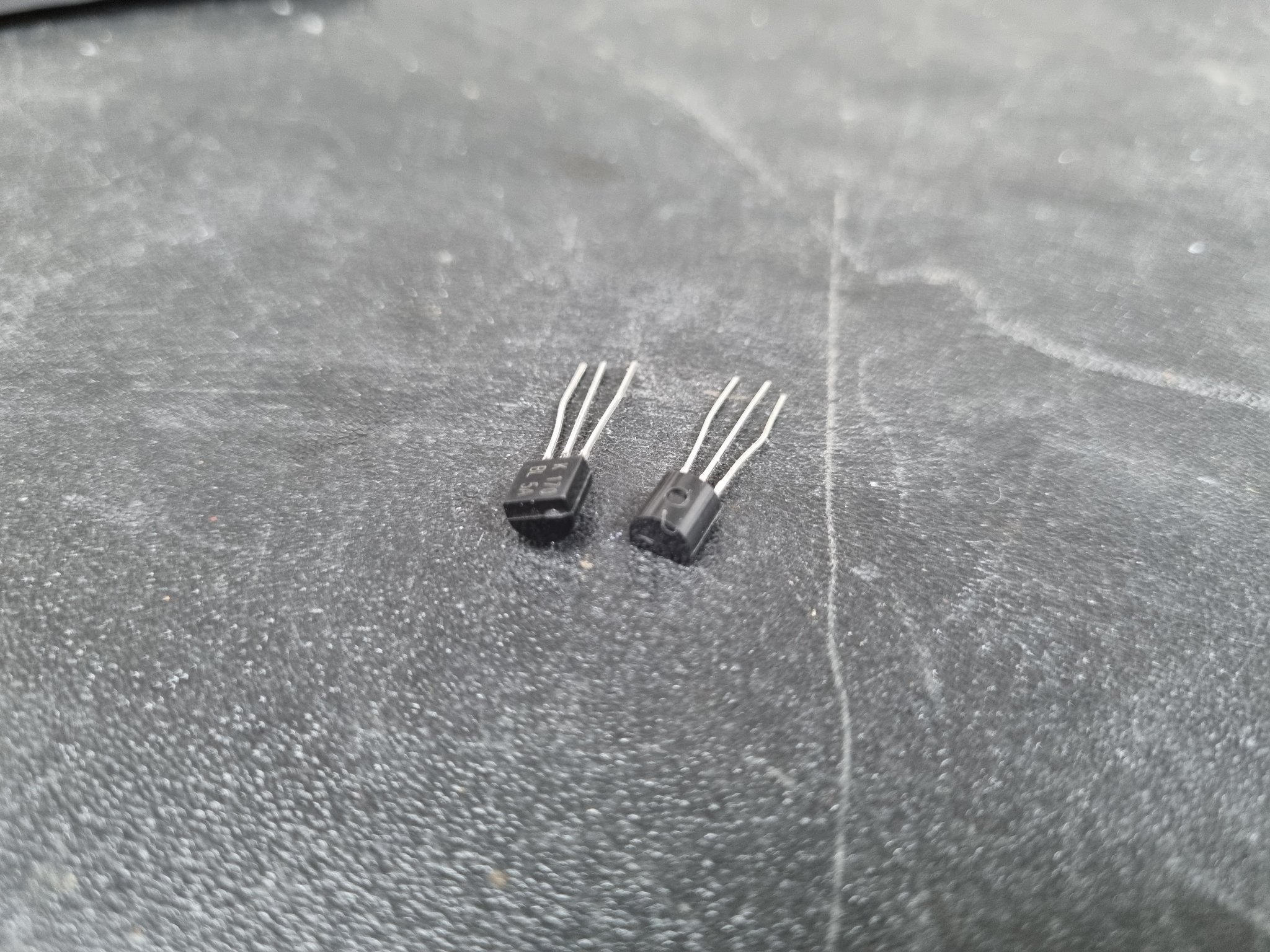

Here are two of the JFETs. After searching how to recognize fakes, it seems i got some fakes... what is the downside of a fake, when Idss measures within the range?
Other question as well: is a VTA56 foil resistor worth investing for the 47k positions? They are 7 euro a piece. Offcourse, not as good as a z201. I was thinking of buying VSH foils, but they are sold out now in the store i was thinking of buying them from.
-Yes, they look non legit. Fakes of good IDSS may DC bias right but lack in transcoductance and noise. In other words to give lower AC gain along with more hiss than expected for originals in a specific circuit.
