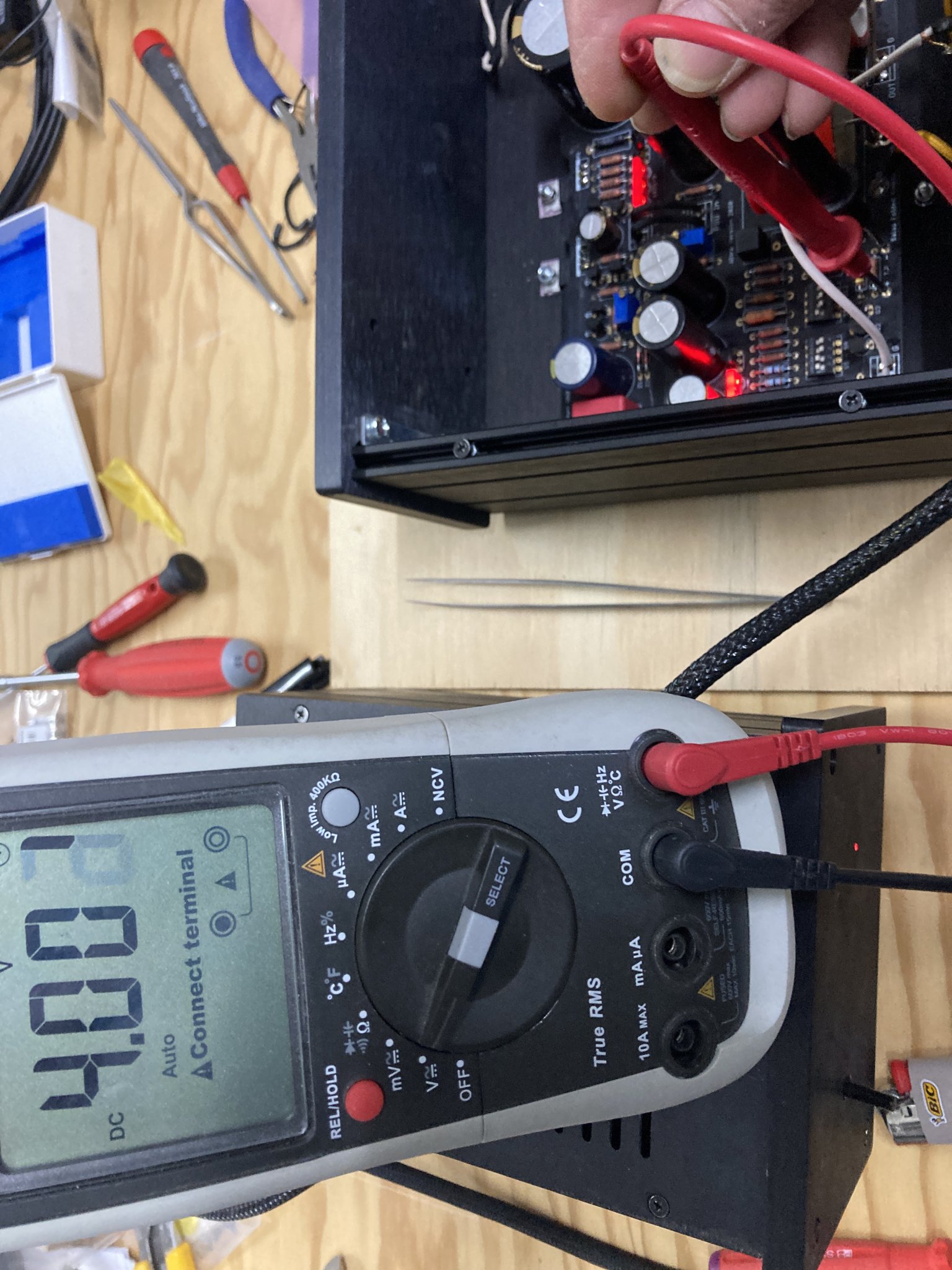

I‘m having more luck. Set to LoMC, 100 ohm load, biasing to the mV (between 3.97 / 4.02 V at t.p.). At first t.p. showed 0 and I started to panick, then to turn the trimmer et voila!

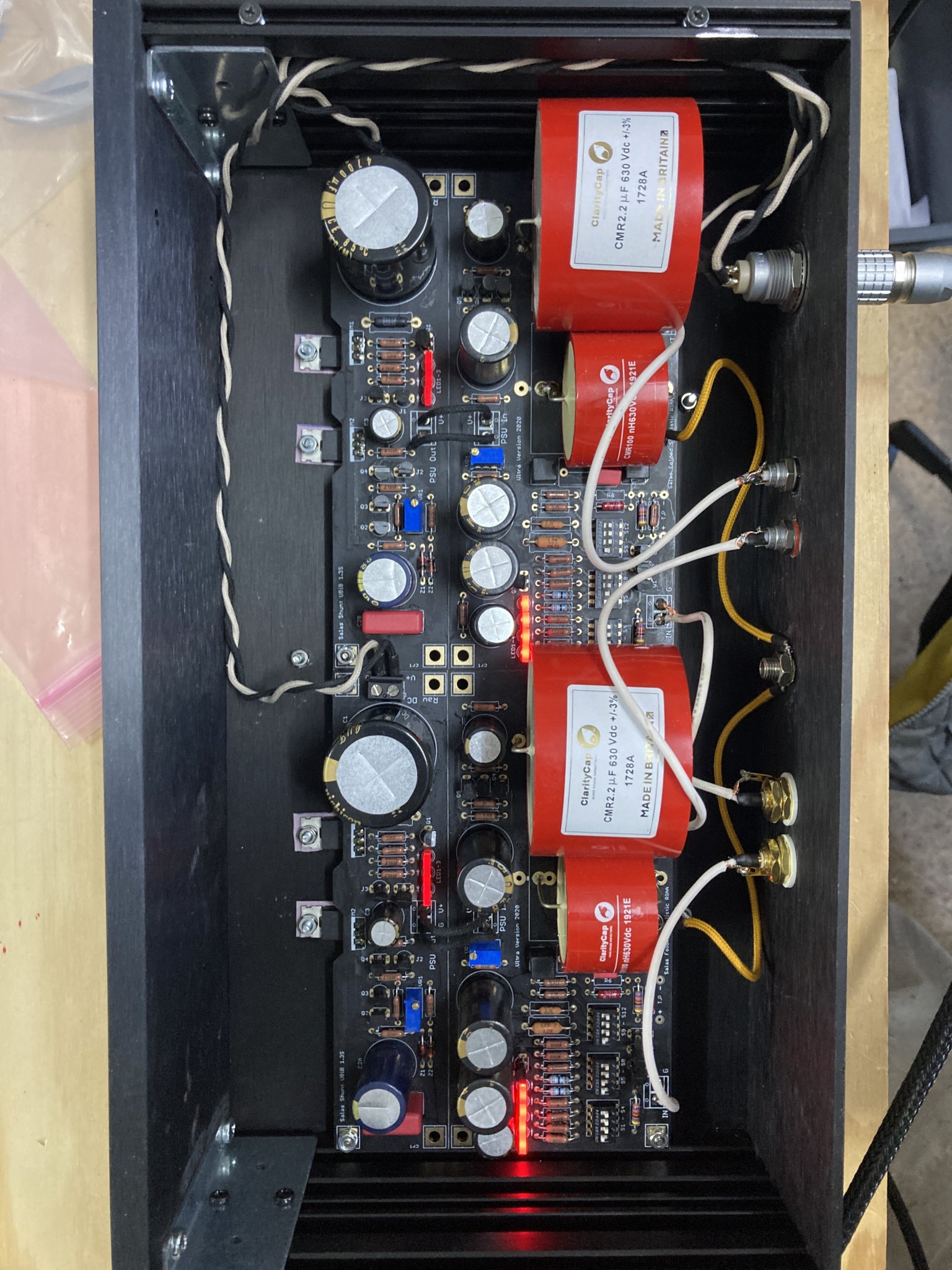

Good evening,
It seems that I had soldered the left UBib Led's with the wrong orientation.
Now All LED's turn on normally.
(Lesson learned, never work on a project that you have no experience at all, after 15h of work..)
Have dialed 33v on the rail and 3,93v on the tp's, after a few hours of warm up, Low MC gain.

First set the switches to the sensitivity you prefer. So there's a valid circuit configuration. Power on to see if something changed with voltages and lights.
If still the same:
Start with comparing the orientation of the non working Ubib Leds to the working ones in the other Ubib. Even if one is put wrong or it died by long soldering their chain breaks and no current passes.
On the lit right channel Ubib also turn its trimmer. To test for full functionality. Try adjust it down to 33V regulated output.

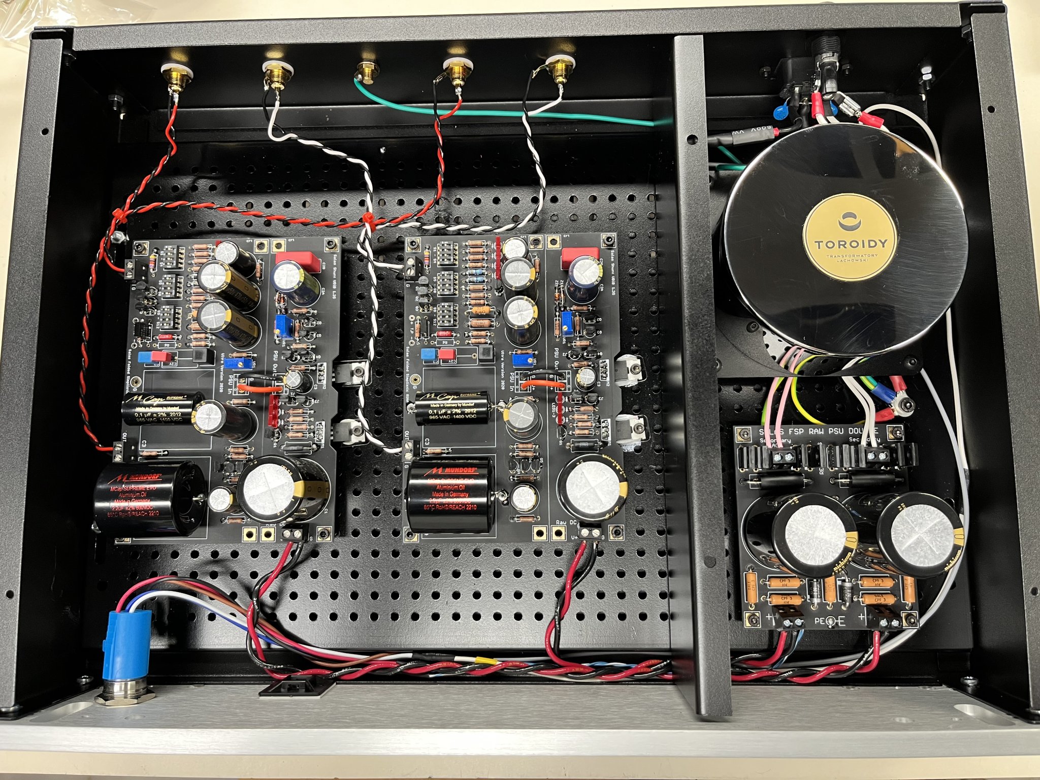

Just adding my completed build to the collection. Only has about 2 hours of play on it, but wow, so much more open, detailed and effortless than my previous phono stage (Hagerman Bugle 2). Noticeably deeper darker background too. I do have a tiny bit of hiss coming through my system from it, but that’s about it.
Reactions: 7 users
Is this toroidy something new? (I knew the potted ones only in glossy chrome…)
It is a Toroidy Audio Supreme model. Vacuum impregnated windings, electric and electromagnetic shields with a polished stainless steel cover. Very nice.
I also have a steel partition between it and the signal circuits. I was hoping all of that was sufficient to keep circuit quiet while being in the same box.
Seems to have worked - no additional hum can be heard at all while the phono input is being used.
