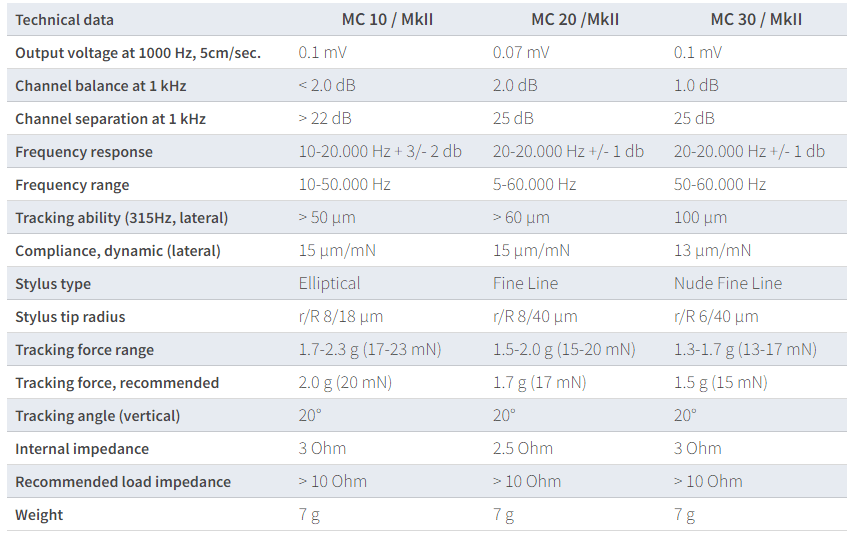

Hi all I have order a kit and will soon start to build. But I have a concern about my stylus its the old Otfofon MC20 mkII and also an Ortofon stm72 to handle the extremly low output of about 0,07mV. The stepup gain 60dB so ut will be useful in a MM RIAA stage. It sounds really wonderful. I have used it with an DIY Le-Pacific stage and also with Quad 34pre with good result. But how to set it up with this great RIAA? With or without stepup and what configuration will be good?
Ortofon STM72 Frequency response: 10Hz-50kHz, Voltage ratio: 1:60, Impedance ratio: 1:3600, Pick-Up Impedance: 2-3 Ohm, Recommended load Impedance for stereo: 47kΩ.
Ortofon MC20 mkII specs in picture
Looking forward for any suggestion.
Hi, the Ortofon STM-72 step up has also been reported as 35dB gain. That's 56 times multiplication if not bang on to its 1:60 spec. Brings a 0.07mV MC 20 MkII to 3.92mV worst case. Thus, set the UFSP phono for MM mode (40dB) & 82k R1 input load, utilizing the STM-72. Gives 26Ω reflected load to your 2.5Ω cartridge that way. Not loading it down.

LMC high sensitivity direct mode in the UFSP is going to give useful output signal with 0.25mV carts the weakest practical I would say.
Also treat well the old STM's RCAs with contact cleaner. Including the captive output male ones.
The Sumiko 0.5mV can be used straight into the UFSP either in the 56dB MC or 61dB LMC set-up mode. Whichever your system sounds best with, regarding most suitable phono output signal level. Try both settings. The DIP switches are practical for doing that.
Also have Rx3 300 Ω and Rx4 110 kΩ to can try for its loading instead of just 82 kΩ R1 reserved for the special case STM-72 + MC 20 MkII combination.
Because R1 is always in parallel, with Rx4 engaged a cart gets to see ~47 kΩ. With Rx3 engaged 299Ω. Your cart has 28Ω internal impedance and 47k is a general purpose recommended load so both those loadings are valid and useful to have.

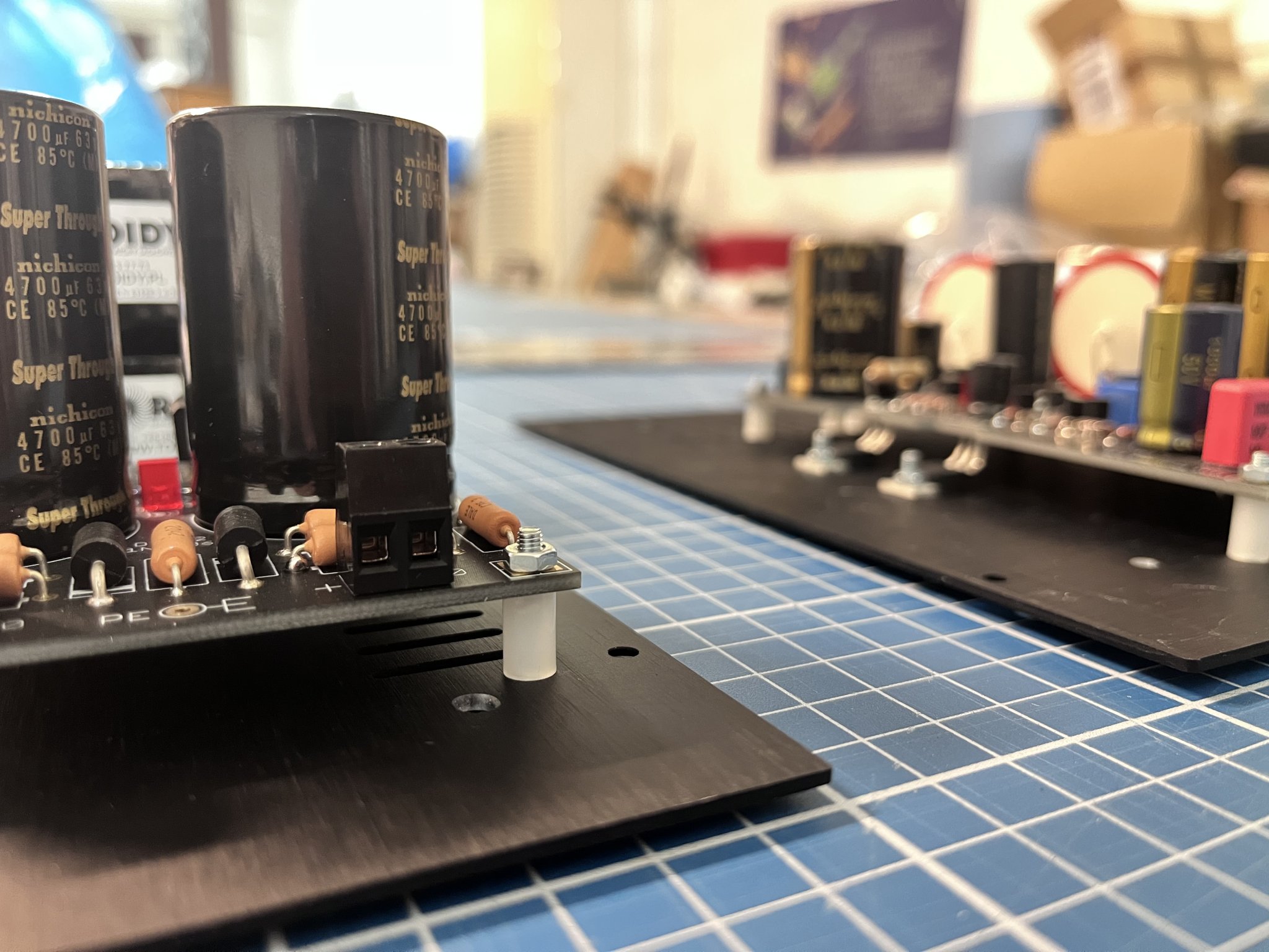

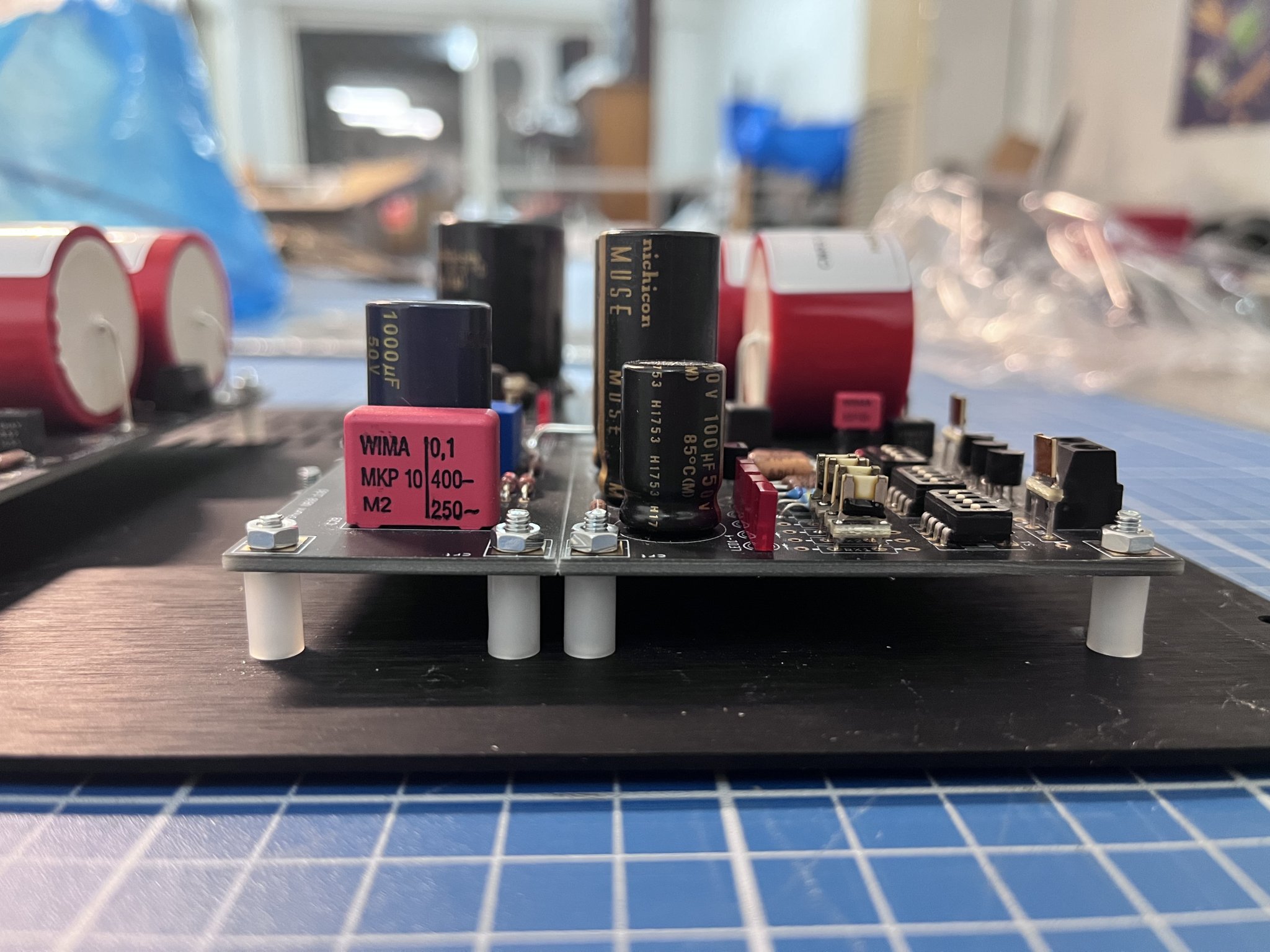

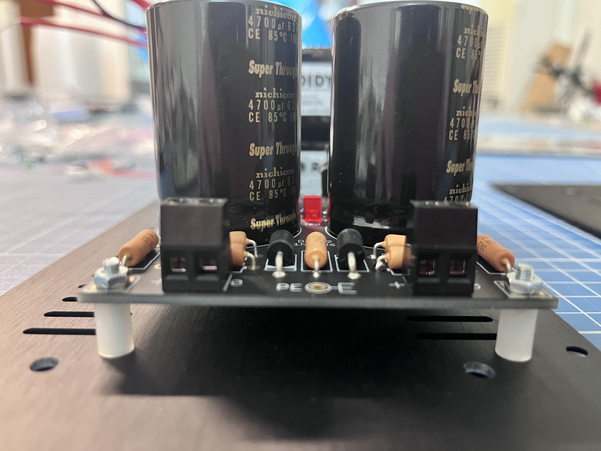

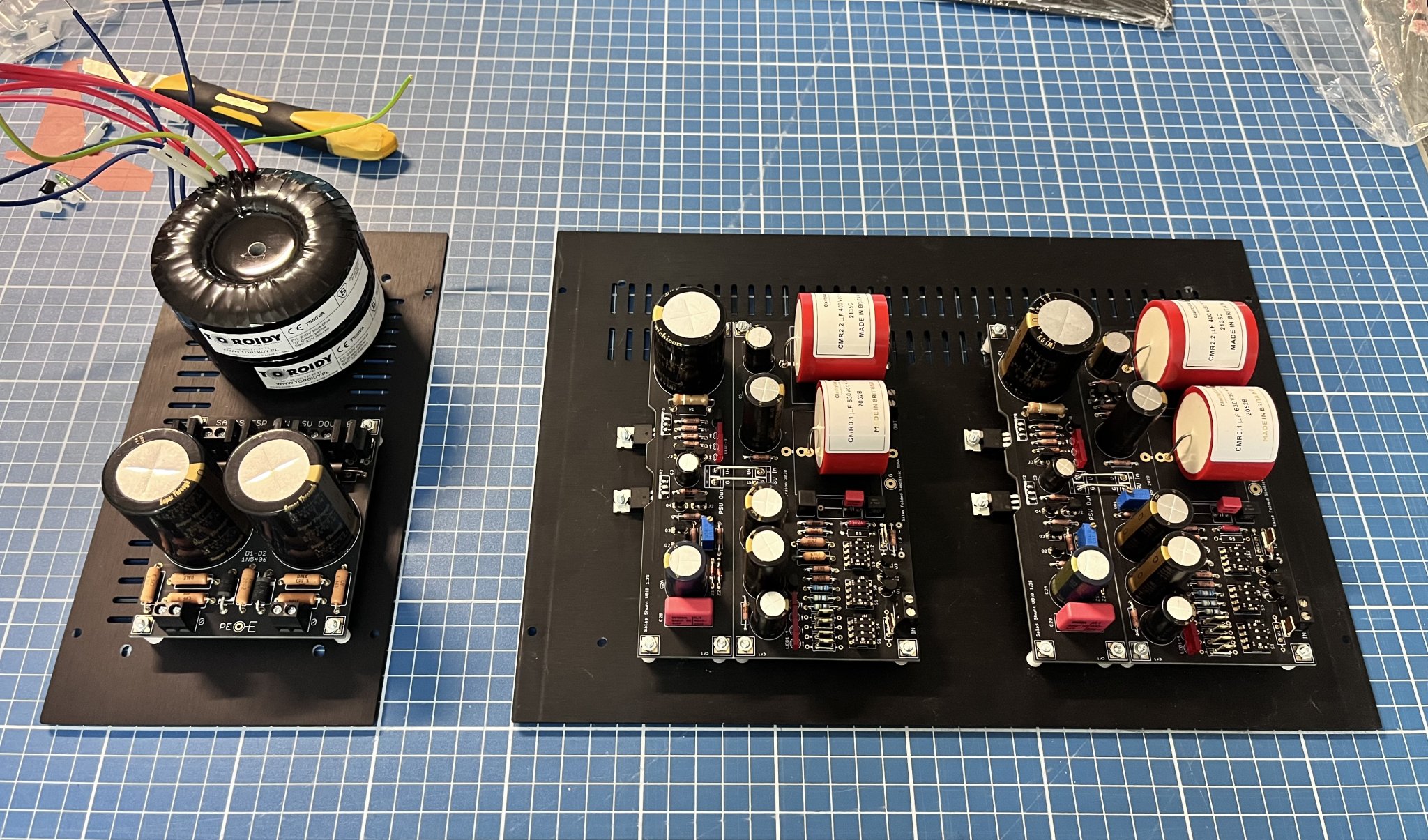

So it seems that today wasn't going to happen. Another delay for finishing this project.
My CnC is loosing track of it's one axis and I get not enough accuracy to finalize the front and rear face plates.
At least the bottom plate holes where correct and it starts to take shape.
Will come back with the plates drilled and engraved.

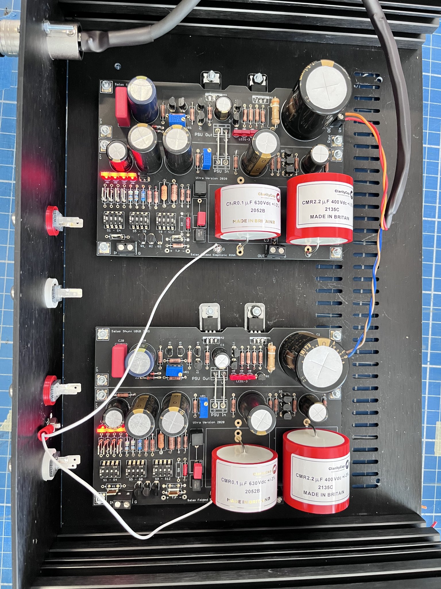

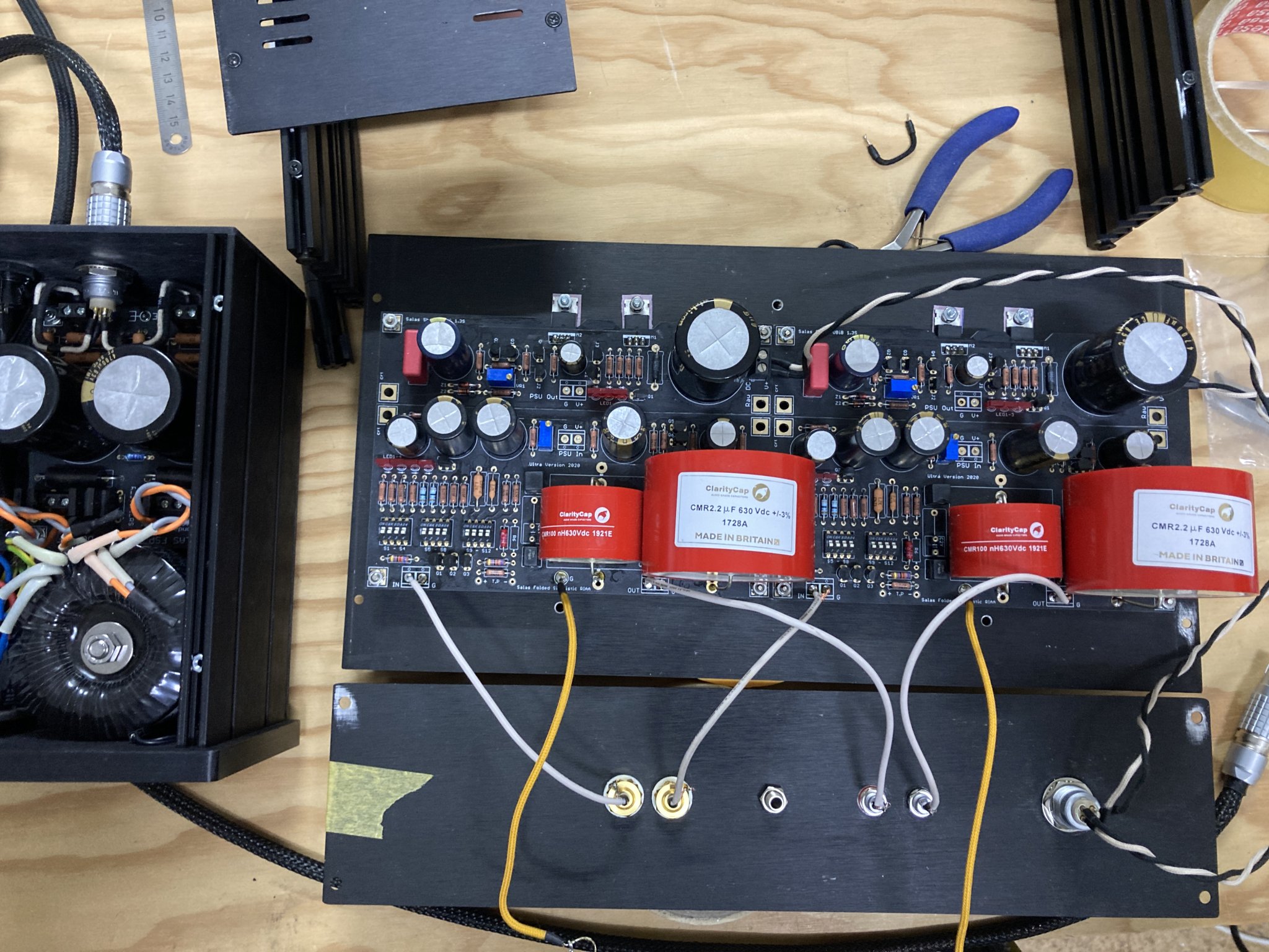

Hello,
I just gave power to the phono and it seeams that something is wrong.
On the Left channel, the leds on ultrabib are OFF but the leds on the phono are ON
The V comming from Raw PSU is 40.3v
The V on the output of UBib is 32v flactuating
the V on the phono is T.P. 9.1v constant
On the Right channel, the leds on ultrabib are ON and the leds on the phono are ON
The V comming from Raw PSU is 39.4v
The V on the output of UBib is 36.98v constant
the V on the phono is T.P. 9.15v constant
Any ideas on what might be wrong on the left Ultra Bib???

First set the switches to the sensitivity you prefer. So there's a valid circuit configuration. Power on to see if something changed with voltages and lights.
If still the same:
Start with comparing the orientation of the non working Ubib Leds to the working ones in the other Ubib. Even if one is put wrong or it died by long soldering their chain breaks and no current passes.
On the lit right channel Ubib also turn its trimmer. To test for full functionality. Try adjust it down to 33V regulated output.
If still the same:
Lastly a general comparison of correct semiconductor types in correct places between working and non working sections. Starting with reading print on the Mosfets.
If all the above basic construction checks reveal nothing obviously wrong then the plot thickens. Bad component hunt season starts.
