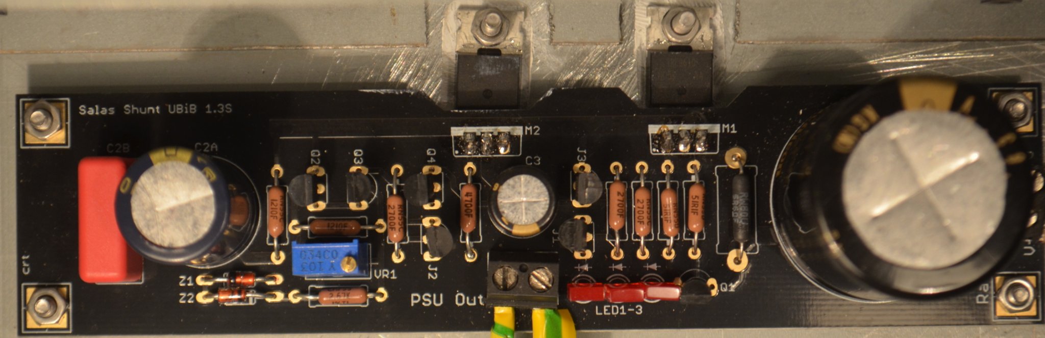

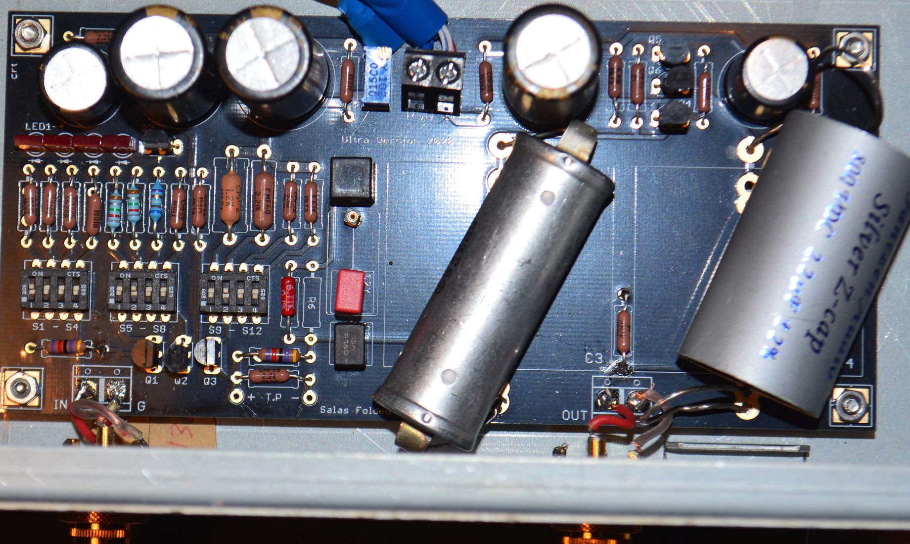

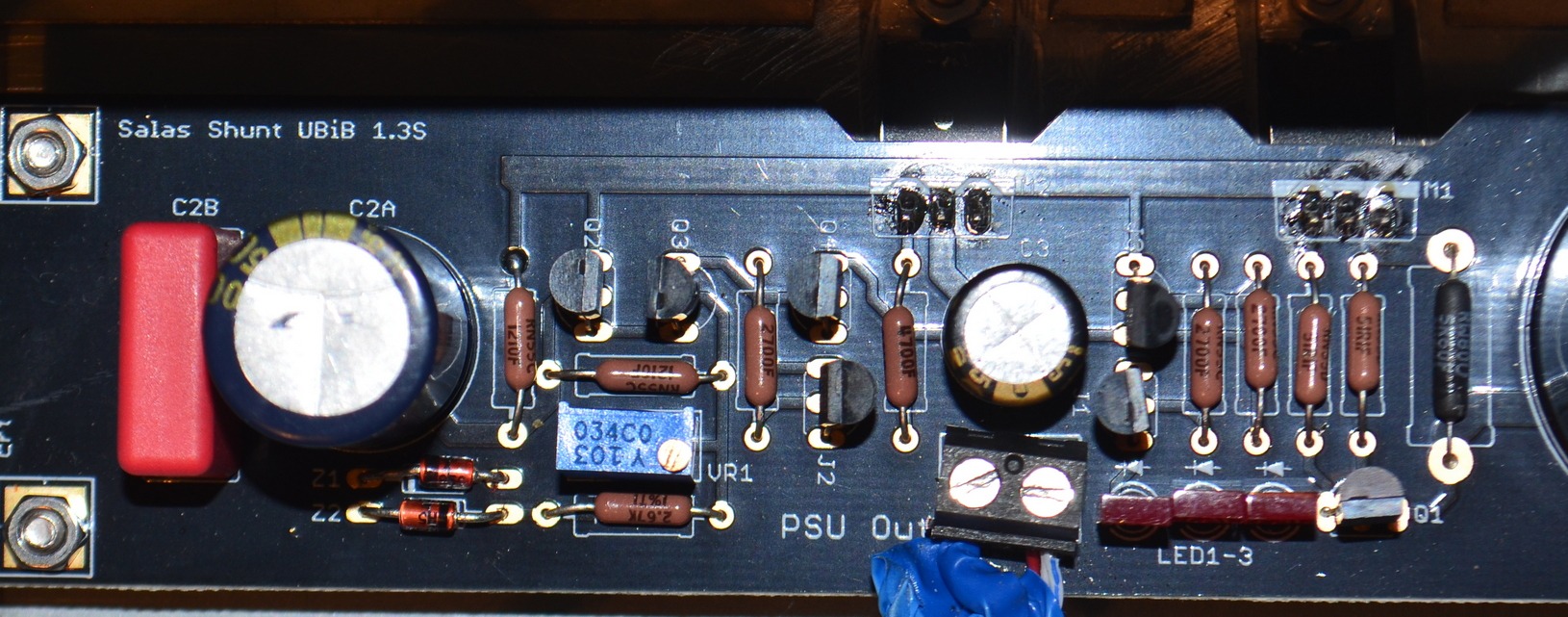

I'm sending you the pictures

diyAudio Chief Moderator
Joined 2002
By the way put a thin tie wrap around C3, squeeze a wire between it and the Aluminum sleeved barrel. See it makes a good contact. Regular solder does not make a good bond on Alu but the tie wrap will work. Ground the wire's other end. Russian FT caps tend to attract RF on their metal sleeve. It should not touch any pads underneath it either.
Joined 2002
My gain setting is :
MC 56dB
S6 ON S10 ON all others OFF
RX1 ON all others OFF (100 Ohms / I have more noise with more Ohms)
Also for your Phasemation PP-200 0.3mV cartridge try:
LoMC 62dB
S5 ON S6 ON S9 ON all others OFF
Just in case some switch is stack doing something weird. Anyway its a more proper gain for such a cart when your phono build will be debugged.

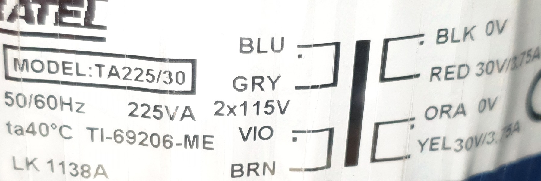

The transformer is a NORATEL 235VA 2x30V that I took from another project.
I also tried a HAFLER TA1600 transformer.
Joined 2002
All OFF would not create bias in the phono channels input sections and there would be no signal. So a wrong state but not a dangerous one.
Since the shunt supplies are adjusting DC out but even if with battery input they make noise see if details are good like there is 0.6V voltage drop across R1 and if their Q2 Q3 have about 0,6V Vbe too. It really takes some expert scope detection testing for oscillations and noise on dummy loaded shunt regs to confidently debug. But lets do the method of elimination for bad components with spot voltage checks that we can for now.

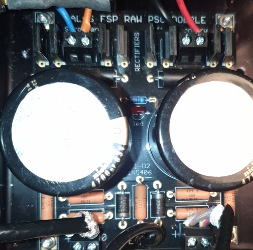

Those got four wire independent 30V secondaries 30V theoric / 33V mesured for the NORATEL, and a lower voltage for the HAFLER.
It is Raw Supply standard.
Center tapped doesn't work for the particularly configured shunts ??? I think it's ok, I send you some pictures :
