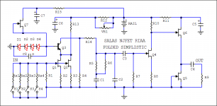

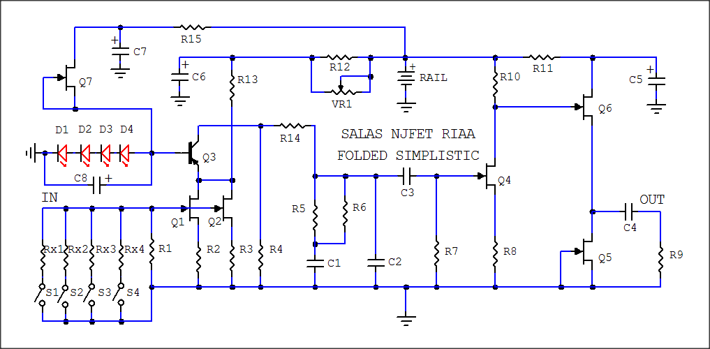

So here is a rather concise explanation of the FSP schematic in a single post. I hope it will be helpful to more members. We will not go into the whys of its topological and parts choices philosophy here. Just to the mechanics. Its a two gain stages plus buffer architecture discrete preamp. Lets see the stages one by one.
A. Input stage
The phono cartridge's signal goes through a switched loading choice system and its applied to the gates of Q1 & Q2 minimal noise type JFETS. Cooperating with Q3 BJT the stage's gain engine is formed. Q1 & Q2 are a common source amplifier while Q3 is a common base one that sits on their drains in series. The common base part shields the JFETS transcondactance from the load resistor R4. The technique is called "cascode" and its goal is not to let their gate to drain parasitic capacitance magnify more than a couple of times while the signal is still amplified to high gain by this JFET+BJT combination system. Else the total input referred capacitance would have escalated at same amplification rate as the signal's. Such capacitance boost is called Miller. We don't want it here. It brings various negative effects regarding proper cart loading, electrical resonance, bandwidth limiting. Especially for MM cartridges.
This cascode is also a kind that goes around to the ground point for reference than going up to the rail. Q3 is PNP while R4 loads it and folds over to GND. That is why its called a folded cascode. The much more common type that refers to the rail is called telescopic. It must still draw current from a power source nonetheless so R13 provides it as passive CCS. DC current flows through Q1 Q2 and R2 R3 to ground. They ask for a certain amount as a system dependent on IDSS and degeneration. What is surplus goes through Q3 to R4. It creates a collector output DC voltage we want to keep at about half the value where Q3's base sits. Q7 is a JFET CCS that sends current to D1-D4 LEDS creating with their VF a steady DC voltage point for Q3's base. C8 filters for noise. Across R4 the output signal develops by the action of Q3. R12 and R15 make proper DC drops in the circuit. C6 & C7 form local filters with those.
Rail voltage value, R12//VR1, R13, Q1 Q2 IDSS, R2 R3, all form a balance system which is both pre-calculated and trimmer adjustable to set the two bias currents of the cascode combo in correct analogy. To monitor and adjust the resulting DC voltage difference between Q3's base and collector, test points are marked on the PCB (TP1 TP2). The PSU's variable output voltage setting adjusts the system while VR1 lends a finer touch if needed.
B. RIAA and the second stage
There is no negative feedback loop between stages in this preamp so it can't nest some interstage active filter. A passive RIAA filter network of no "lost constant" addition is located between stages one and two. R14 R5 C1 C2 form its base impedance and LF/HF filter curve branches. R6 is corrective to R5's standard value, makes it more precise, or a special value R5 can be used skipping R6. There is also a C2Y pF range capacitor place on the PCB to complement C2's value against tolerances or towards preference. They are the important HF branch. Both the input stage's source impedance and the second stage's Miller effect have been included in the total filter's tuning. C3 AC couples the equalized signal to stage two. R7 refers Q4 JFET's gate to ground. R10 is its drain load and R8 is its source degeneration providing some judicial amount of local feedback to better THD. This single high transconductance JFET common source stage is potent enough for further amplifying to the final output voltage swing goal. Aiming at 300-400mV AC RMS with most cartridges. As recommended for LMC/MC/HMC/MM nominal output ranges and the circuit's proper sensitivity configuration options in the build manual. The DC level created between R10 and Q4's drain is also the voltage reference point for the output buffer circuit.
C. Output buffer
Q6 copies the signal as seen at its gate while performing current gain only. It is a source follower. Through C4 AC coupling the buffered signal finally outputs. There are no degeneration or damping resistors. Thus the output impedance is no more than the intrinsic RDS. Usually 30-50 Ohm for this JFET type. Q5 is configured as an IDSS current source and determines the current bias of Q6. R9 provides a local discharge path to C4 not to suddenly do it when connecting gear. R11 and C5 form an RC filter for proper voltage drop to center the buffer in regard to Q6's gate voltage bias. It also performs some local noise cleaning.
I hope it was a simple enough description to follow. I linked it in post#1 too. For the FSP's integrated PSU please refer to the BIB SSLV1.1 shunt regulator as they are highly related. The SSLV1.1 build thread

There can be some adjustment of resistor values to recommend for your intermediate target gain. But first I need to know your cartridge model and the IDSS of the K369 you have installed.
I think I would be interested in the same for my build. Cartridge is an AT ML440MLa. The K369 Idss I'd have to look at but think they are in the 11-12mA range. Intended loading will be ~33K. The cartridge is spec'd at 4mV output. Calculation results in ~48dB (log(1/.004)*20).
