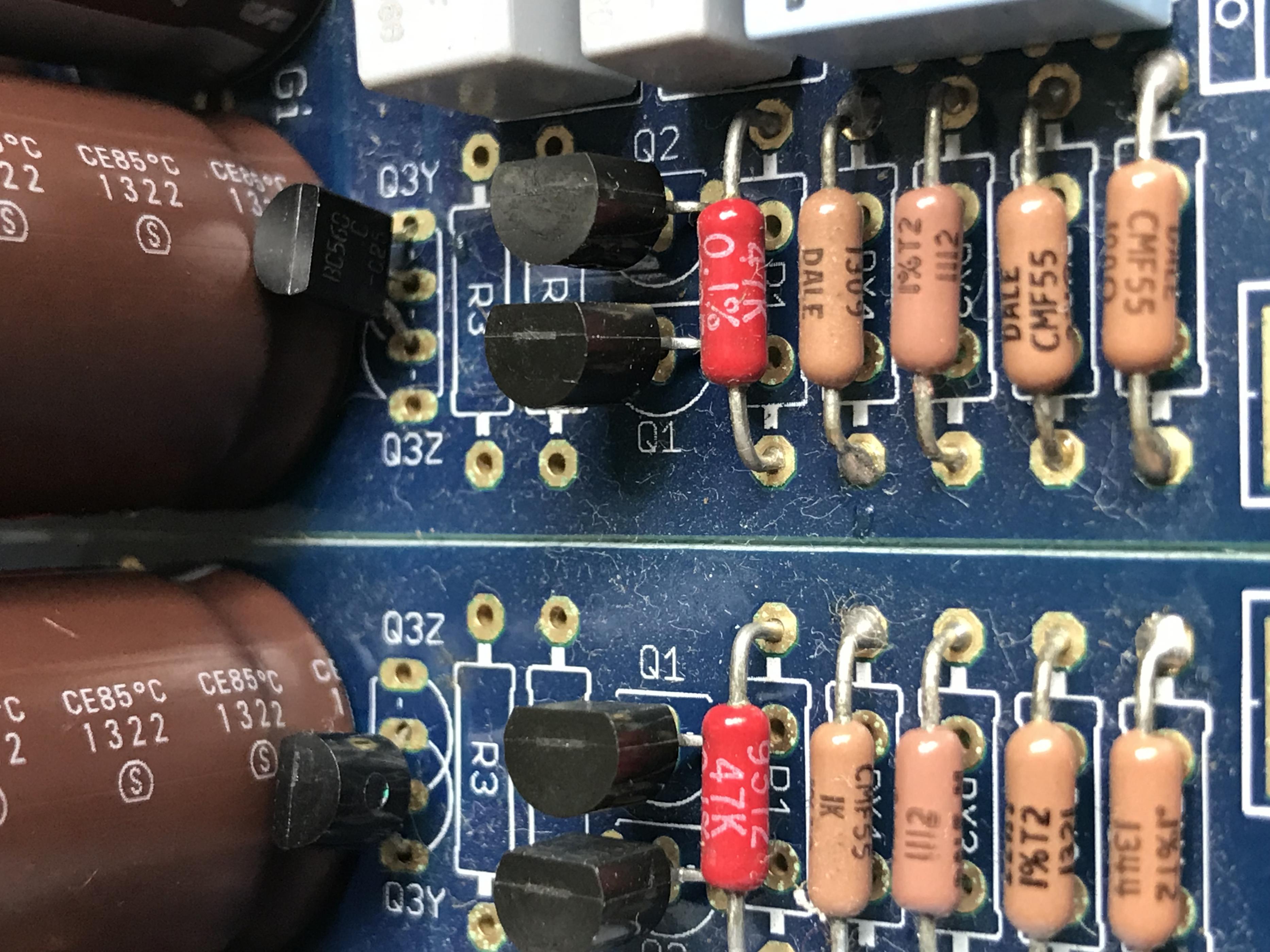

Hi Salas, so I’m short on a few parts, but have made some progress. Q3y hfe both around 608. Is this orientation correct?
All a little dusty like my brain. 😜
Q3y
Slow progress, but getting there. Is this the correct orientation for Q3Y?

P.S. Notice that if your own LED strings don't exactly reach the total forward drop voltages quoted in the instructions its not a problem, you just want them strings total voltages fairly well matched between the channels. Since the rest are already done and installed in in your case except D1x just match two reds for D1x to complete the PSU circuits.
