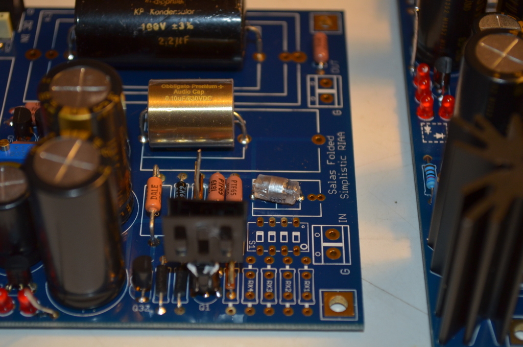

I use 5R6 R2/R3 for my 12.4mA JFETs - are these good or should I replace them with 5R1?

As my p/s is 1mtr from the FSB would there be any advantage in having extra capacitance next to the phono pcb's?
You could use 100uF/63V instead of 0.1uF C3x for simplicity. Listen before and after. Maybe under the board to keep leads short. Or on top just leaning over R6x.
These are good. Better balance between degeneration and IDSS than in mine for instance. See your drifts after you got a box, now its rather useless to bother much. Do you use the minisinks? Those help.
Yes I use the minisinks. Yepp, it's seemingly a moving target unboxed.

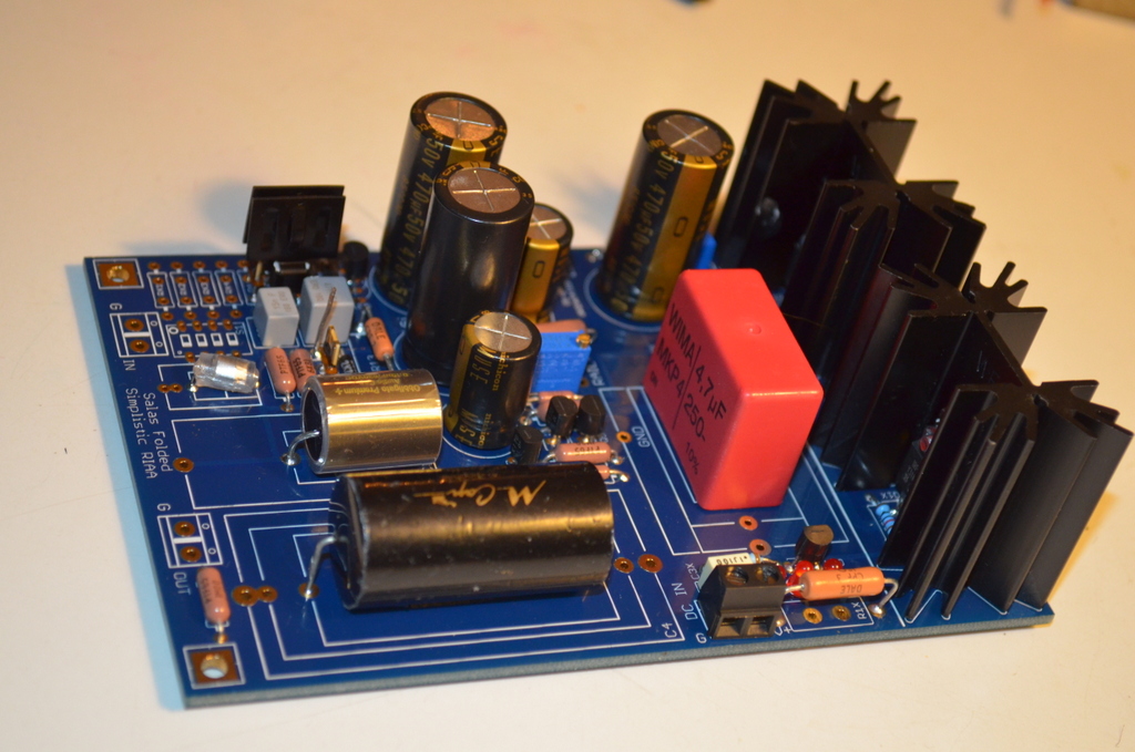

You could move your input coax directly on the pins of your 5K load resistor to skip layout distance also. You don't have the DIP and other load options in use for now, so why not.

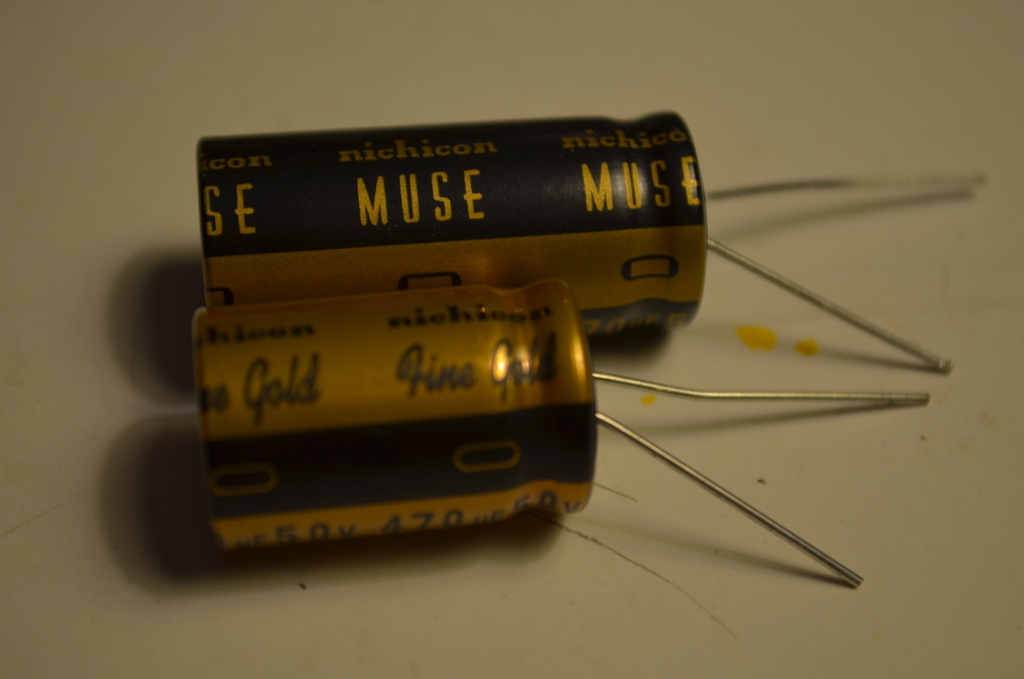

Needless to say, I received no call on the weekend. Finally got the caps tonight. If anyone is wondering about the physical difference between Nichicon FG "Fine Gold" and KZ "Muse", here they are:
They are both 470uF/50V.

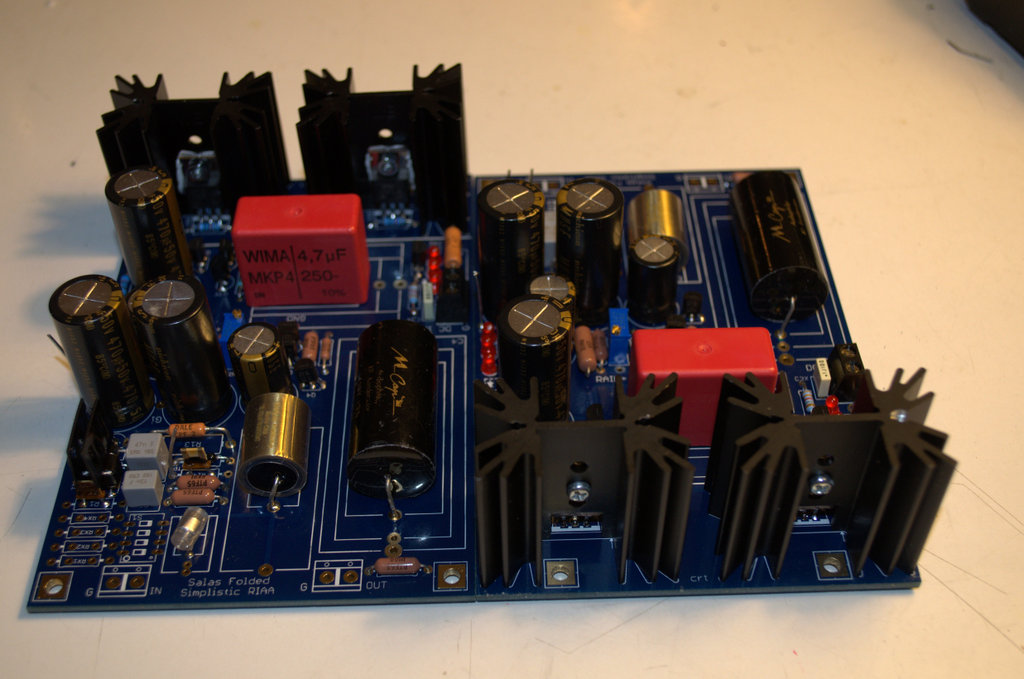

With those in place I have finally finished the main circuit boards:
I feel like now I can focus on the PSU.
