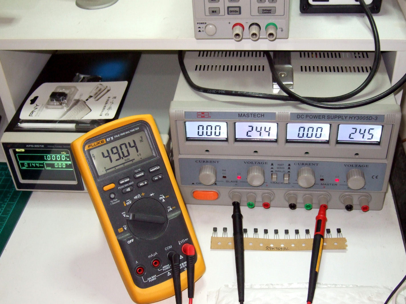

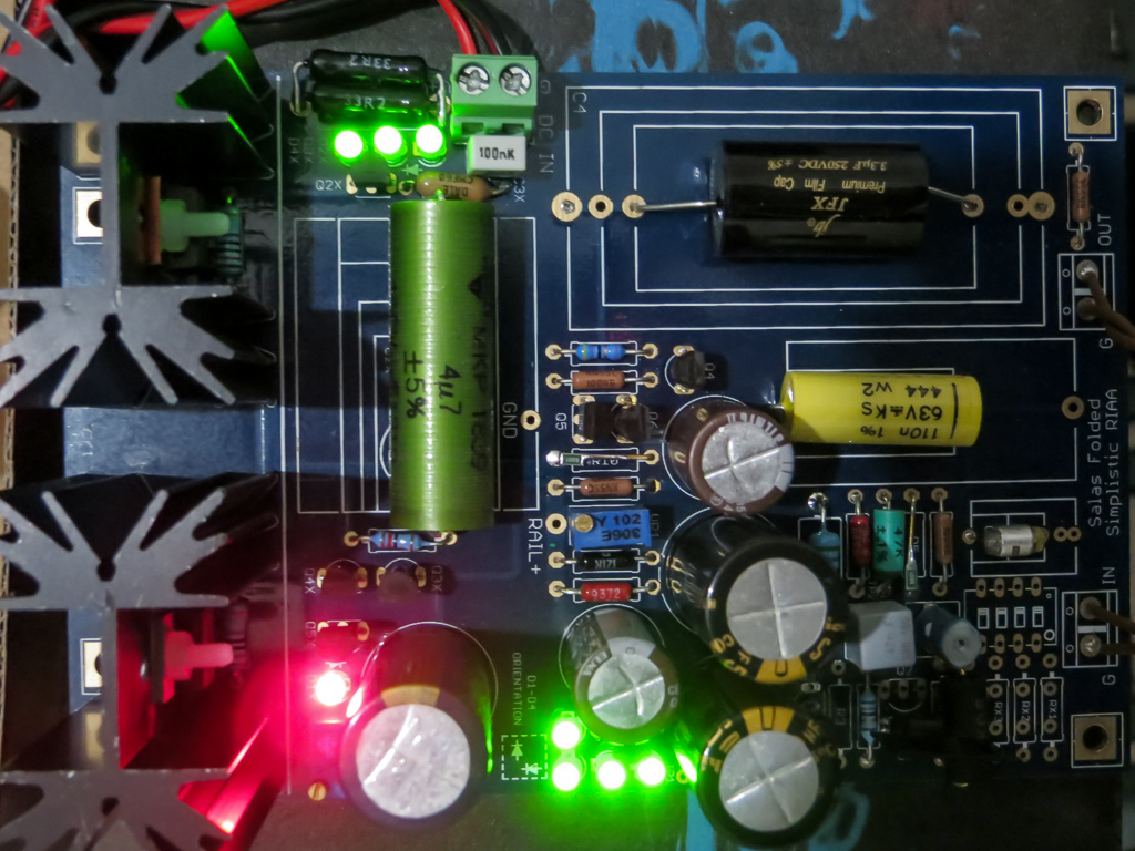

You could lift it from the board and check it first. They don' t get easily burned from overheating.
Maybe static, but on both channels is weird. Beyond being bought mishandled as a batch, difficult.
In case his new 9610s won't make good then the puzzle escalates.I think you should also measure voltages on all 3 pins of Q2x and Q1x, If you have 49V at the "top" of D2x, can you measure voltage all along that string to the drain of Q2x?
Not even in the hundreds of BIB regs we have had something like that before. Plus his photos show a clean construction with no wrong orientations.

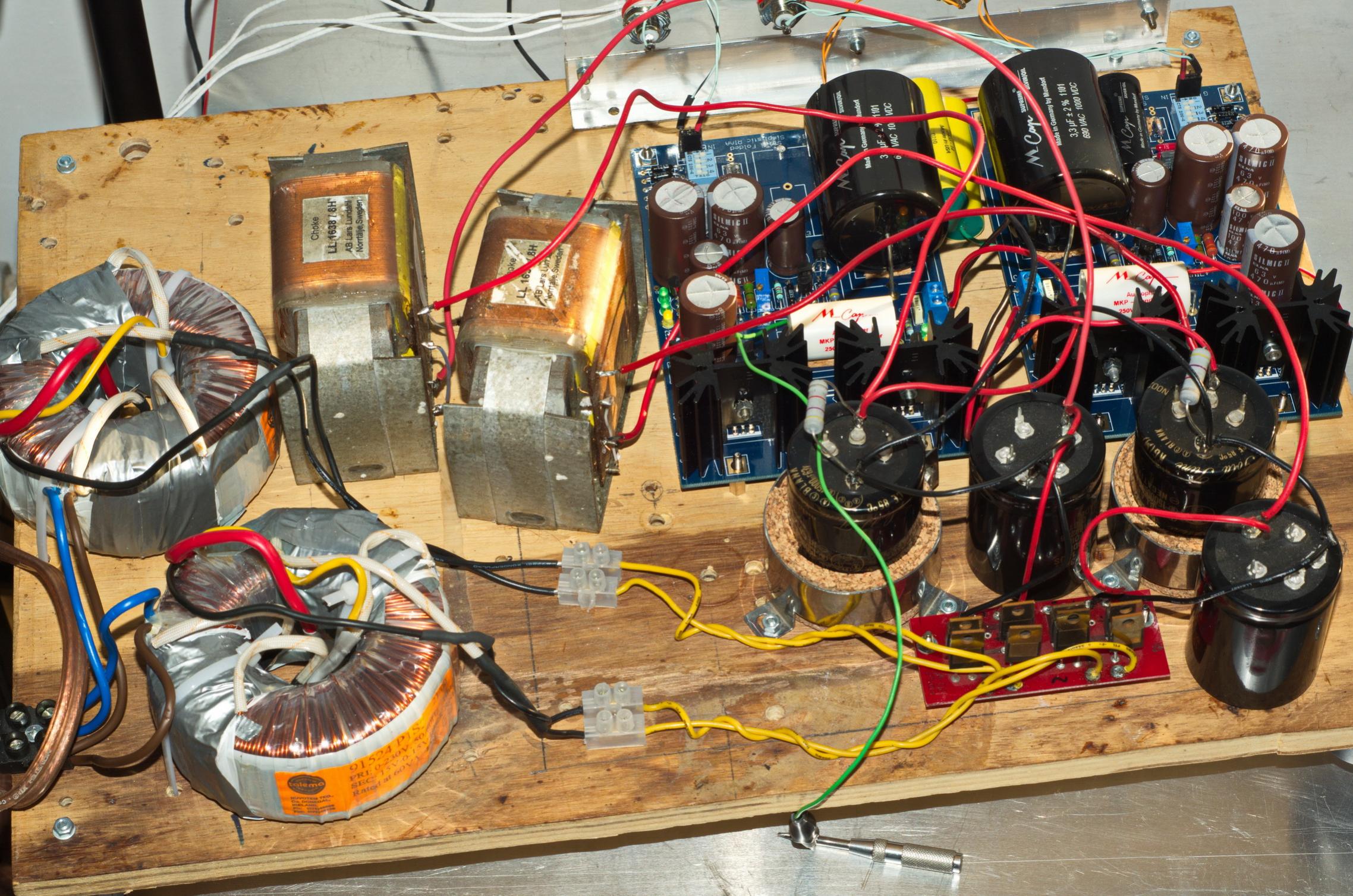

Added a couple of 8H chokes. And a couple more electrolytic caps. 3 ways of hooking the chokes up: 8H, 36ohms or 2H 9ohms, or in common mode. Lots more listening to do.

I can confirm r2x r4x are 121ohms.
Couldnt find irf9610 in 2 stores i went today so the search will continue tomorrow.
I also found that thread here in the forum which got me worried that maybe my cheap soldering iron might have fried the FET
http://www.diyaudio.com/forums/pass-labs/126130-careful-about-irf9610.html
Did you try Radio Katouma? If you will not find any MOSFETS in the end bring it to my place in the weekend since you are a fellow Athenian. I have a few left 9610s I think and my iron is an ESD safe Metcal. Keep the old ones, I want to check them on the DCA tracer to see if they were really dead out of curiosity. We can test the boards off a current limited bench PSU against your own raw PSU in case there is something wrong with it that we could find as well. So bring the whole shebang over.
If you will find MOSFETS, try first, for the sweet revenge you could beat that Murphy geezer on your own.

Interesting experiments to many builders. Let us know your evaluations.
P.S. Maybe you could twist some cables in the CLC to reduce their loop area?
What is the nominal current rating (mA) would you recommend for chokes in Raw PSU for our Folded?
Also, I assume it should be concern about voltage drop.
So, for classic CLC it should be about : 1.4v+0.9v+1.4v= 3.7V
Theoretically, if I have 52v out from my rectifier, then final V out of Raw DC equipped with Pi should be equal to 48.3v. Right?
