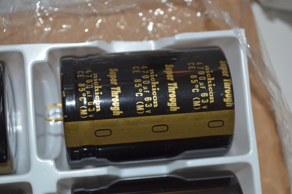

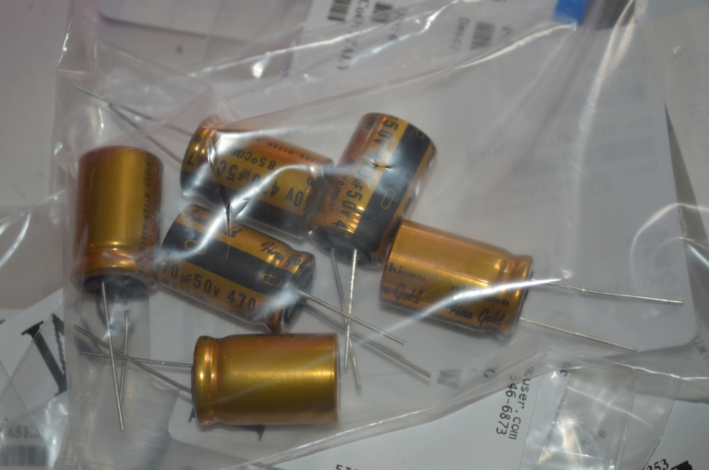

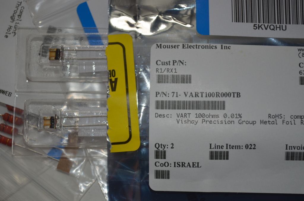

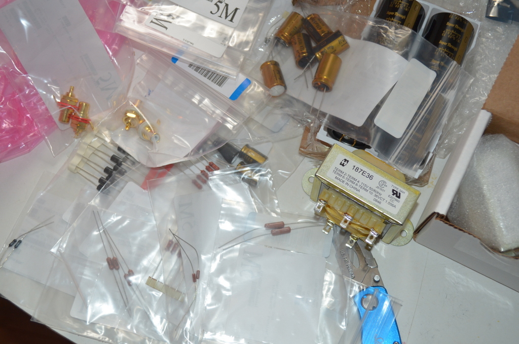

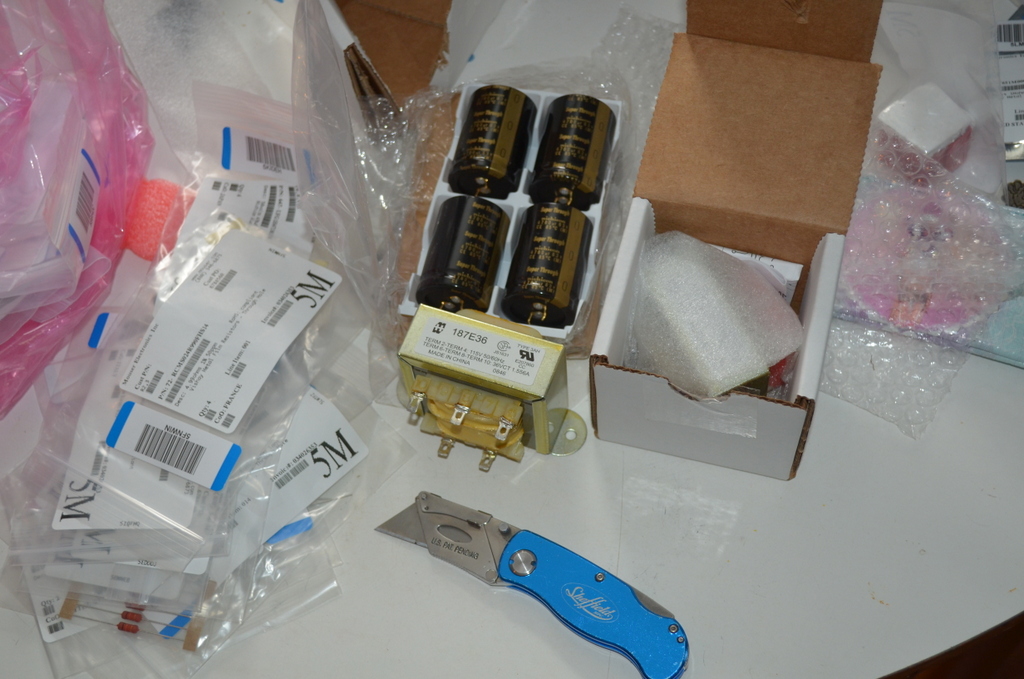

Nice early surprise from Santa, my Mouser order arrived yesterday. That was fast!
Nice collection of parts! But I see you ordered a CT transformer. Why?
36VCT. Its just another way to state 18-0-18V I guess.
