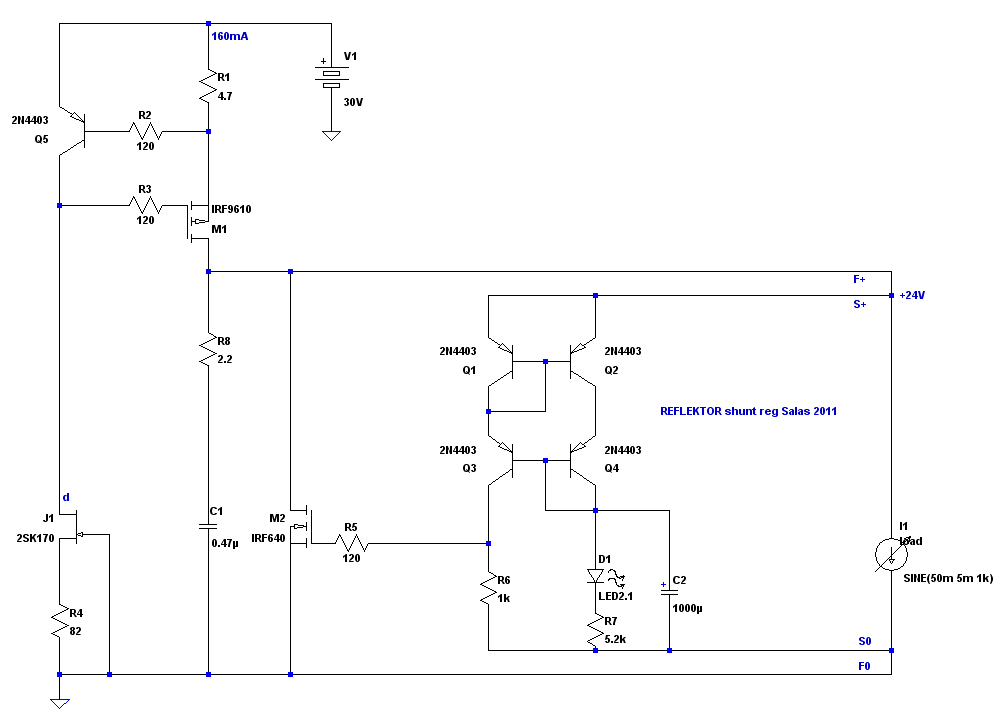

The Reflektor went even less parts meantime. After Ricardo's subjective experiments and some suggestions by me it looks that its 1000uF ref filter can work in nice tone without its PP Cap + small R bypass, if the output cap will go 0.47u and every stopper resistor be 120R. So make it like this if you will ever add such regs, which I highly recommend. I have read the resistors current noise article BTW.
Tanks Salas
Going to order a few tomorow.
I can get Multycomp current gain 100
Or On semy current gain 200 (2N4403G)
Do the transistors need matching?
And how?
