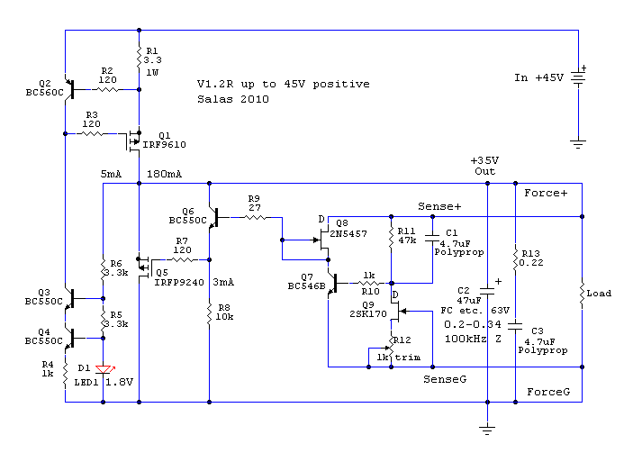

Finally, I'm back on building my RIAA after an 8 month hiatus. Just got components in, I'm starting to layout on vector board.
I have a nice long piece of blue vector board already. Is there any good reason NOT to have the shunt (1.2R) right next to the RIAA, apart from layout flexibility?
Next to each other, I can make the force/sense wires very short- ~ 3" max.
Cheers- Kent

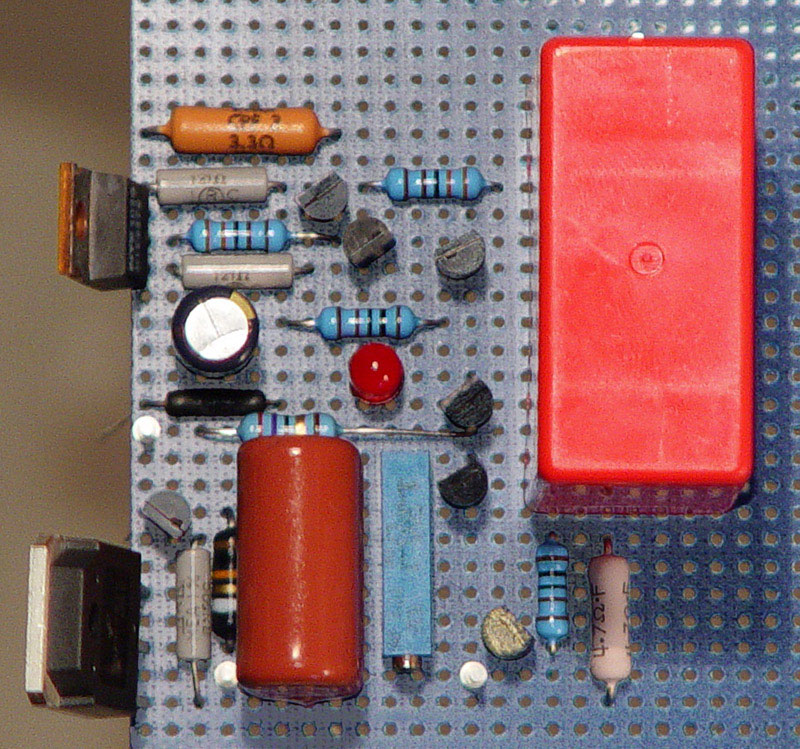

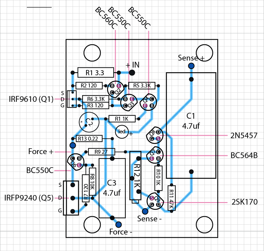

Attached is my test layout on vector board. I am assuming it's OK to use 121 ohms for R2, R3 & R7?
R11 is supposed to be 47K, just changed it. I read from Merlin C1 is crucial for good sound. I have some Wima MKP 4.7uf, laying about; that's the big red cap to the right. The other 4.7uf (C3) is a Panasonic Polypropylene 667-ECW-F2W475JA. Would these be OK for C1 as well?
~3" x ~2.4" (75 x 64 mm) footprint, nice and compact.
OK, will keep C1 MKP and C3 Panasonic. Thanks Salas!

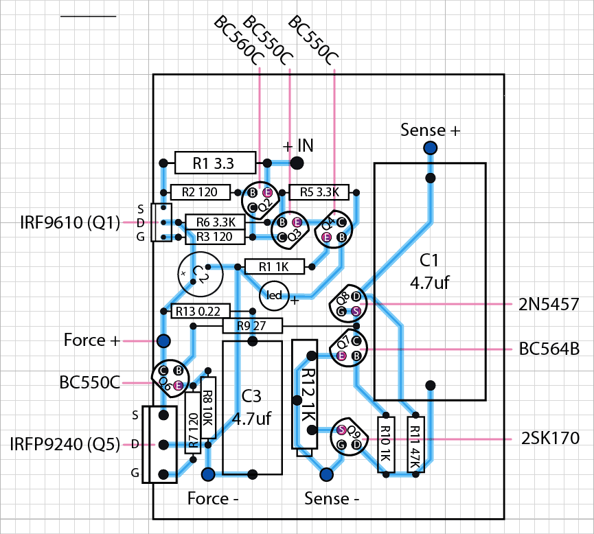

If I can borrow your eyes, here is the final layout for standard 0.1" hole spacing vector board. I've checked it over but might have missed something.
No PS built yet, I'll be powering it up with my bench supply, monitoring current and scoping for oscillation.
What's the best load to test the shunt? I figured 250R..?
Cheers- Kent
Cheers- Kent
