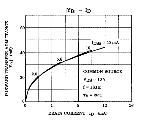

Wich gain have now the schematic I'm using without C10 4700uF, R9 100R (jumper) & C5 470uF?

There is a chart that shows its relationship trend to ID (if ID=IDSS when Rs=0 amounts to the same) in most Toshiba low noise JFETs data sheets. We have referred before here, but I remind for K170.
Hi Salas
From that chart we might deduce a higher Idss jfet has higher transcondutance.
A higher transcondutance means more Volt/current amplification potential right ?
If so, why not use only high Idss jfets instead of the average 8.5mA you calculated ?
