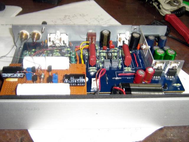

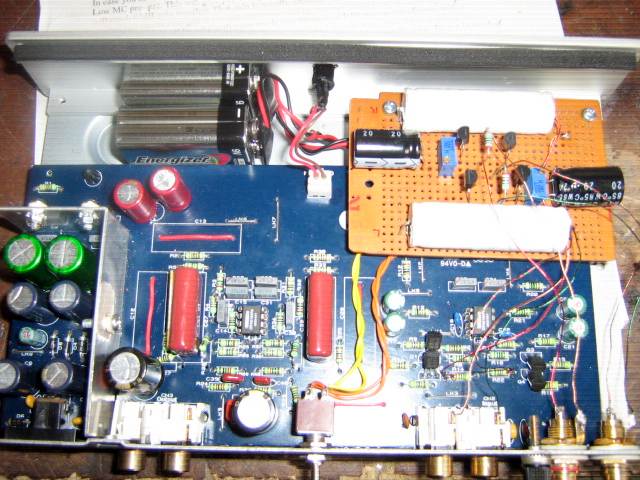

hi Salas, guys,
here are pics of my mod on azur 540 mm pre
not tried out yet though with my mc cartridge and I decided to use alkaline batteries after several attempts failed using existing regulator. Azur's positive rail always going down when MC is on...not good
200R trim-pot for R1 and R5 under the board. Salas I keep the 1000uF caps, is this ok or do I still have to use BC550?. Please let me know if you have better ideas.
thanks (sorry for poor pics)

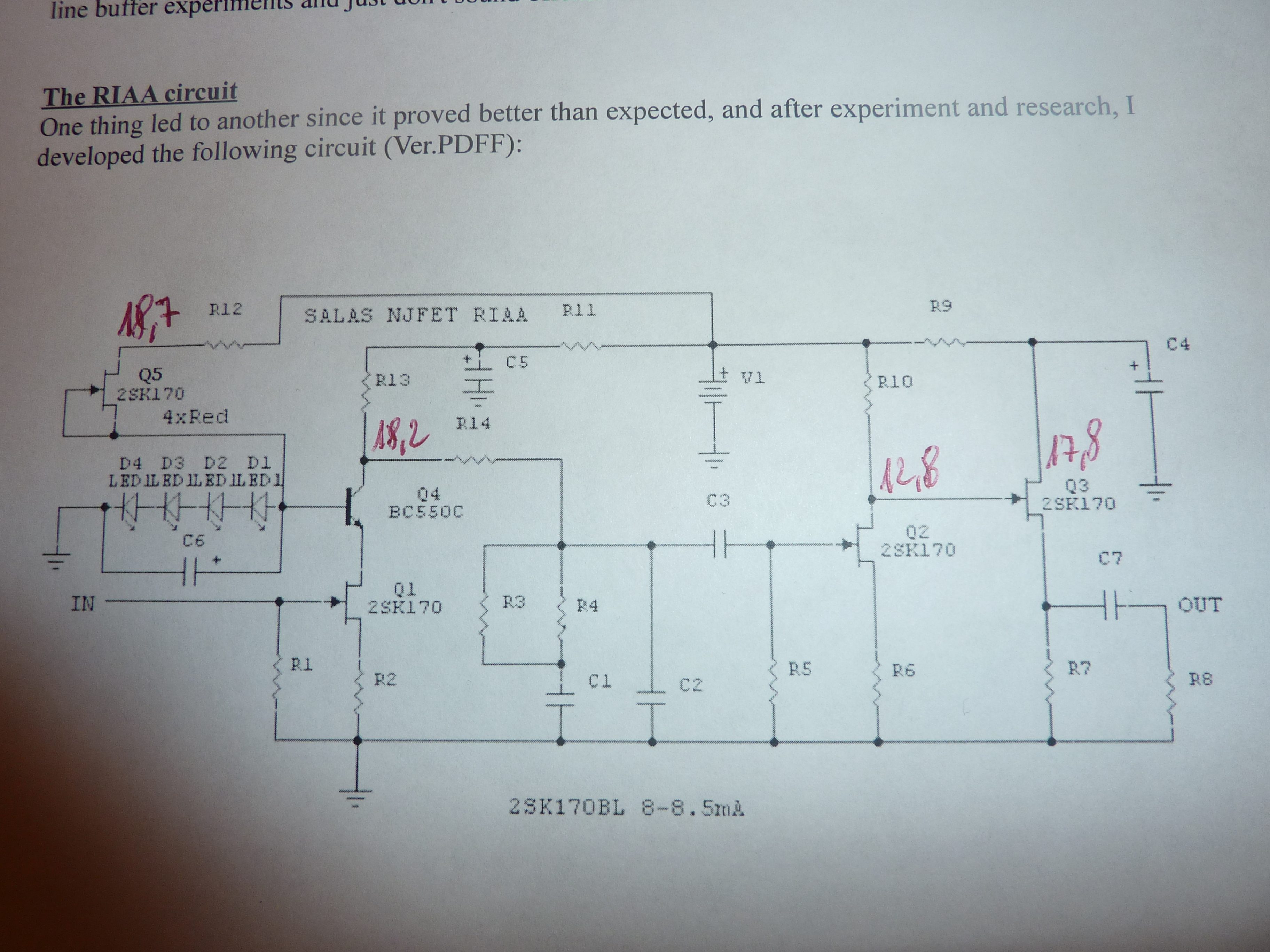

7.5mA is near enough in gain to 8-8.5mA, but weaker dB overall. Post various DC voltages like drains to earth, collector to earth, so we see the bias is still logical if the dB are enough total with your Sowter. If no danger, and dB enough, no worries.
Attached your schematic with various DC Voltages. Inform me if is O.K.
With weaker leds just find R1 value that satisfies the current that you were looking for. ICCS=VR1/R1.
Please, can you explain?
The voltage of the shunt regulator is 28V; i set the voltage with the trimmer, adding a 470 ohm resistor (R = V / I, 28V / 0,06 A).
Regards, Mario.
Its OK, just runs lower currents, its safe. If your gain is enough with step up, don't bother changing the Jfets.
I explain, to find the current that the reg runs in CCS, you divide what voltage you have on R1 (green fat one), by R1 in Ohm. So if it is below target, one way is not to use stronger LEDS (make more V across R1) but to use smaller R1.
Not 470 Ohm, but 4K7 because 6mA = 0.006A. But it is going to be +0.6V, there is transistor's Vbe under it also.

R5=220K terminal resistor, not 200R trimmer. You have to use 550, it sets the voltage lower also. Plus, its not going to play long on batteries. 14mA bias.
