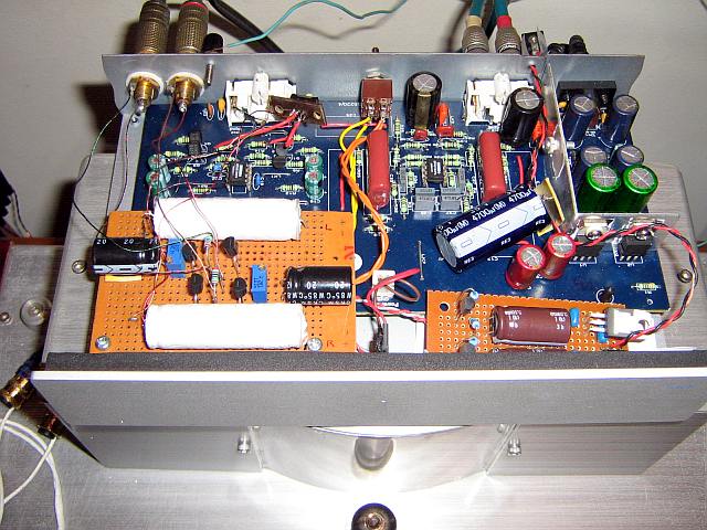

Hi Salas, guys , just a quick update
Tried the 9V batt, I like the sound but humming badly in lower registers. sweet nice mid and high-bit edgy this one. got about 7 LP's with the batt while rudimentary setting up the MC cart.
Using 7809 - 550, hum mostly gone!, I think I missed the sweetness of 9V batt
So my target is to have more tighter bass, sweet- transparent mid & high
Quite a thrill to hear my kiseki blue silver again :D. Thank you Salas ! I still have some questions though he he,
what is the optimum drain voltage? my sk170 idss is 8.5mA, what load is best for kiseki? is bypassing the 1000uF C's with 100nF recommended?
Other suggestions very well welcomed (tracking force, VTA, etc..)
Thanks & here is the pic

Some hum when using the 7809 and 550C multiplier with 1000uF caps, must be no signal shielding, top open, any possible ground loop. Very unlikely to be ripple, you had more hum with batteries, that points elsewhere.
For Kiseki Blue, try 150R load.
For 8.5mA IDSS use R1 (common drain load resistor) 120R. That will bring the gain to 17dB since your cart is not really low MC (0.4mV?) and the voltages right. Maybe you get a bit of roughness due to buzz or EMI or much gain, don't know what sonics the main phono does also.
Use coaxial for signal in-out, at least twist those you have tightly, watch the quality of the 0.47u output capacitor. Close the top. You can play with bypasses on ecaps etc.
good morning Salas, my Rload is now 150R. I will take care of those dangling listz wire strings. I think hum is largely due to mediocre transformer (gets hot even with no load), wiring & open top.
I use 0.47uF K73-16, will play with bypasses for sure :)
forgot this, the main phono sound is tailored for sumiko black pearl, sounds just the way I liked it, only less transparent :)

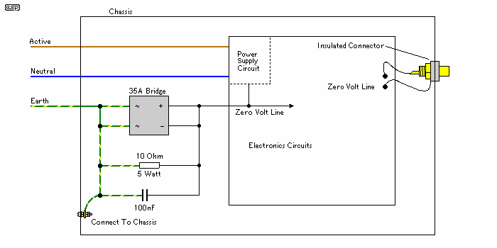

I need to install a gnd lift in my rig.
I found that sometimes it hums, depending on witch system it is connected to. In my system I removed the hum by using an unearthed mains connection.
I am not sure the best way to do it... should I keep the case connected to mains earth and internally isolate the GND from the mains earth or should I keep the case connected to schematic GND and isolate it from mains earth ?
