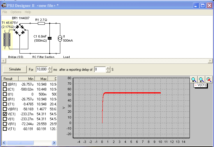

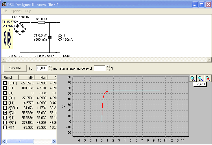

In one of my experiments I remember I used 10R for 180mA CCS on a 63V big filter cap, I wanted not to torture the cap and save on CCS dissipation, and it dropped from near 63V to around 55V. So I will run Duncan PSU now to see if it matches. I have to set a circa 44VAC Tx there, had a 2x21Vac that was stronger than nominal, some arbitrary big enough filter cap...
Here we go. It certainly roughly follows my case, so I simulated your case too, I hope it works for you too. Mind you 10V drop at 0.5A is 5W. 10W part will be very hot. But will stand a test.
10R between diodes & filter caps

Without load that is from as far I can see. Use 2R7 for 500mA CCS or 10R for circa 200mA CCS according to the simulator. To have a voltage drop you gotta have a current draw.

It would only draw around 50mA. To suck 500mA it would need to be 100R and to dissipate 25W. Would need a metal body big one on a heat sink. Like building a Zen amp with resistor CCS.
I would put 10R R1 in a working V1 reg for circa 200mA CCS to test the 10R to Cfilter already installed. If it drops around where you want for DCin to reg given your mains and trafo, I would then set it back to 3R8 R1 for 500mA CCS and use 2R7 15W to Cfilter.
