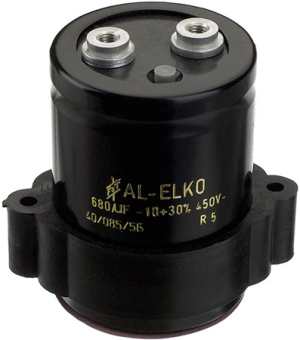

My question was meant about those huge smoothing caps that were pictured a few posts ago. The specs are incredible, and I'm wondering if they really would make an audible difference to my power amp, which is a very much modded Quad 405. I currently use Mundorf Mlytics there. Sorry for going off-topic.

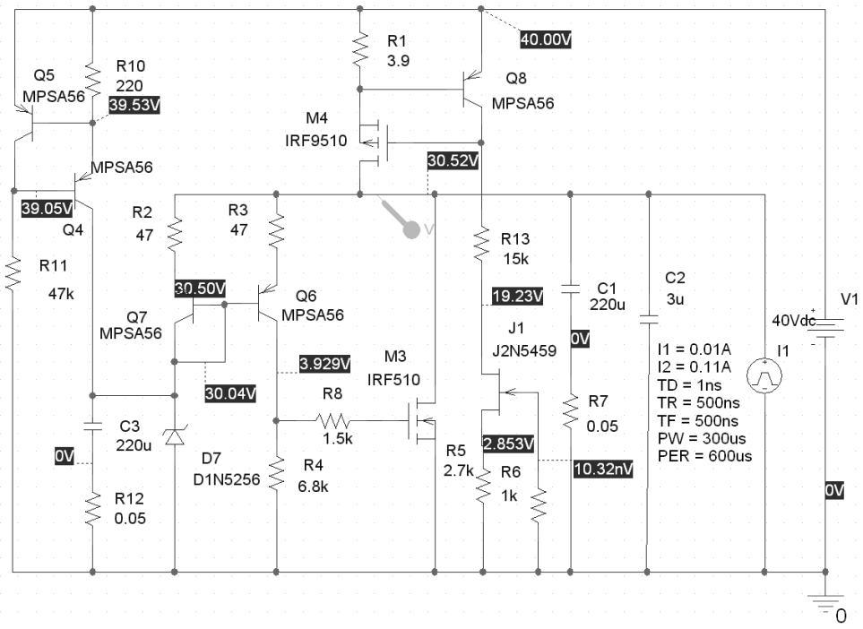

Next pass on the shunt regulator is here. The two transistor current source at the far left is to supply bias current to the zener outside the gain path of the regulator in order to push it up into the steeper portion of its operating curve - less output voltage change with input voltage, higher gain, somewhat less noise. The capacitor across the zener (with added resistor to simulate ESR) provides extra quieting. The JFET current source to the right is used to present a stable drive current to the upper bipolar-MOSFET current source. The PNP transistor in that current source works against the bias current source, determining the ultimate operating point of the transistor in the MOSFET-bipolar current source. Using a higher value of bias current would dictate a somewhat higher base voltage for a given current source set point.
Both current sources could be replaced with resistors, with some compromise in performance. The left-hand source is set at ~2.5ma, and the right hand at ~1ma. The left-hand souce is bipolar to allow greater freedom in setting the unregulated input voltage, as it sees the full unregulated voltage until the cap across the zener diode charges up, but must also operate properly with the zener stealing a good hunk of the voltage headroom. The right hand current souce has no such problem, as it sees a fixed voltage. The right hand current source could also be implemented as a bipolar "ring of two", with the penalty of greater complexity. The resistor in the JFET current source drain drops the voltage seen by the JFET to a safe value, allowing use of a cheapo JFET like the 2N5459. A 5457 or 5458 could also be used with a change in the source resistor. This resistor will need to be picked by experiment for the proper drain current anyway, as the its actual characteristics will vary from those of the simulation.
The bipolar transistors used (MPSA56) 600 ma, 80V, could be replaced with anything with similar ratings.
I changed the main MOSFETS to IRF510 and IRF9510 to prove a point - the smaller FETs work well. Larger FETs will work, too, but will slow down the regulator a bit.
Using a high quality, low ESR cap at the regulator output is key to good performance, as it provides the current for fast transients until the regulator responds to take up the slack. This capacitor also stabilizes the regulator - it likes that big cap on its output. Panasonic FC or UCC LXZ series capacitors work well. Trying to do something similar using only film caps with negligible ESR might compromise stability. I tried adding a modest amopunt of film bypass to the smulation withoput noticably affecting the response. It might be good to add some to counteract the main capacitor ESL.

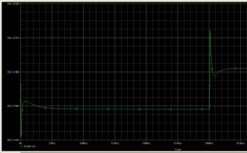

Here's the simulated response - still fast, with no funny stuff. The overshoot and undershoot represent the time period during whch output capacitor buffers the load transient. The initial edge is the load transient working against the output capacitor ESR. The offset voltage after the transients settle out represents the effective output impedance of the regulator. this is about 2 mV/0.1A = 0.02 ohms - not bad for a simple circuit. This is just a simulation, so the results should only be used as a rough figure of merit, but a real circuit should perform in similar fashion.
Great concepts here wrenchone. I like the Wilson current sourcing and the chunky output cap. I sadly miss the discontinued Panasonic HFZ series here. Very fast and really long life. I don't know if there is still NOS around. I would prefer a P-Mosfet at the shunt position, with npn's at its drive. This reg obviously demands a PCB. Technically is well taken care of and will perform closer to ideal. Current sourcing and fine trimming in abundance, still not really deviating from my initial block. 5459 is one of my favorites, and I know that you hate exotic parts. If someone's making the Salas RIAA though, will end up with enough non matching quieter 2SK170 spares to use around. Of course this ''not that simplistic'' but ''I am not scaring anybody'' regulator, must be made and get auditioned by some curious soul. I kept mine under the ''simplistic'' concept on purpose, so it would stay accessible to many more and in sync with this thread's spirit. Heavier Mosfets I used on purpose too, so it won't oscillate easily into nobody's inexperienced hands, especially when playing with favorite capacitors. And sometimes, fast, but not super fast, is lending itself better to DIYers. I can only imagine what it may happen for music if it achieves even +10% additional subjective performance over mine, since the ''simplistic'' already had given roughly +25% to the RIAA VS LM317's.

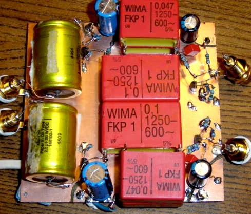

Here's a photo of my first attempt at putting a 'Salas Pacific' RIAA together. I've mostly just used R's and C's that were available at my local electronics store (Maplin), apart from the Audio Note output caps which I had already.
First impressions are favourable. The sound has more body and presence than before. 'Before' was with opamps: The Hagerman Bugle with LM4562s.
Thanks to Salas and all who have contributed to this interesting thread.
