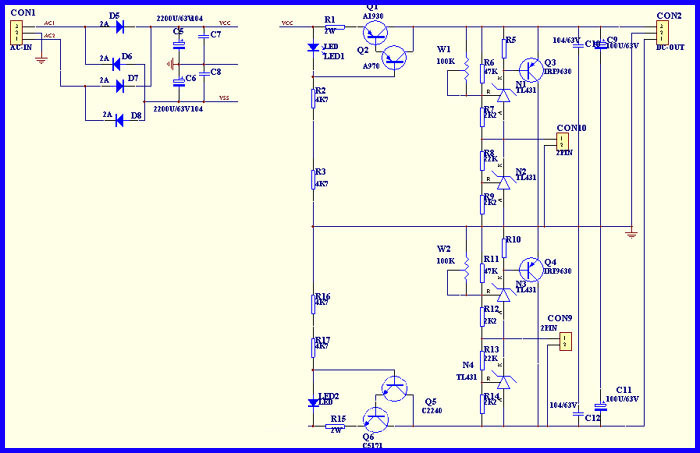

The current source sets the current. That current minus what the load consumes is shunted to earth by Q4. Example: In a 28V B+, buffered Salas RIAA that the 2 channels consume 40mA class A, if you set the constant current at 200mA, Q4 is going to dissipate 28V*160mA=4.48W. The excess current is good for low output impedance and headroom ease. 2 times the static load need for class A is good, 3 to 5 times is royal.

The shunt is basically the one below, except that there's a diode in series with the led and a 2k resistor in series with the pot.
It may look complex at first glance but the schematic shows two rails, with two TL431s in each for use at higher voltage. So CON10 can in effect be jumpered across, eliminating the lower 431.
I don't know what you mean by 'shifted resonance'. Reliability is fine. I'm not aware of a 'sonic fingerprint' - I prefer them to what I had before, which was a SE triode/horn set-up.
Bypass R6, R8 with 100uF low ESR capacitors, its better. Maybe audible too. Your amplifier's working principle is some form of phase shifting to control a resonance I roughly remember from a PA magazine. Hence its strong efficiency. So its neutral sounding in your experience. Like a gutsy T-Amp, or even better? I am interested to know a good solution for many efficient Watt in a good price. Many guys here talk ICE. Heard any?

jonners said:The shunt is basically the one below,
Is that a Chinese kit diagram? It reminds me the drawing style of some valve amp from there, that was overheating on UK mains and had a buzz. We fixed it up on a thread not very long time ago. Also is that a shunt Mosfet on output but portrayed as a transistor symbol?

Jokes aside, the Led Kitsch Shunt only sounds a bit more open in the highs, but I am not quite sure. The problem with it is that you must measure each Led's Vdrop so to know the total and calculate the Rset correctly. Led makes vary. Green ones are more alike with each other but not across makers. The previous one is based on steady transistor Vbe. Also the left hand side 2SK on the Kitsch is not lending it self for more than 40V across it and its noise and dissipation are on the 40V border for a 36V Reg, 43V in PSU. So it is not that DIY friendly or free for higher B+ high gain Riaa versions as the first one. I would say that a really good 220-470uF Cout, is more critical for sound than the Vbe or Led reference. Do as you please.
