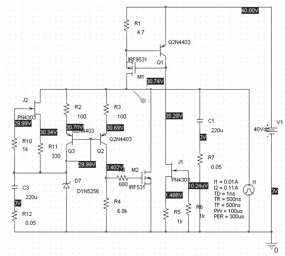

Just one question about your shuntreg: why did you use such a beefy TO247 mosfet for the CCS and the parallel device? It's only 120 mA for the first one and much less for the second. Wasn't a TO220 mosfet (such as IRF9610) enough for this purpose?

Beefy usually sounds...errr...beefy. Plus it will not create instability so easily as a very fast one, plus low Rds On (9610=3 Ohm, 9240=0.5 Ohm). In my initial concept explanation I talked about faster TO220 Mosfets too and that many devices will do. Open to experiments. Also we may run Amperes even if we feel like spending money and space on transformer and heatsinks. It will sound different maybe. Also 9240 has good availability.

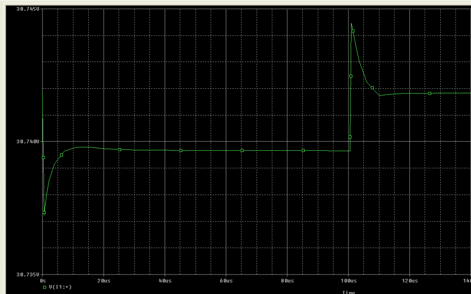

Here are the simulation results. The regultor is fast, low impedance, and should be pretty low noise. Whys and wherefores will follow when I feel like writing them. In the meantime, dissect it into component functional blocks and think about it for a bit.
wrenchone said:Here are the simulation results. The regultor is fast, low impedance, and should be pretty low noise. Whys and wherefores will follow when I feel like writing them. In the meantime, dissect it into component functional blocks and think about it for a bit.

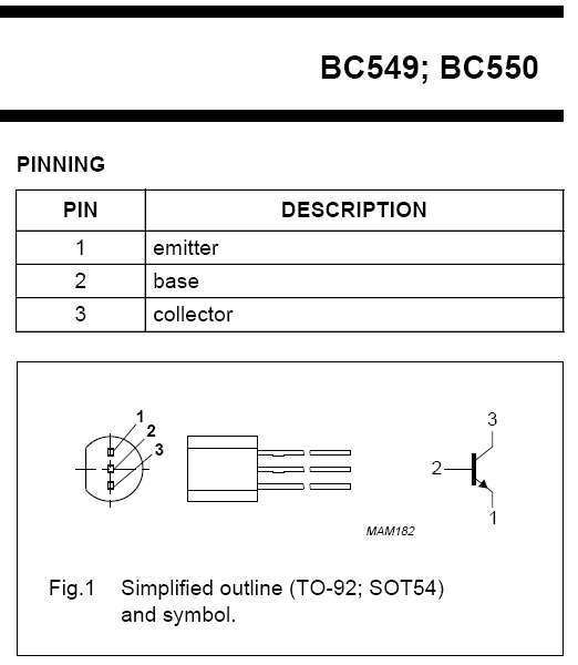

Being pretty noobish, I have a noobish question if you don't mind. I'd just like to check that I have the FET's and transistor the correct way round. Which pins on Q6 are tied together please? And is it pin 1 of Q3 (bc550) that connects to Q1?
Cheers, Lee.
(Confused as to why it won't work)
As you watch the 2SK170 upright looking at its flat face, the 2 right legs tie together for Q6. From left to right, D G S. As for the BC550 see the attachment.
