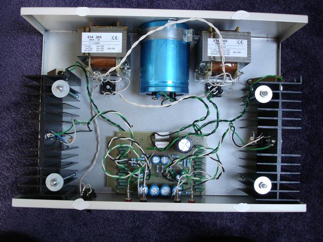

here is the latest version of the prototype of the simplest amplifier. It still is built around the AR-3 circuit. The real headphone amp is smaller in physical size, I have no picture at hand, but will post it as soon as I have that available.

3055
I use 2n3055 and it is fitted on the heatsinks on both sides of the chassis. I use around 25V and 1 Amps. The (power) resistor belonging to the output 3055 has been changed to 6,8 Ohms (25 Watts, also fitted on the heat sinks). The driver transistor was in the original AR3 (if I remember correctly) also a 3055 but can be changed to any other same type smaller power transistor (BD type for example). No transistor in this circuit is critical, you can try anything as long as the power rating of the 'end' transistor is big enough and can stand 1 Amp easily. Sorry not to be more precise but I don't have the complete history of building this thing at hand, in the mean time somebody else is playing with it. Output power is around a meagre 1 Watt at 8 Ohms, but enough for a lot of listening.

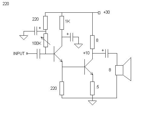

This is my pricinpal suggestion for a simple and good amplifier.
Works in Class A.
The gain in the voltage amp stage, Q1+Q2, is set by (R2/R1) + 1
Output, voltage across R8 at Q3 emitter should be half supply voltage.
R8 should be same as impedance of load, or smaller.
For better efficiency ( more power output )
R8 should be replaced by a constant current source.
With higher currents and power transistors this makes a good Class A headphone amplifier / low power amp.
With only small signal transistors and lower currents
it makes a good preamplifier.

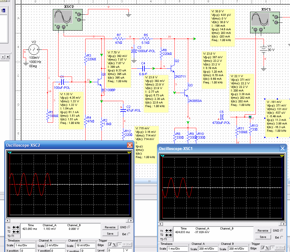

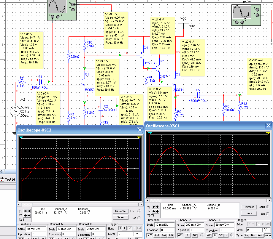

boxedin said:Here is the picture of the my simulation.
I get only 11 mA Ac signal (Peak to peak) going through 8 ohms.
But DC current through 330 ohm resistors is 500 MA dc current. Ca we convert this to AC current somehow?.
Let me know.
Alexk.

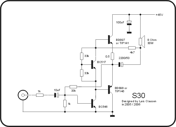

Hi Guys
I have found this thread intriguing. How many times have we heard the trivial phrase: The best solution is often the simplest one. However amplifier construction is clearly an area where this phrase does NOT rule...
Many of the proposed circuits suffer from very low efficiency, very poor performance, very low power, and very poor stability. All sacrificed on the alter of simplification or one might say: oversimplification.
So i want to throw in my 50c, for the simplest BJT amplifier, i can think of, that is not completely useless as a practical amplifier.
It's not very special or unconventional, but it will give a decent 30W of power with good efficiency, and proper performance and stability. (But nothing more). Already i feel like throwing in a differential stage, a thermo stabilization, input resistor for DC plop limiting etc. This would better the performance, and stability remarkably, but on the other hand these are not strictly necessary, and will get me further away from the 'simplest solution'. Anyway like i said, i really don't think the simplest solution is always the best. Take a look

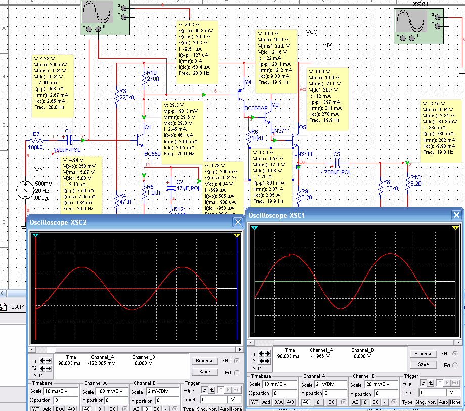

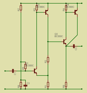

Ok i just modified the rudistor circuit little. Add some modification by adding a PNP Transistor in between.
Here is my simulation output at different frequencies and different Mv input sinewave.
50mv 20 Hz
50Mv20000Hz
500Mv 20Hz
500mv20000Hz
Your input welcome. I do not want to add any more capacitors. But i can replace one value with another. Do not want to add any more transistors.
if you have any input or if you can copy and simulate in your own software and give me feedback. That will be awsome.
I do not use any calculation to design amplifier. I just did copy and paste. So don't blame me. Hahaha.
Thanks for your patience.
Alexk

Simulation works, i have to make this simple Class A amp. If anyone have some tips...let me know.
I have to make +45 V 10 A powersupply to keep sufficient power so it does n't clip. I may also have to see what protection i can add.
Alexk
Alexk

Hello Lars,
that's an interesting circuit. I agree with your remarks, it's all about the balance between simplicity and quality or usefulness. In the end you have a two-stage amplifier and that's quite something for 30 Watt output power (using BJT's that is, with mosfets we of course have the Pass designs which do the same thing).
In fact that makes me think that the real task is to design Pass amps, in the same spirit and with the same straightness of design and philosophy, but now with BJT's. For some reason Pass himself does not see that as an challenge because he prefers fet's for their greater linearity. On the other hand there is a school that prefers BJT's to fets (for instance Rod Elliott if I remember correctley, that's why he called one of his designs DOZ, death of zen).
I also built some Pass designs and they are very good indeed. But then again, just for fun I recently (this week...) built the classic A51 amp from Sugden late 60's, using modern components (2n3055 isn't exactly a modern component, but the impression still applies with this old goodies in it!) and a good power supply: and damn, this thing appeals in some way more than do the Aleph designs, it just sounds more natural, more flowing, more ... maybe more like good tubes maybe. But I don't want to do the discussion all over again, just let's make some simple BJT designs and let everybody try and have fun and listen.
Why do you put the speaker to the + volage rail?
Some specifications would be nice: input sensitivity, idle current, output power at 8 and 4 Ohms etc.
