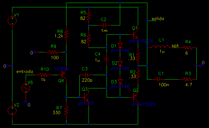

Another way to do this, which will generate more or less a JLH variant, is to combine two halfs of a JLH into one amp, one is NPN and another is PNP, to form a push-pull output stage,, without the use of a phase splitter.
I haven´t built nor tested it but PSpice says it should give 12Wrms into 6 ohms at 20Khz with less than 0,15% THD and +-15V supplies
I use 6 ohms because it represents better the true impedance of a 8 ohm driver
With 1.6A bias, idle dissipation is about 50W so efficiency approaches 25%
This kind of input stage needs lots of DC offset correction so a DC servo may be almost mandatory to make it work properly

It's a standrd AB amp minus global feedback. Why not add the 2 transistor differential and be normal with gfb.
I've built simpler class A's with less comp's then your design, but will always lean towards ab class for ease and quality.
Not really, It's class A with complementary current sources instead of single ended, input impedance higher than 33K and something like 20dB of global feedback using only 4 transistors
Actually I see no point in building such an amplifier, but somebody was asking for simple bipolar/class A/high input impedance examples...

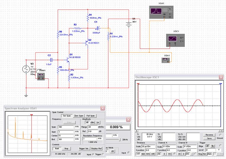

not sure. I had them simulated to generate 4-5v peak. Which translates into 1w rms. You can presummably run it at higher gain (mine was set so that I could use those 12v bipin hologen bulbs as R1).

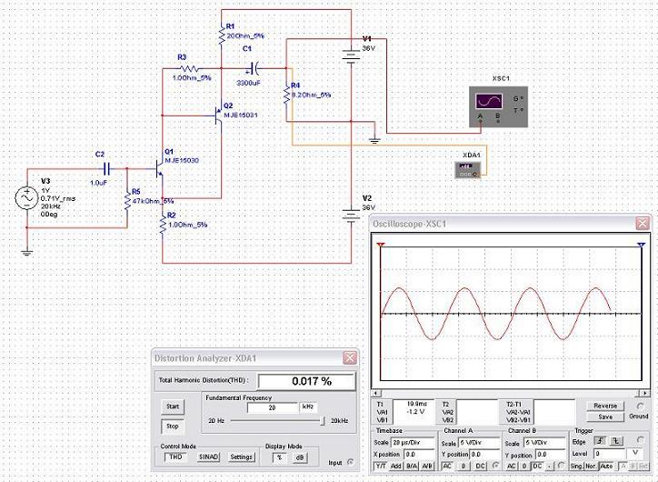

I have later changed it to a 2n5401 + IRF540 circuitry and use a little bit of negative feedback on the biasing circuitry as well: rather than tying R6 to the rail, it is tied to the output node.
This is essentially a SE amp (Q1). R3 and Q2 act like an "after burner" / current amplifier: R3 sense the output current and turns on Q2 to drive the output.
the "feedback" is provided by R2: as Q2 is turned on, it raises the voltage on Q1's emitter thus turning it off.
So it has the benefits of a traditional SE design, but has low Zout (because of R3/Q2).
I haven't breadboarded it yet, tho.
