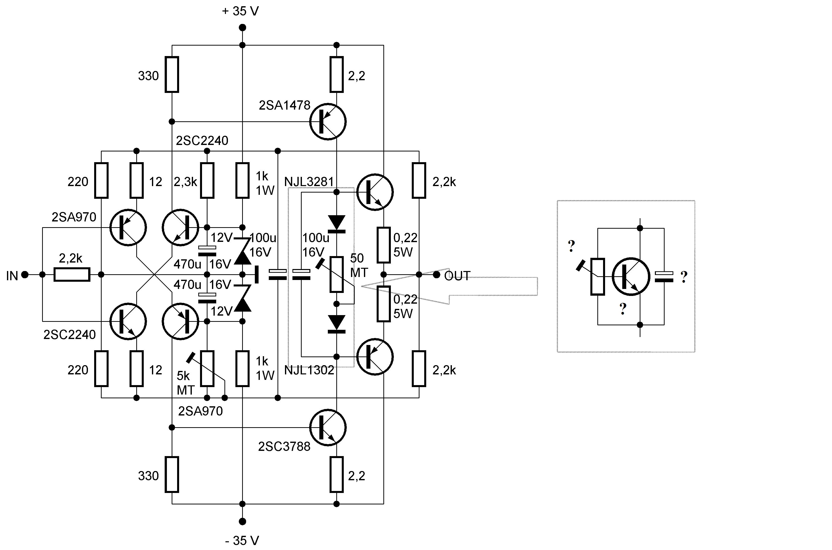

Going to build simplest BJT SSA as attached, temporarily cannot get thermaltrack BJT. Don't know how to calculate the value of capacitor(what is it used for ?seems like bypass signal) & VR pot and any capacitor should work ? (as long its thermal conductivity is ok ? like BD139)
Hope someone could guide me.
Another question is regarding MOSFET and IGBT ( I have no knowledge nor experience using them). Is it able to use any MOSFET & IGBT in place of similar capability MOSFET/IGBT ? (It seems BJT is easier to handle, but interested to use those in future)

Although I have not tried this, I would be concerned that this circuit is 'too simple' because the VAS devices driver the power output devices directly - conventional approach insists that for Class AB you want at least another pair of emitter followers in there. This is why I designed the TGM5 version. On the other hand I have never tried such a simple output and it may work really well.

DO you mean something like my draft attached ? (more output stages) Will this relieve the VAS somehow ? (the emitter resistor value is estimation only....)
Or is there any better implication ?

according to here (about thermal track):
At about bottom of page 2, it written that the trimpot can be remove.... :
Another benefit of the modified circuit is the fact that it can be implemented without the use of a bias trimming potentiometer.
It is true or possible ? this may make the circuit simpler and less component to tweak ? (or will it lead to less area to improve manually? )
