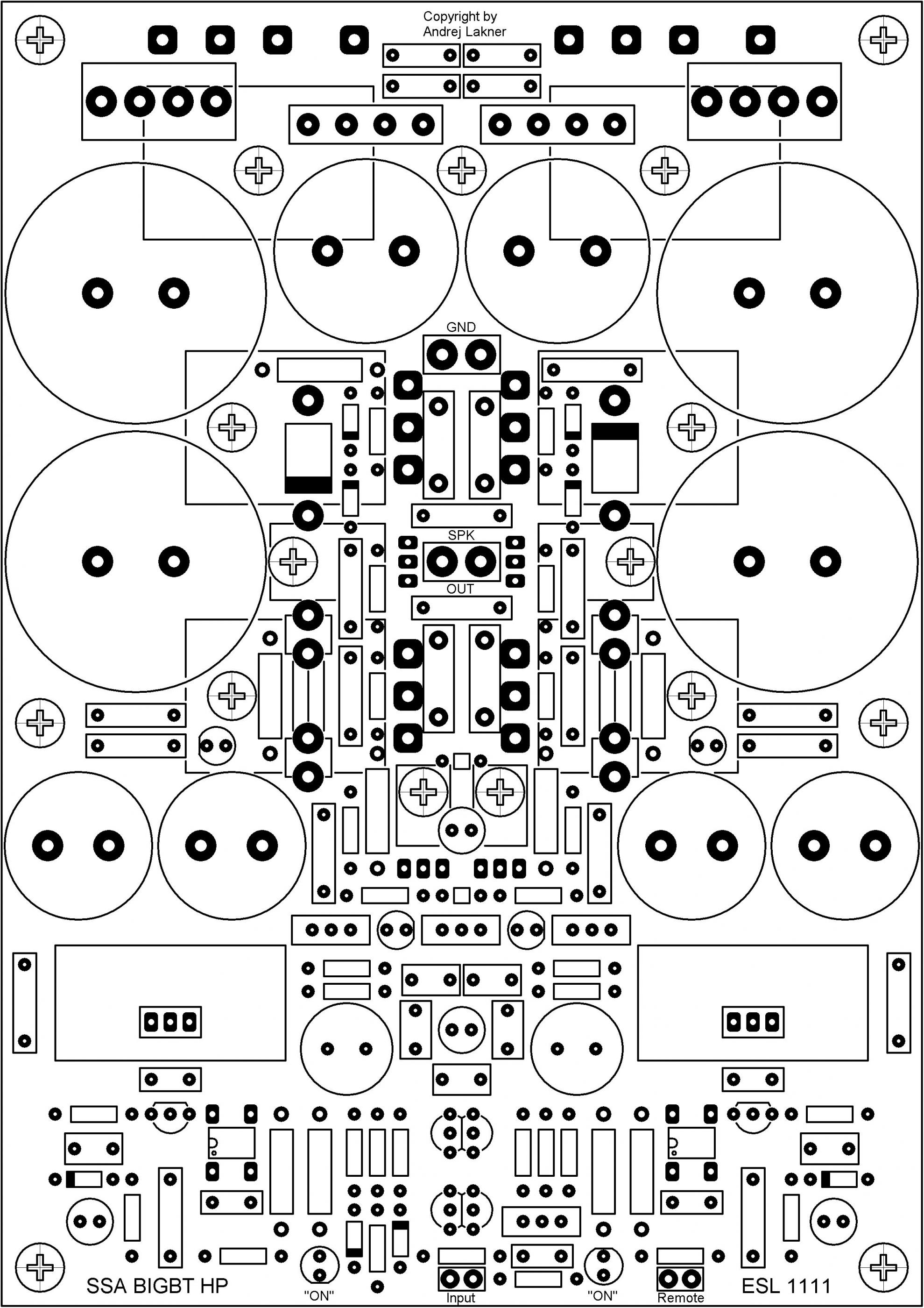

Edit : I just look what sort of standart Pcb board are available and could match with the goal. There is a 150x200mm; i will try to do with this.
... and the components layout is about 95% finished. Some minor changes will take place on the way by routing the traces. ;)
It is definitively not the PCB for the faint hearted DIY-ers. :D

hey, looking great
hmm, I wonder if it also would be a good realiable bassguitar power amp
why 100V caps ?
It could be very fine bassguitar amp driving bass cone directly (active filter), freq response is from DC up to MHz :)
I prepare the space for 80 V elcos, this is only typo, because 100 V has bigger diameter.
Why 80 V elcos? Well this amp is intended to be also 100 W/20 ohm (my horn drivers impedance) so there you need higher supply voltage to get this power on ohm (+/- 70 V rails potential).

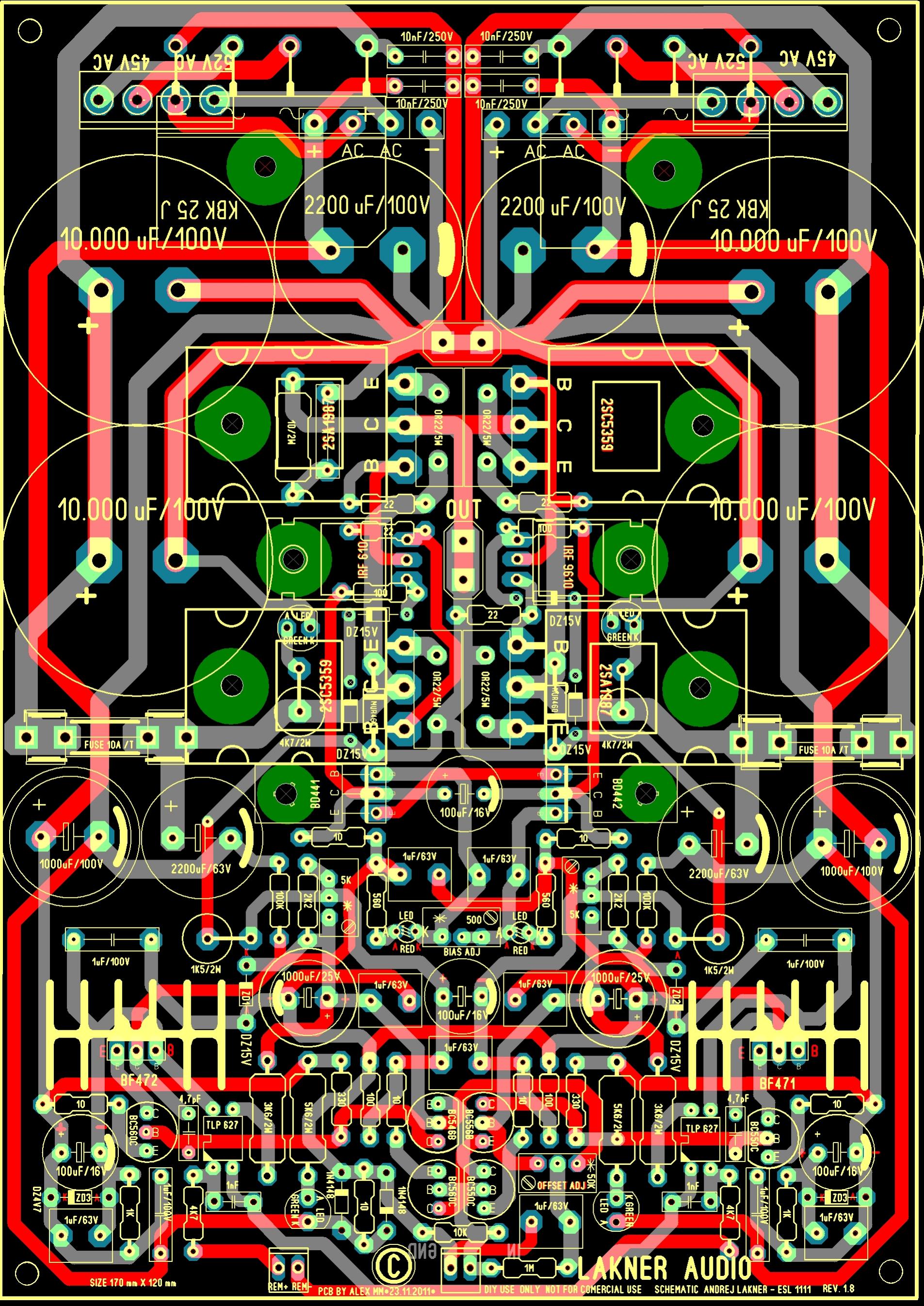

..... PCB ready, size 170 mm X 120 mm , but not symetrical layout :)
Alex.
Hehehe Alex I knew you will made it. Very nice layout very similar to mine expectations. At this point it is the best solution for this kind of SSA version.
Regarding my PCB design I can tell you that after some years in a garage my "PCB train" already left the station and the trains are very hard to stop when started ... :wave:
