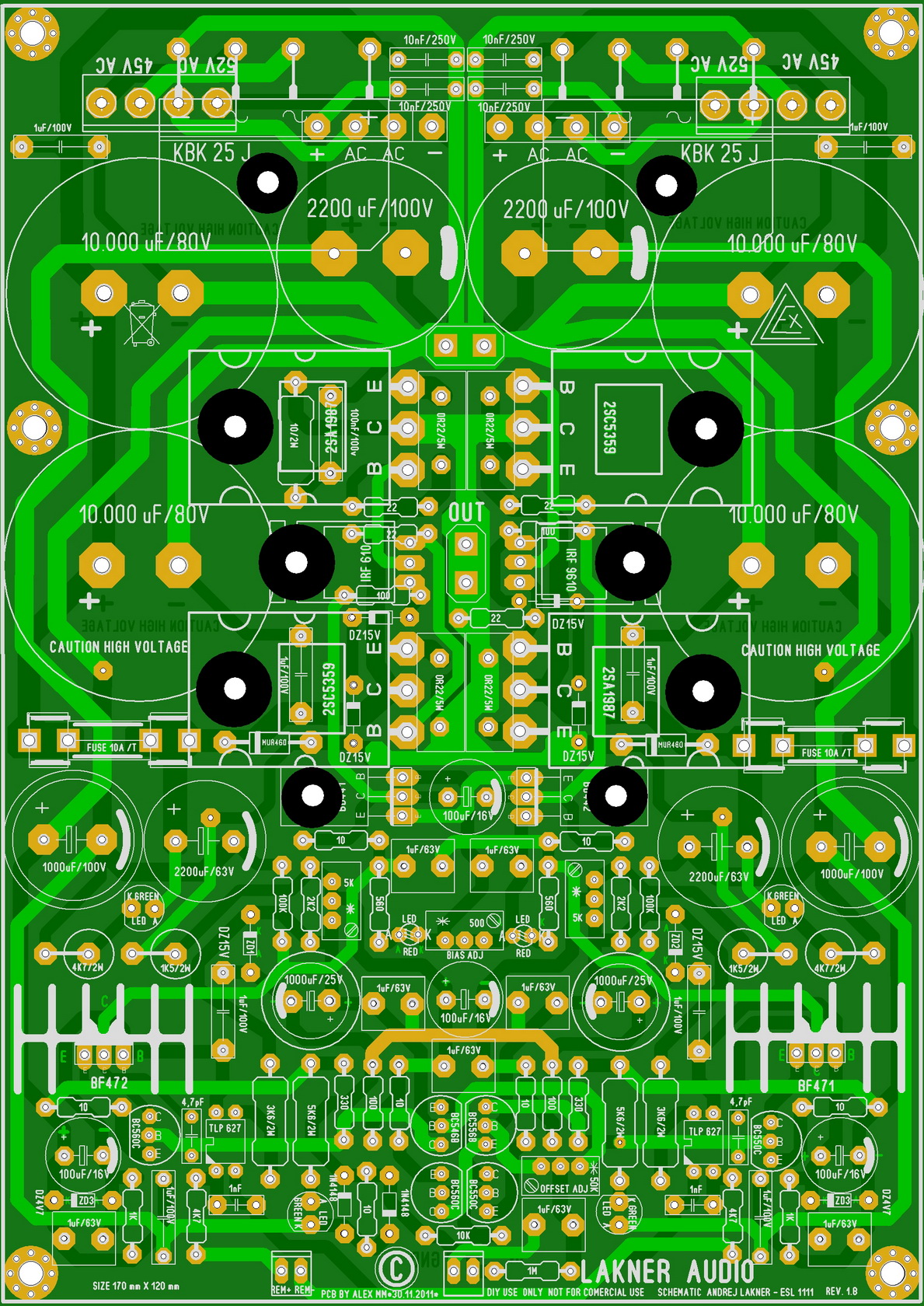

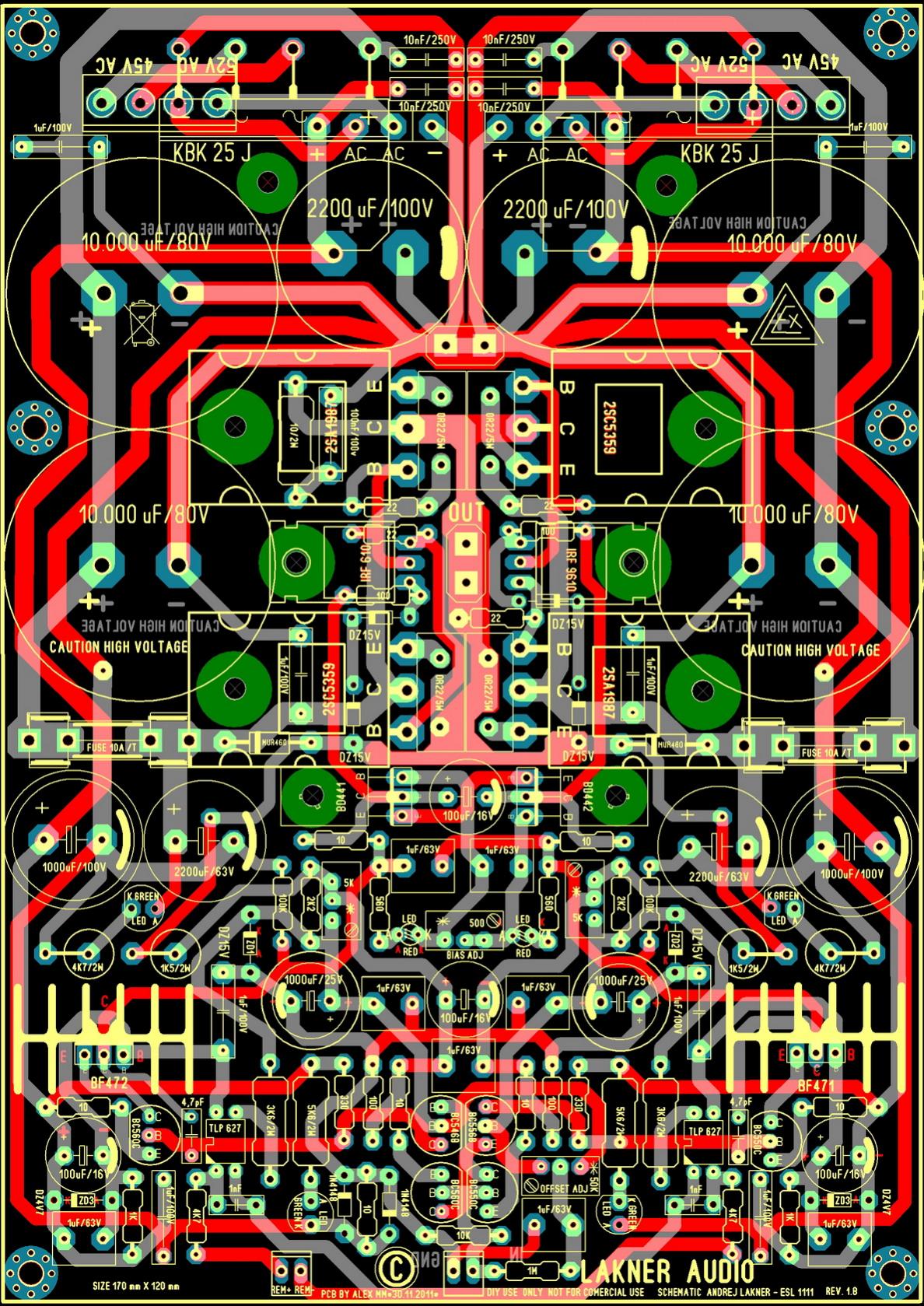

PCB rev 1.8 H
I think now will be the final layout , except if I forget something from schematic :)
Regards Alex.

But I'm in for 2 boards here.
Alex, your design of boards is art, I think that you don't use auto placing of component and auto routing of tracks i think you do that manualy, that's why is art.

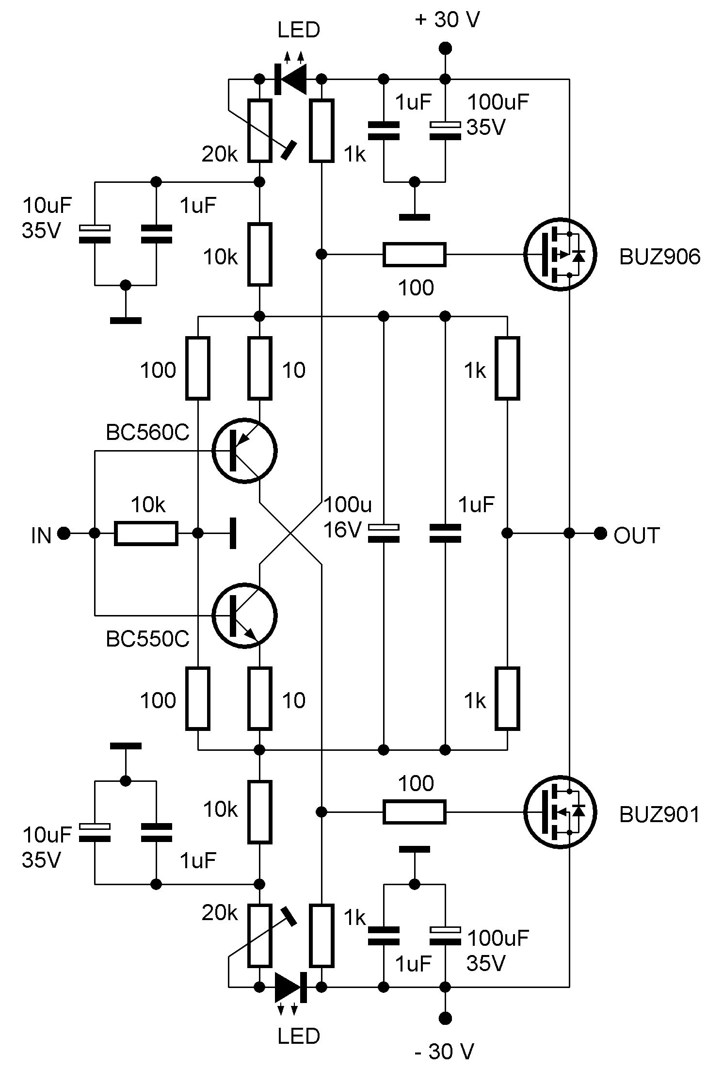

the big attraction for me was the simplicity and low transistor count/cost, and that a pcb may be forthcoming. Obviously something a beginner could make without too much effort and cash outlay. The fact that the design can be used to fulfill many people's needs/wants is testament to a good design, but it would have been nice to start out with the simple design, tested, before going for a full blown monster.
I know exactly what you mean Bryan, that's the reason why I started this thread in the first place. The schematics posted ranges from very simple to complex ones and some unconventional ideas were presented and how to implement them in a simple way. If someone is willing to learn, absorb something about amps, schematics, designing PCB's etc., this thread has also educational purpose to some degree. Many known and well experienced forum members commented, placed their versions of their preferred SSA solution, even started their own threads based on SSA, Alex took tour de force of the PCB designing with so many SSA PCB-s that never happened before in a one thread ... :)
So Bryan if there is a beauty in simplicity, here's the simplest SSA version of them all just for you. ;)
Best regards, Andrej :cheers:

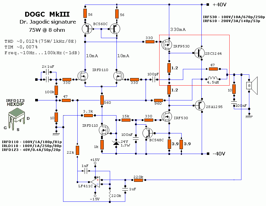

10Hz ----> 100KHz
Somebody would ask himself, why on this world he is performing 2 MHz testing only, what intriguing reason for that it would be? :eek:
Well, 2 MHz is only 100 times more than 20 kHz and according to my opinion, if we want to produce uncompromising power amplifier at least that 100 times higher bandwidth conditions must be well defined, only than we could expect everything is perfect inside basic 20 Hz-20 kHz bandwidth. :cool:
What I came up until now is included in the updated SSA BIGBT HP schematic. ;)
Enjoy, Andrej :spin:

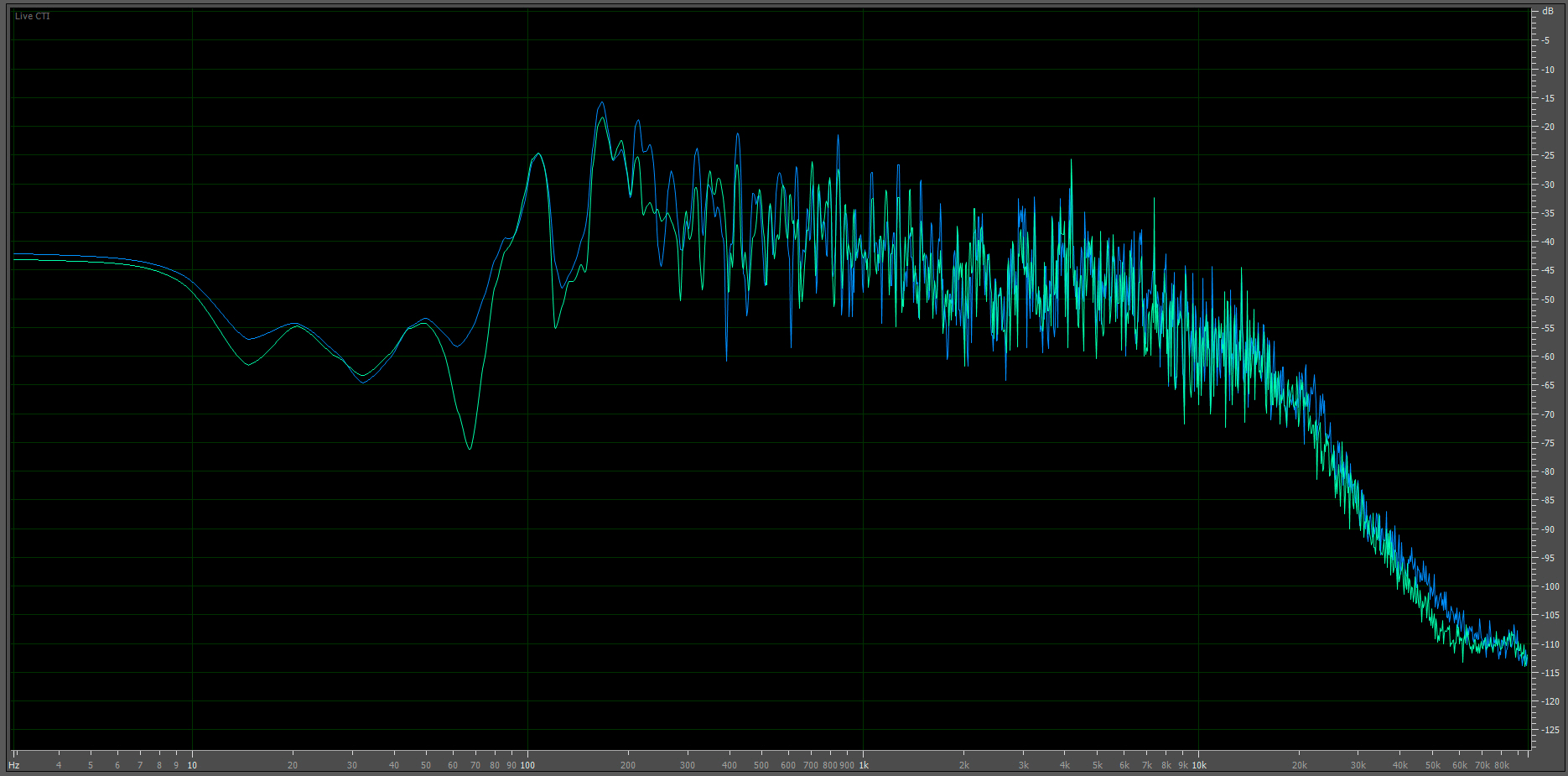

Andrej,
Your's explanation of the BW needed for the most accurate sound playback is one of the most correct one anyone ever mentioned here in any of the playback need debate.
I wonder if You please change the (SONY-constraint "Deaf" stereotype -20Hz-20KHz) and live it in the dust, and please accept the "more realistic" one from what is really happening in the real life-like classical concert music event... :yes: 10Hz -100KHz bandwidth.
I'm sure You'll agree the more super-sonic informations in the music source the more pleasant -life-like it is, and :wiz: Yours AMP-design philosophy is the proof of this concept.
When as much real music lovers will realize and hopefully have the chance and experience with "real" Hi Res. music sources, (not just money-grabing UP-Sampled ones) they will get the feel for the "must" need to obtain the "real Hi-Res recorded" sources with as much super-sonic informations possible, .. all the rest inferior sources (CD-MP3) would be of no valid need any more.
My wish is to happened this to as many music lovers to at least once experienced the "real feel" of a true life-like event at his own homes, I'm sure, after that experience, the wish, to go back to the red-book constraint would be minimized to minimum-mostly to un-awaill. sources only.
Right here Yours Amp design philosophy come in in it's all real valued (now hidden) potential.
I do much appreciated Yours will to give the music lovers a chance to at least listen by them self what is really important and needed for the best possible natural recreation in an amp - music playback.

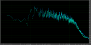

For anyones to see this graphically I attach the img. (DSD-1bit-5,6MHz Fs) with the recorded real live piano playing - (super-sonic characteristic) which clearly shows that the music informations existed well below the current (DEAF-red-book standard 20Hz-20KHz) it is actually present all the way to the 60 KHz, the mechanical limit of the rec. mic.
