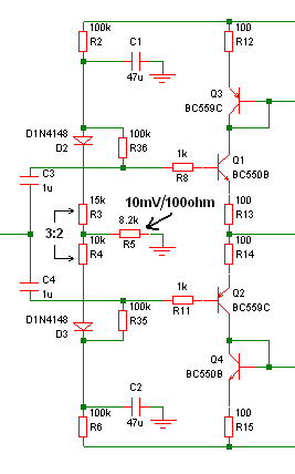

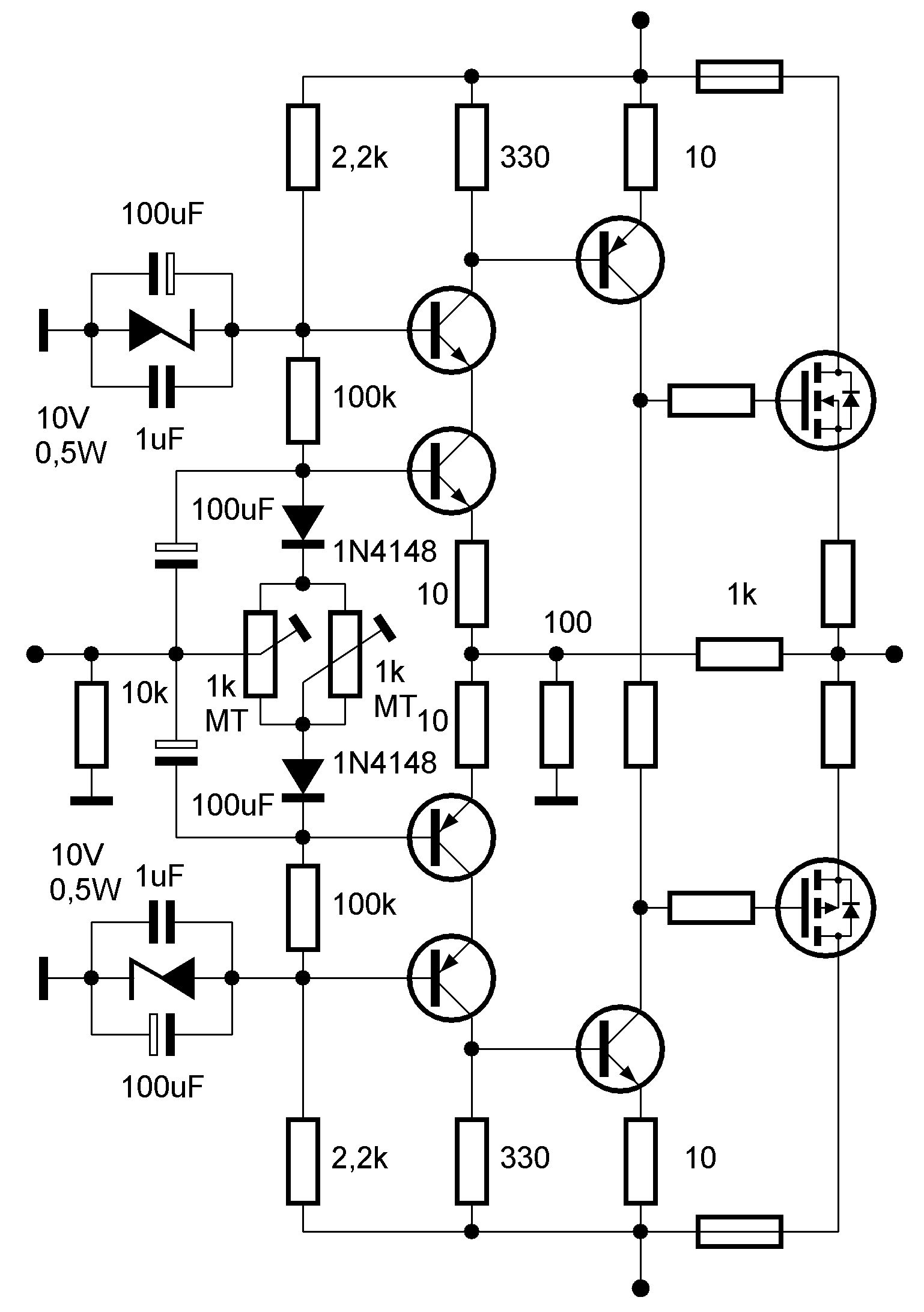

However, I have reached a solution to this problem while using only one pot for offset, still at the input, decreasing slider sensitivity, decreasing parts count and increasing input impedance and power bandwidth. Current through the input BJTs are 5.5mA and 5.8mA. I am attaching the input stage. Please comment.
What I found is that the offset is best controlled at a specific ratio of the resistors R3 and R4. For my instance it is 3:2 and I'm going to test it right away with a 10K pot in place of R5.
Then R3= R4=10k and between us a 4.7k pot with the cursor at ground ? It will go for an other pair or an other amp ?
And why to keep D2 and D3 ? If you want to keep them to filter, they would be better between R2 and C1 & R5, C2

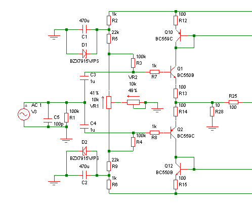

Finally, got what I needed! Fine tuning of the offset.
The idea was really simple, I wonder why I didn't think of it first!
VR1 and VR2 is both 10K.
VR2 has about +-500mV offset control over its 10K range, i.e. 1Volt.
Started with both pots at 50%, set VR1 first to about 1volt, then VR2.
That's all and it worked!
However, offset is still dancing between +-5mV.

+/-5mV is really nothing, what matters is to look at this in freq domain. Look what I posted to you a while ago:
So for the begining I suggest you to place 15V zeners in parallel to C1, C2, replace VR1 with two 1N4148 + trimmer in series and certainly "must" is thermall coupled input NPN/PNP pair. That would help DC bias conditions to be much more stable.
For a sensitive/high impedance input DC bias control arrangement you need a very stable DC supply rails, so two 10-15V zeners are essential.
DC servo, forget about it.

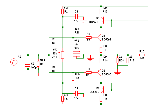

Please try something like this for the input arrangement.
SSA Full Balanced Input
Schematic will explain everything.
What we got here is full balanced input with symmetrical input impedances for positive and negative input and at top of it in current feedback loop arrangement, with minimal parts count.

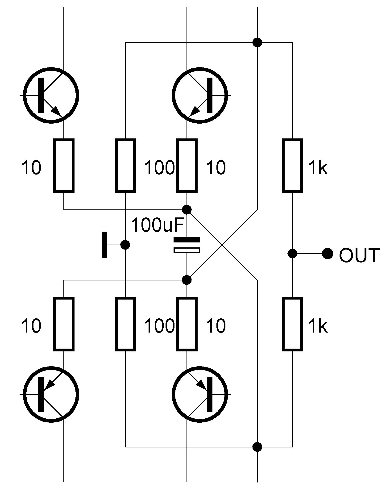

See attachment, that's what you means ? I just wonder why you want me to change the emitter values from 150 ohms to 10, it increase current and open loop gain, right ? it need 4watts for the 330 ohms then, and, if i'm correct, the gain will be 33 if 330ohms are set to 660 now ?.
Where did you see this 100µF, where i have put the 1000µ ?

I see no problem in combining these two together since they operate in logical order. With proper parts calculation such amp would work without any problem.
Will do. ASAP. Looks VERY interesting.
This really works! Although I am not using diodes at pots because of high dissipation in input pair, adding zeners tamed the offset even more!!!

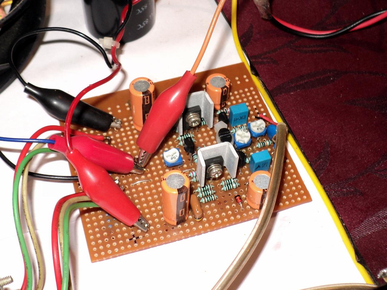

I know i am annoying but I am nearly finished with this amp, so the last and important question 1K trimmer is for bias wright?
2K trimmer is for DC-offset at powering on 2K in the middle position?
1K full counter clockwise for minimum bias is that OK I don't wont to mess up at firing on for first time

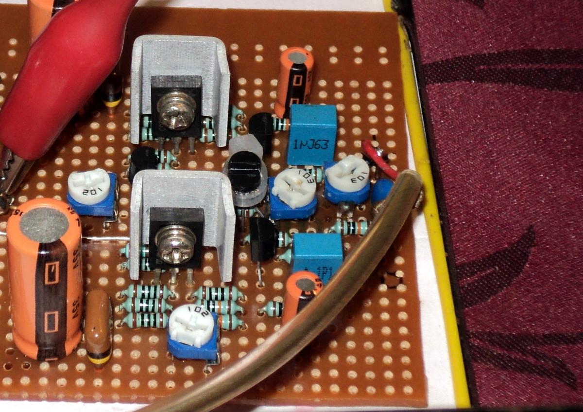

2k trimmer starting position is at 1k value ie. middle position. I recommend multi-turn trimmer but this one has to be measured with ohm-meter at 1k because you don't see middle position.
1k trimmer starting position is zero ohm between base and collector of Vbe NPN transistor. It is visible at normal 270° trimmer but has to be measured with ohm-meter if you use multi-turn trimmer, which I again recommend.
OK, very nice. When using diodes, trimmers values should be drastically lower. Ie*Re*2=10*Ib*Rtrim is orientational formula which could help in diode arrangement.

Yes, perfect design. Just i wonder why you want me to change the emitter values, 150 Ohms origin to 10 Ohms. About the 100µf, i don't know, it is still flowed with a current source that i will upgrade with a Zener.Schematic will explain everything.
I'm very happy with this, as it demonstrate how easy it is to mody any architecture in CF with this nice idea to separate the CF in two. And, on my amp, you can run-it unbalanced, simply in removing the negative parts: saves 2 transistors and 2R.

Omiting cascodes will certainly impact the sound signature because the input pair dissipate more power also Cbc will influence the freq transition greater than in the first cascoded version.
I'm not understanding this.
More power dissipation - why is that bad ?
I don't understand why Cbc is going to have much influence since unlike the VAS there isn't much of a voltage swing on the collector of the input devices ?
