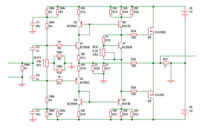

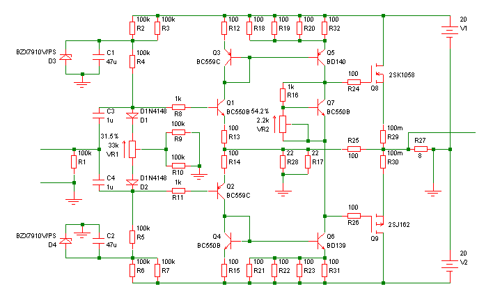

Please comment on the following design. Anything and everything is welcome.
I am about to build it, so creative suggestions would be appreciated.
Thanks in advance.

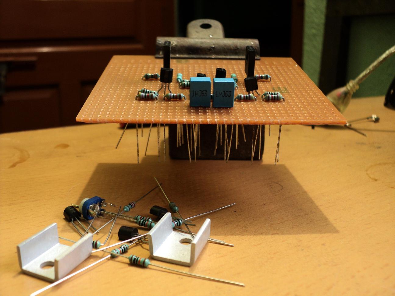

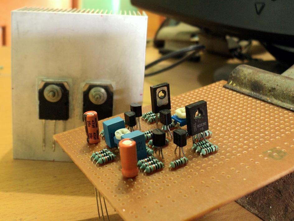

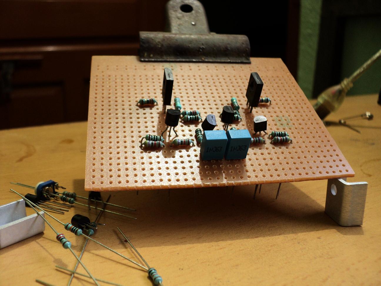

That is the main point. As you see, I'm already on it! We'll see it working within a day or two. I am very excited with this design, I'll be happy even if it instantly oscillates and explodes! Then I'll make a second one. :joker:
Don't worry I have 500mA fuses.
THANKS for the encouragement.

I lack the following resistors:
10ohm
33ohm
47Kohm
But have a lot of 22ohm, 100ohm and 100Kohm. After adding my laziness the prototype has become totally resistor-ed. But the values are now 11ohm, 33.4ohm and 50Kohm, which, seem to have no influence on the simulation result other than tiny gain decrease. I still lack a 33K pot, have a few 100K pots, so, maybe, ......... Noh, not a good idea; three of them will eat a lot of space-time and I can see that setting offset with them will bring hell upon me. I shall go to the shop this evening.
Picture shows the circuit I decided upon. In all my previous amplifiers the resistor-capacitor ratio was never this high. If this dude works then I'll try to make this ratio close to infinity, in the next version.
Also I plan to add a 1Kohm pot in series with the 33Kohm pot at the input. As it looks like offset voltage change is very sensitive to slider movement.

Hi kp93300 ;)
Good decision to built SSA mosfet output version. You'll be awarded with very good sound coming out of your speakers.
Take BL grade 2SA 970 and 2SC 2240 and make sure that the input NPN/PNP pair will be flat-to-flat thermally coupled - very important.
At least you check Vgs at 100mA drain current from both N/P devices. They should differ not more than 25%.
Regards, Andrej
Nice proto board built, almost looks like it is ready made PCB.
Because in your sch you provide DC bias conditions and signal drive at the input (high impedance arrangement), everything is much more sensitive to all kind of influences (thermall, potential instability/unsymmetry, ripple, RF, part's noise ...).
So for the begining I suggest you to place 15V zeners in parallel to C1, C2, replace VR1 with two 1N4148 + trimmer in series and certainly "must" is thermall coupled input NPN/PNP pair. That would help DC bias conditions to be much more stable. ;)

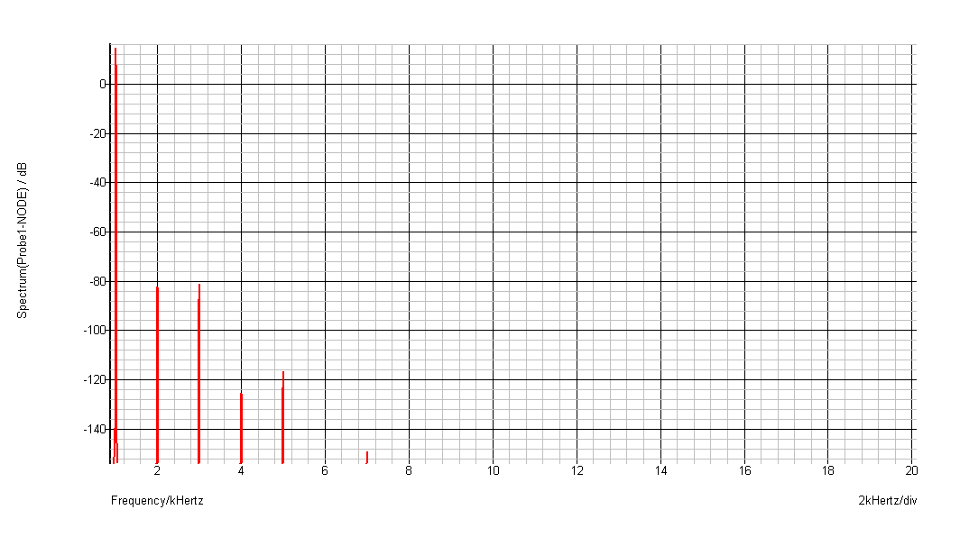

Wow, thanks for these points man! You may be lazy, but you are a very kind cat! :D
Adding the diodes, I noticed improvement in offset behaviour in the sim. Also they reduced the Iq of input and VAS, so added another 100ohm(you know where). I will thermally couple the two input BJTs. Also going to add zeners, makes sense. The voltage around the caps are 13.5V, so I thought 10V zeners would do it for me. Is 10V okay?
I added the distortion graph; before adding the 1N4148 diodes the third harmonic was almost 5dB higher than the second. Now they are equal in magnitude(Hope the reality be the same). What is causing it? Less Iq in input BJTs? Or better balance in Iq? I see that the current through them is +5.1mA and -5.8mA. Before adding the diodes it was +11.5mA and -13.3mA.

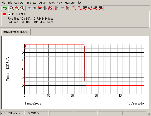

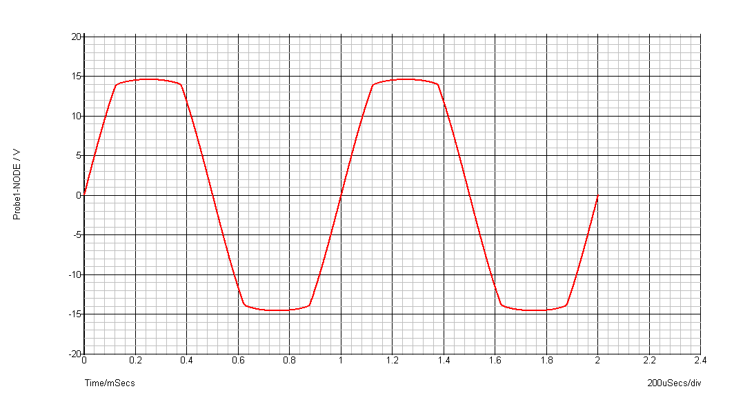

I have a couple more questions regarding the sim results. Here they are:
1. The clip pattern in the third picture looks like soft-clipping. Is it really so? If it is, then which part of the circuit is causing it?
2. Can you please give me hint to the slew rate from the fourth attachment? Or is it not the right graph? If not, then please tell me how to calculate it.
Sorry to ask so many questions. Thanks in advance.

I re-arranged the components according to the points in your last post. I did so immediately as it made too much sense to me.
Esperado too mentioned that, IF the signal source has no DC, then I better go your way. I totally understand, But, my xover doesn't have caps at output and I don't want to add one. My preferred config is preamp to vc to cap to amp; saves headaches and I can concentrate on only the pot at the input. I already have two caps here at the input and have to get some decent film types for this app(provided it sounds acceptable initially).
