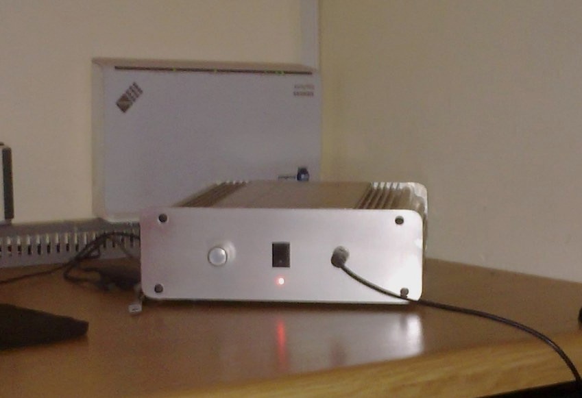

I posted few pics from the experimental phase of basic SSA, now I am in the phase to test high performance version and pics will follow. What I am after is an amp with no more than four outputs, capable of delivering some 100W and to have the best sound as possible (to mine subjective taste). I am not in a rush to make it immediately, now, that is even better since I love fiddling around the electronics stuff. The goal is always important but the road getting there is offering much more fun. :cheers:

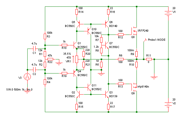

Please comment on the following design. Anything and everything is welcome.
I am about to build it, so creative suggestions would be appreciated.
Thanks in advance.

Shaan,
Nice circuit.
I would, however, delete Q10 and Q11 and simply link CE on Q5 and CE on Q2; this will create the current mirror you need here.
However, why not simply delete Q10/11 as above and also Q5 and C2, realying instead on conventional base drive on Q6 and Q3? This is simpler, and saves four devices.
I'd suggest you run Q1 and Q4 at around 4mA each and change R14 and R15 to around 150R. I think R22 is probably not required either; replace R1 and R2 with a single 8K2 resistor, insert a 220K ground referencing resistor at the upper output of the siggen, and alter the upper 47K resistor of R3a/b (see below) to set output offset. R20 and R21 would then be around 68R each.
I would also split R3 and R4 into four 47K resistors, with a large electro from the junction of the 47K resistors to ground to decouple the input bias network from the power rails.
The output stage will work very nicely but you won't need a bias generator - just a variable resistor - if you set output quiescent at more than 200mA.

Hi
Replace R3/R4 with CCS, a few mA at least, adjust R1/R2 to accommodate bias. Take the input to R22. The mirrors with the helper transistor should be fine just add a resistor from the emitters of Q10/Q11 to the rails. This way they are conducting more than just the tiny base currents of Q's 2/3/5/6. Maybe a base stopper for Q3/Q6. A practical design might include a zero (~30MHz; 120R in sereis with 47pf) from gate to drain of the output mosfets.

I've explored a couple of options in the simulator.
Attached first/left is the same version I posted above for an all-BJT version. [Note that my amplifiers are named TGM1, TGM2 etc. and as this is my 5th amp I'm labelling it TGM5]. It's a simple double EF output with the LazyCat SSA input. Works like a charm in the sims. No turn on bumps either. I take my hat of LC for this simple solution for symmetrical CFB.
Attached second/right is amodified version, I've taken the cascode devices and flipped them to the output stage. The result is a CFP driver. This design is now effectively a simple symmetric version of my TGM3 amplifier. The high current zener bias stage disappears and instead the feedback node is biassed from the rails (suitably decoupled). Is this still the SSA anymore if I do that so the question is - just because I can, does it mean I should ?
The CFP driver reduces distortion for both versions of the front end.
My simulations show the need for compensation - at the least it requires miller compensation on the VAS. It doesn't need much and the OLG retains an extended region of low phase shift - this thing really is a vhf amp.
Lastly, I noted in my sims that H3 is slightly higher than H2 - contrary to what has been reported for the LatFet output version. I expected a symmetric amp to have more H3. I can only assume, still, that higher H2 comes from device mismatch.
Now, if you look carefully at the 2nd attachment you will see asymmetric emitter degeneration of the input pair. In simulations this provides a nice touch of H2 without any other detrimental impacts.
Nice you have stumbled upon one of the circuits Ive used for nearly 20 years. The circuit will sound very good even without the H2 injection. The only difference is that I use feedback from the vas only, CFP vas and the output stage is openloop. Its my favourite headphone amp too although the vas is the outputstage. This circuit was first used by JLH circa 1976 and in its simplest form can be seen in the JLH MC preamp, Rega has also made use of this circuit. The higher H2 from Lazycats circuit comes from the input transistors being biased at lower Vce and because of the early effect causes higher THD especially H2.
Have a look at Lineup s posts of a couple of months back, there he shows the simplyfied version of this amp in a thread he started.
