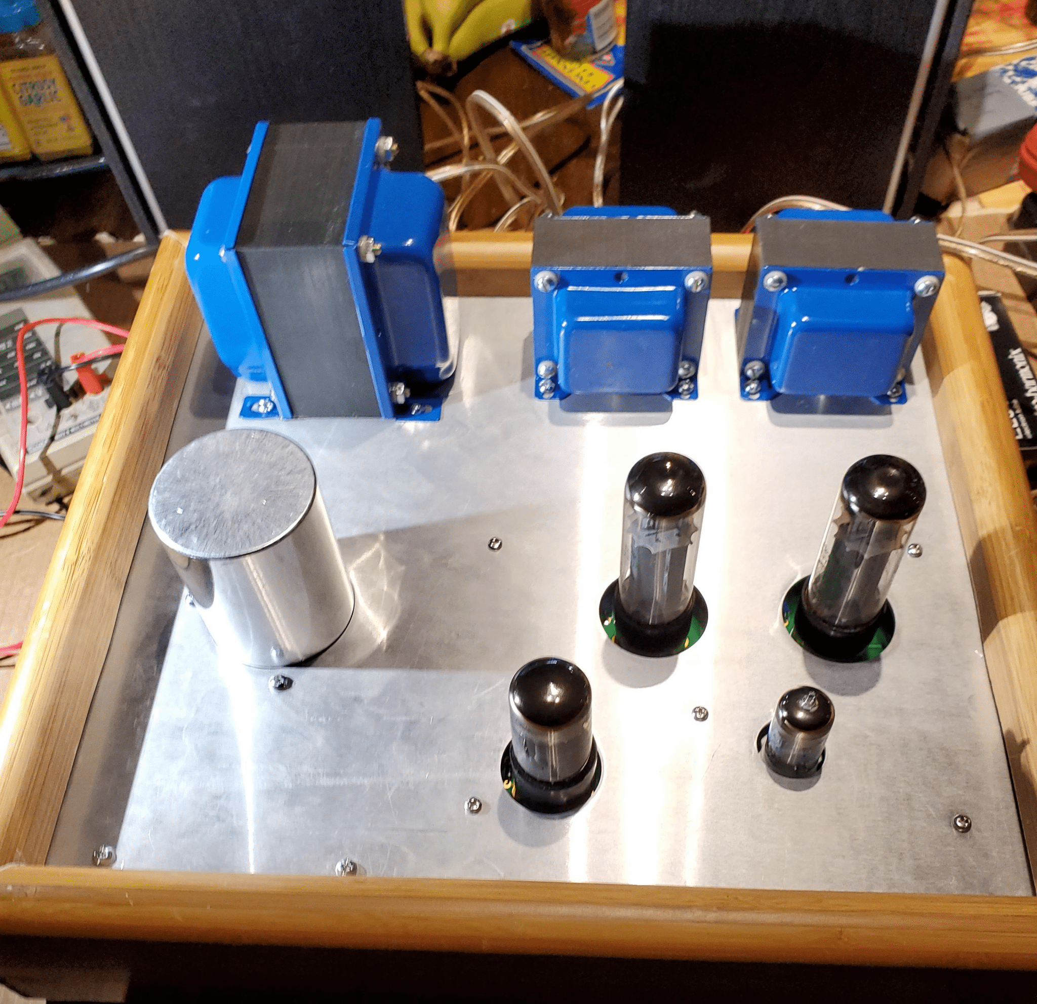

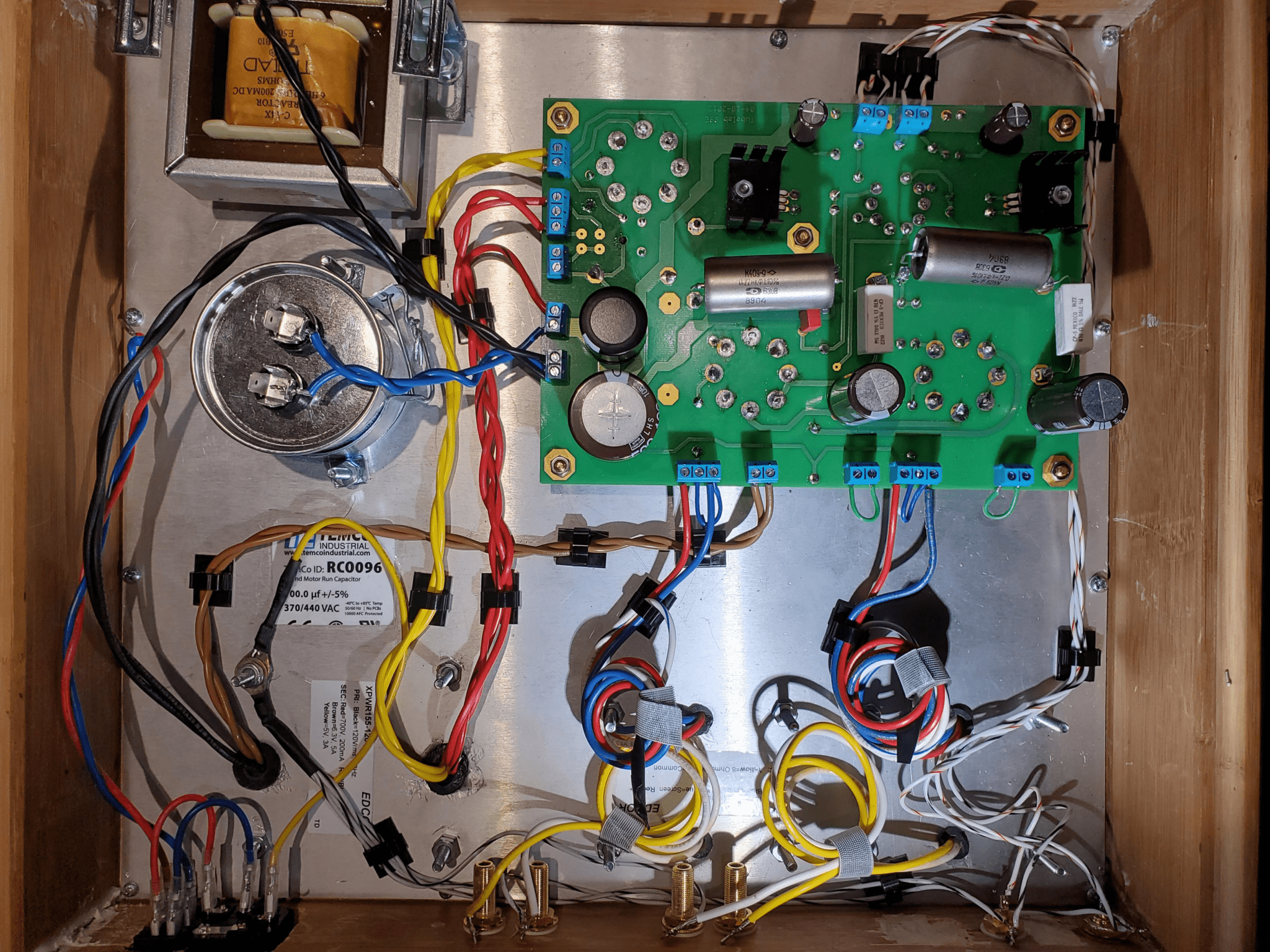

Here is a pic of my TSE.......you can see the four button head screws where the board is "hanging" from the top plate. I cleverly used the screw in the upper left corner to mount the fancy choke. ;-) The power transformer is an Edcor that I painted the end bells with some rattle-can hammertone rustoleum and used stainless screws and acorn nuts when I reassembled it.
...and there are some ventilation slots in the top plate between the transformers and the output tubes.

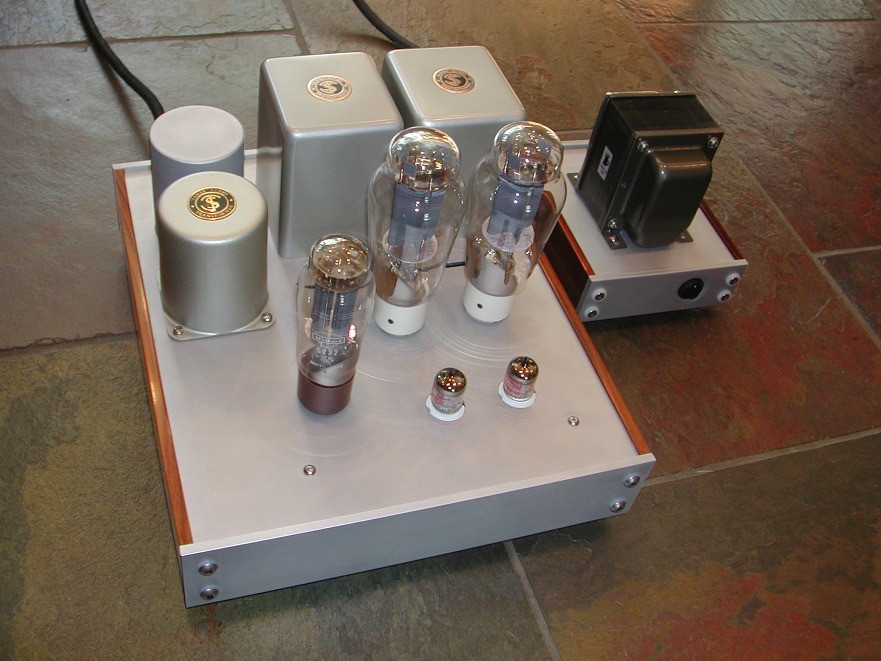

This is the first SSE I built. Goodies on top.
Note that I am NOT a woodworker so I used stair nose molding to build my case. Including a goodly bit of "measure once, cut twice & it still don't fit."
The underside pic will give you an idea as to possible wiring. This SSE is set up as triode strapped with no cathode feedback. Please note that the A/C mains are not wired in & connected in the picture shown.

Looking at Tony's amp (and my amp) it's worth mentioning that you may want to source a motor run cap.........not required, but a nice addition.
.....the motor run caps are the large round cans shown on both Tony's amp and my amp. You can get them on ebay......or your local HVAC supply house.......the bigger the better. They optionally are wired in parallel with the last cap in the power supply, C2. If you want to do this you need a motor RUN cap not a motor START cap. These are typically paper-in-oil and they have a few properties that augment the ability of the power supply to provide current fast.
