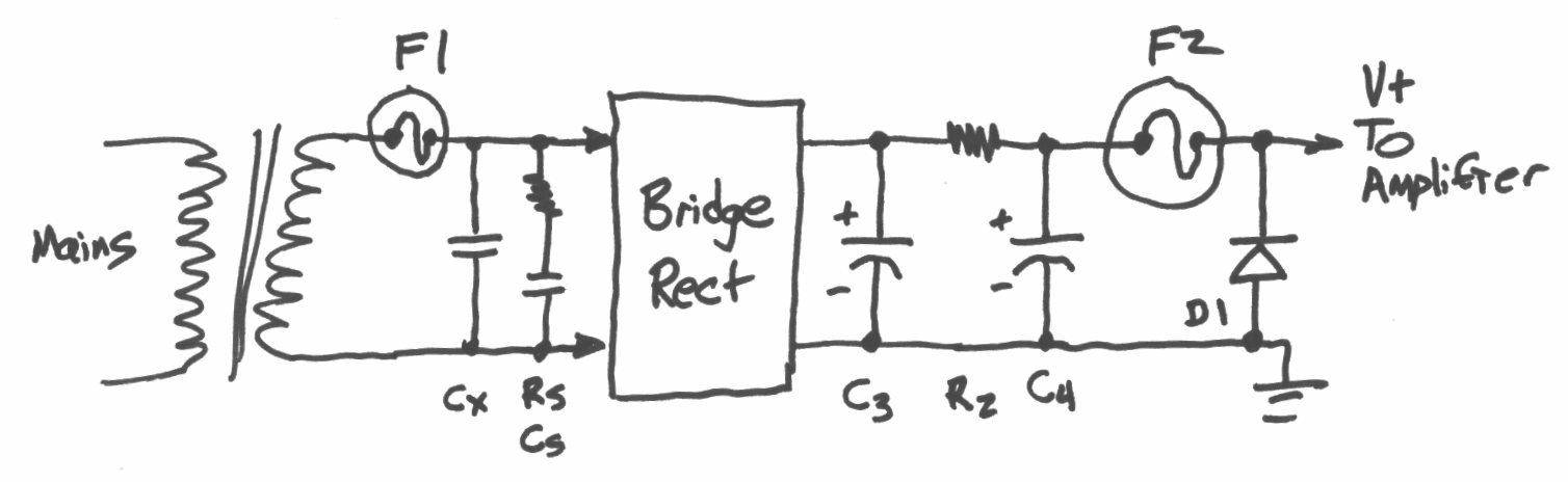

Has anyone ever measured the inductance of a fuse? Specifically, a slow-blow fuse such as "F1" in the schematic below, placed in series with the transformer secondary. The inductance of F1 directly adds to the self-inductance of the secondary.
Conventional wisdom (D. Self et al) suggests that F1's job is to protect the transformer in case the bridge rectifier fails as a short. While F2's job is to protect the power supply in case the output transistors fail as a short. The transistors are destroyed of course; F2 is simply trying to prevent further damage inside the PSU.
Thanks for any measured data or laboratory results!

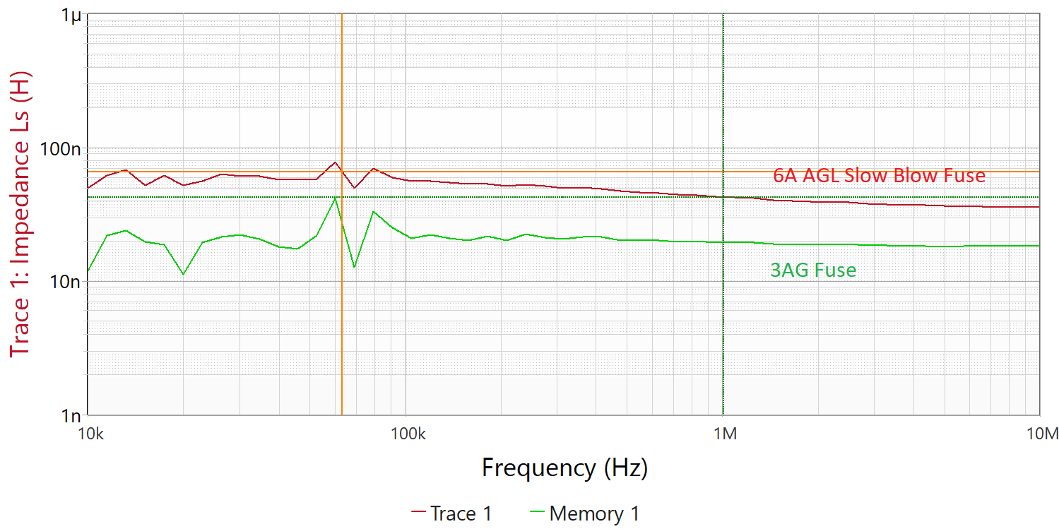

I used Quasimodo (naturally) to measure a 5mmX20mm 5 ampere slow-blow fuse.
With Cx=10.1nF {measured on a DER EE 5000 and also on an AADE LC-meter II}, and two 12-inch crocodile clip jumper wires between the fuse and the bellringer jig
  • Fuse shorted: Osc_Freq = 1.43 MHz ... thus L_total = 1.24 uH
  • Fuse intact: Osc_Freq = 1.37 MHz ... thus L_total = 1.34 uH
Subtracting the two gives L_fuse = 0.1 uH which is in rough agreement with other people's measurements.
The good news for audio equipment builders is: the inductance of the fuse "F1" is a tiny, tiny addition to the self-inductance of the transformer secondary. Even if you omit the fuse from your wiring harness when you tune your secondary snubber(s) with Quasimodo, the difference will be small. Aaaah.
