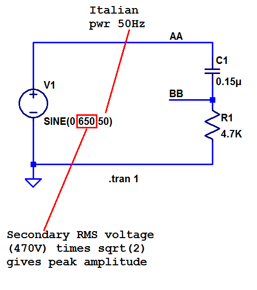

I've recently checked with my Quasimodo a 460V transformer used in a DIY tube preamplifier. Required resistance is 4K7. So I installed the two caps (600VAC rated) and a 3W resistor. Its temperature is reasonable, 50/55°C (around 125°F) and I can measure 100VAC (RMS, read by a DVM) over it.
I tried to apply a Ohms law (RMS, resistive loading) and found over 2W dissipation. But I believe it'd lower because of the "low" temperature.
Would someone be so kind to give me some inputs on this matter?
Yes the full EE math with pencil and paper predicts 100V RMS across your snubber resistor and 2 watts of RMS power dissipation.
LTSPICE simulation gives the same result, schematic below.
It's wonderful that your 3W resistor is very efficient at dissipating heat into the surrounding air, without its case becoming uncomfortably hot. Some 3W resistors are not so efficient, and their exterior case does become very very hot.

Many thanks Mark for the lightning fast check!
The resistor is a cheap Vishay PR03 series 3W metal film one. I think I'll have better to check its temp once again and probably anyway replace it by a 6W one! That would be a much better and suitable ratio IHMO.
This resistor (PR03) is fusible and it might blow without you even noticing …
You better find a better resistor for the job.
Metal oxide for example.
Here is the math to calculate power dissipated in the snubber resistor. It is typical of a homework problem given to 2nd year EE undergraduates taking their first Circuit Analysis class.
You may decide that the LTSPICE simulation method shown in post #1351, has much to recommend it after all. But either path will lead to your final objective.
Please remember to make the actual resistor in real life, at least 2X and preferably 3X the wattage, compared to the calculated power. This gives a margin of safety for reliability and a long, long service life.
