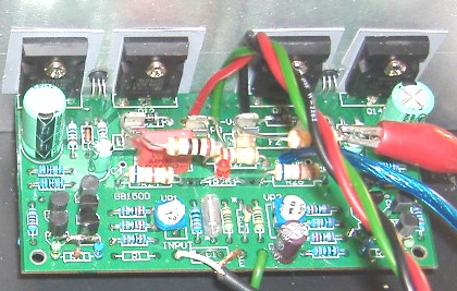

Hello all!
Have to agree totally with HiFiddle; this zener psrr mod. elevates the gb150;listening to some older vynil is a happy event.This is my main amp now.
My bias does hunt as well but have not noticed any sonic difference.
Here is a pic. of the zener mod.,since then I have gone to a more modern polypro .47uf bypass cap.
cheers
Thor
Hello all!
