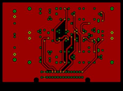

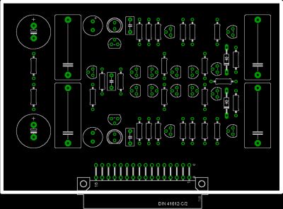

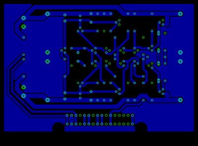

Ok, I did some more work on this project last night, but have to stop now until next month.
I will build the two channel's active circuitry on separate, small modules, which will be plugged into a mother board. The pot resides on the motherboard between the two modules, while the power supply stuff goes left and right of them. There will be a separate PCB for input switching and for the transformers and pre-regulators.
I will build a prototype version of one channel to experiment with the circuit a bit. Find below a preliminary PCB layout.
I decided to place a R-C-lowpass with Panasonic FC caps on each rail, accompanied by two Wima MKP-10 film capacitors.
It is a double-sided PCB, but there are no vias and top side tracks are only placed where they can easily be accessed and soldered (e.g. on transistors and resistors).
I'm using various PCB systems, the one I used for this project is Eagle from Cadsoft. There is a free evaluation version which is limited to a 100 x 80mm board size.
The rest is pretty straight forward: Laser print it to standard paper, make the paper transparent using cooking oil (sic!), light, develop, etch.
BTW, I'm using a special hydrochloride acid etching bath, but I'd like to have a "clearance" from a moderator before posting this.
