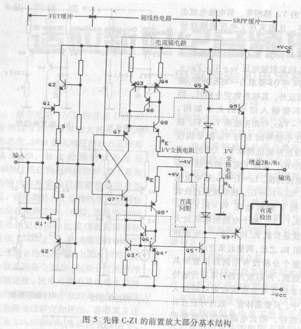

AMT-freak said:
I don't know a Pioneer CZ-5. What is a Gm amp?
sorry for my poor English and my mistake.
to correct my last post: the 'Pioneer CZ-5' should be the 'Pioneer CZ-1 ' pre amp,which made in Japan in the 70's or 80's.
'Gm amp'....I can't explain in English.'Gm' is the important parameter of FET, maybe I should say 'Notron amp' .
Here is the Pioneer CZ-1 circuit printed in a Chinese audio magazine.

Jam, I see your point now. I had a simple pot in my mind, as shown in the schematic. For a pot, I think there's no big difference between ordinary and shunt topology.
In my last preamp, I used a circuit as in the Constand impedance relay attenuator thread, but I found it sonically inferior to an input and output buffered high quality pot (Panasonic CP). It depends on implementation, of course, but looking at the number of components in the signal path and board size, I'd rather go back to a simple pot this time.
