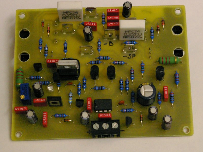

I just worked on my amp when I switched off a fluorescent lamp. Unfortunately, the lamp has not suppressed and sent sharp transients into the power grid. Mostly only a crackling was heard, but not this one time. The MOSFETs have died instantly. :mad:
So I had to have install protection diodes in the circuit ... and troubleshoot my fluorescent lamp. :smash:
I've also improved the layout again. It is now smaller and the VAS has a thermal coupling.
This is the final circuit:
And this is the Board:
Also, I've changed some parts so I will use the stronger IRFP140N. And the power source for the first differential amplifier I have also changed. In the first cause because of the thermic coupling.
A detailed description can be found on my website. There are all documents.

Always use protection diodes with every mosfet amp, even it is a drain follower, putting source on supply cause easely a transient killing the mosfet even as the 330 ohm resistor give it some protection, zeners of 8 volts are here far enough, how do it sound?
the mosfets U use are without diodes,
The diodes are build in. And against spikes at the gate there are Z-diodes (15V).

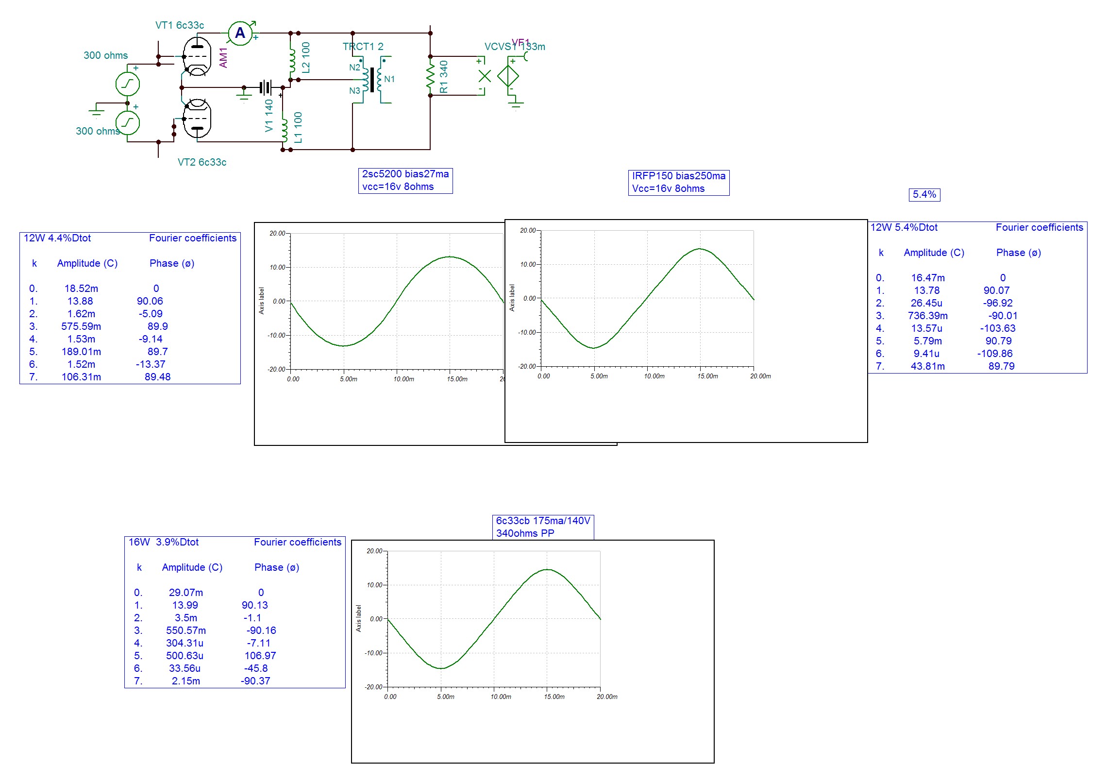

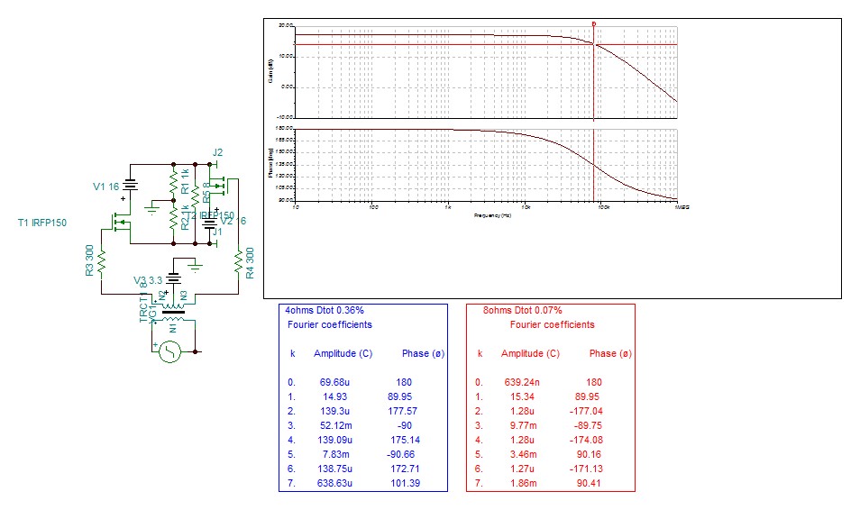

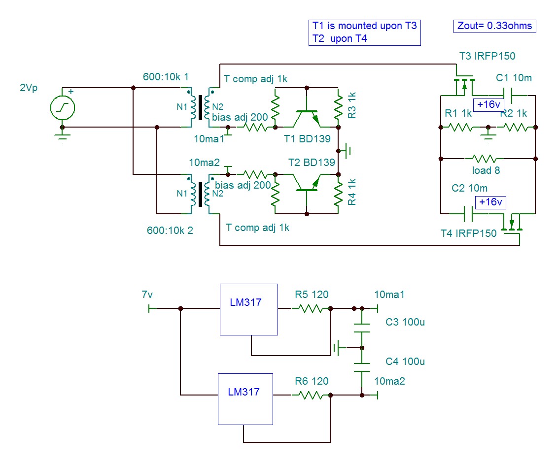

back to the starting block
This was the initial idea of circlotron that I restart.
First I intended to have it in class A mode, but after analyzing the comparative distortion behavior with negative phase 3rd order harmonics , I found it more interesting to have it in class B.
With 4ohms load even the fifth gets negative reducing by this the loudspeaker's 3rd and 5th distortion, and expanding the dynamic.
