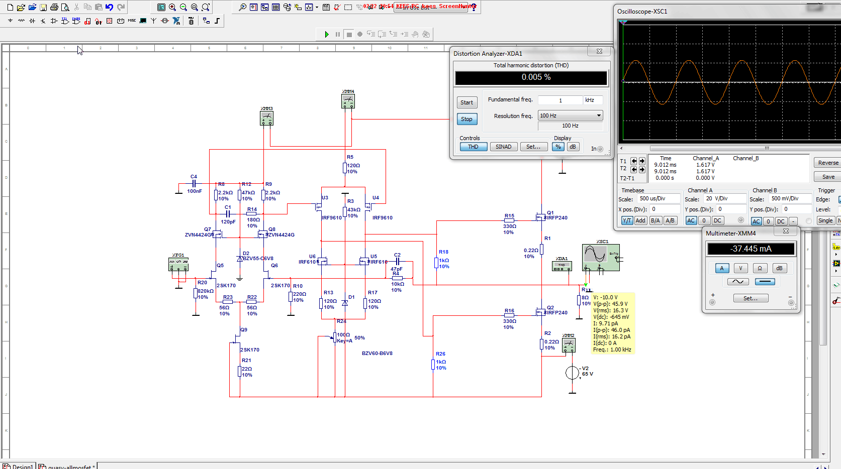

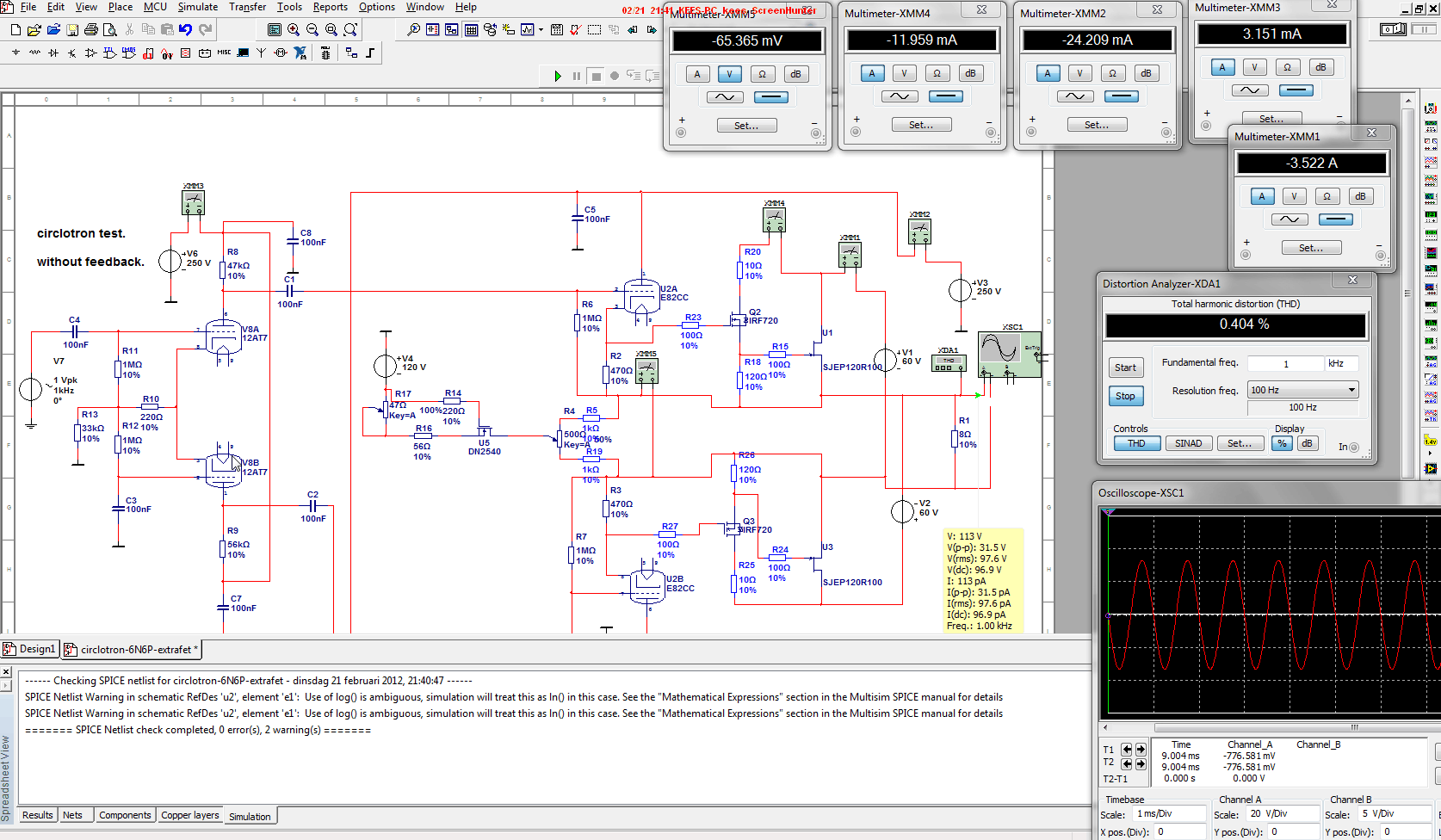

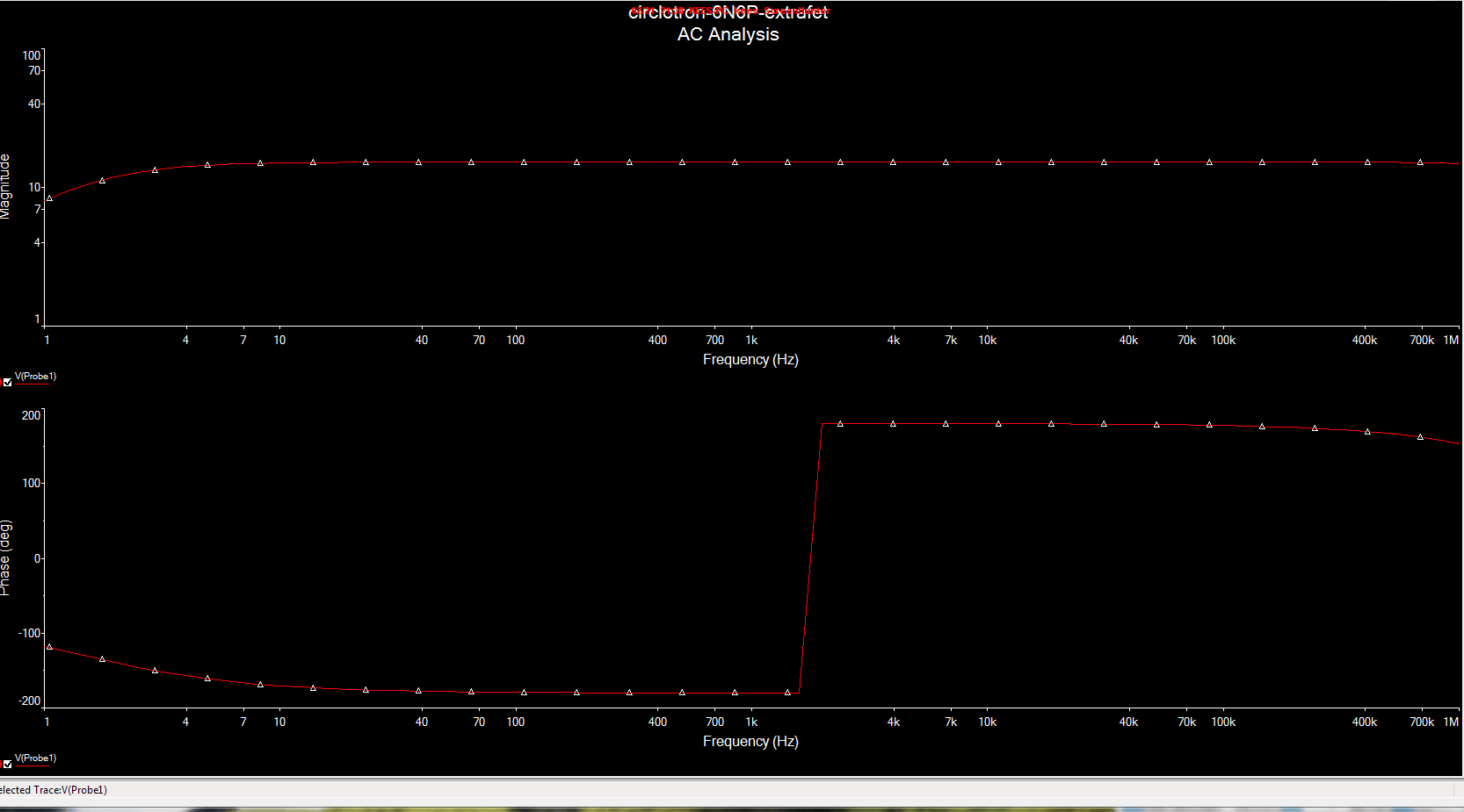

I did only simulate, the schematic of the circlotron is not tested with the irfp transistor, it loos promising, see the bandwith of it it touches 1Mhz, the faseflip is a problem with multisim, it behave very strange in windows 7 sometimes.

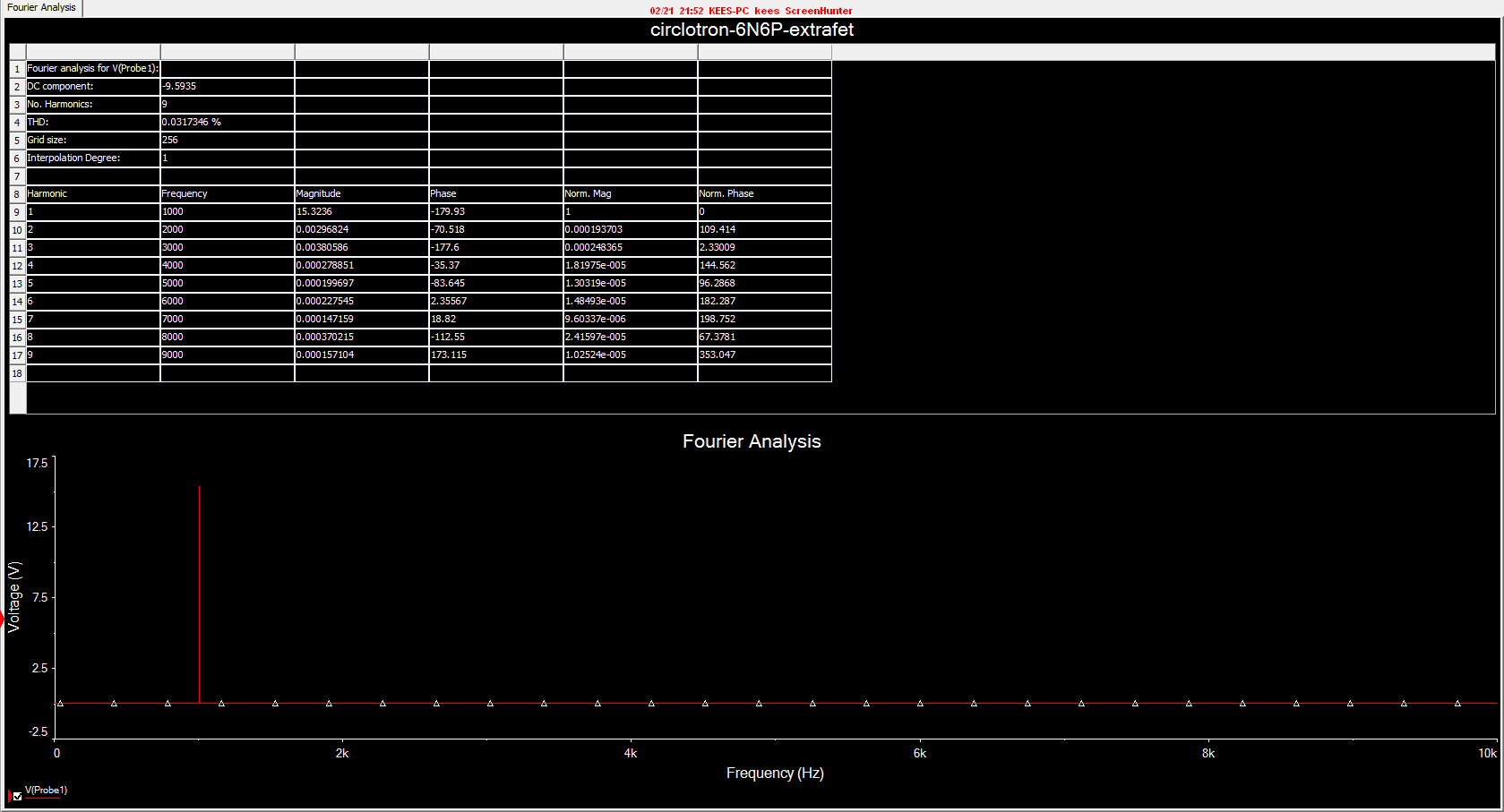

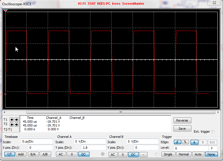

I test here the semisouth and the hexfet, last is less distortion, see distortion on last pic, .000 at high frequenties, so it can sound very good, this one I go testing later on, have to implement a offset servo because of tubes that is easy.
regards.
regards.

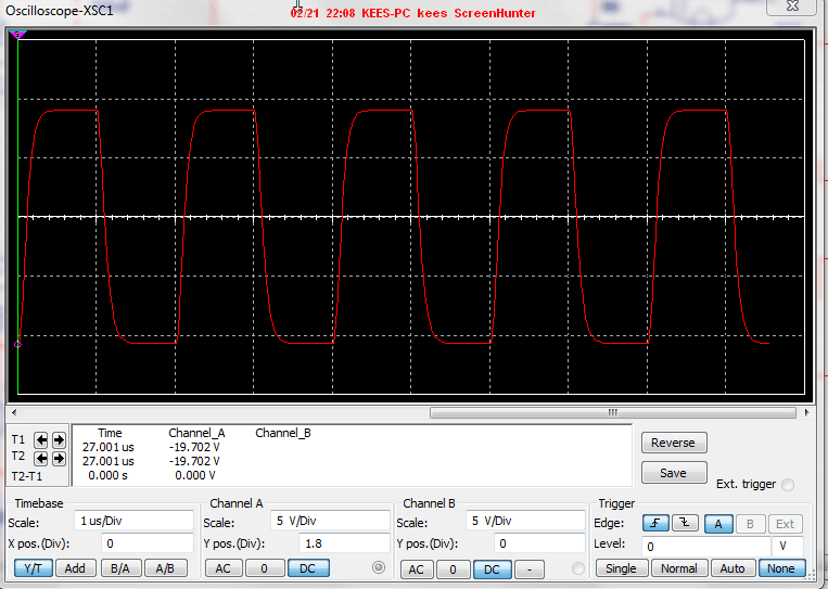

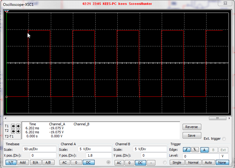

and some square waves, 10 Khz, 100Khz, 250Khz, and 500Khz.

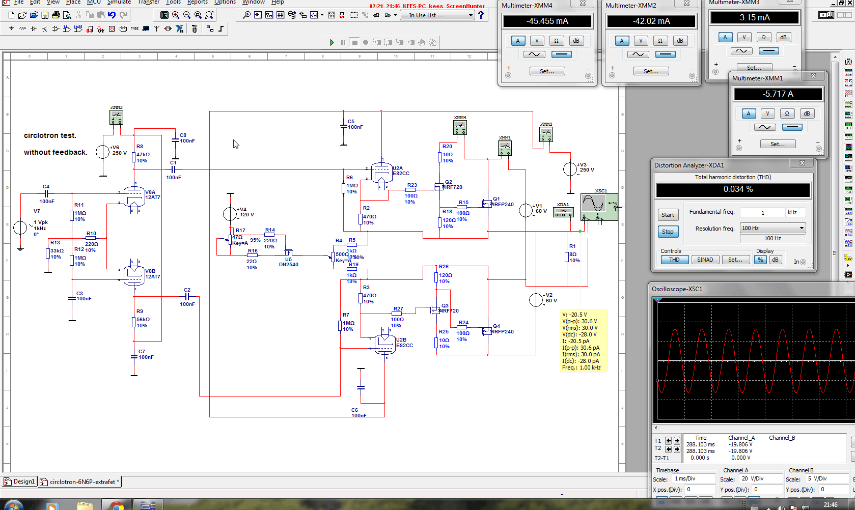

not bad for tubes, but is it real? well, I have to measure in real, then we now.

This is a version for fet-lovers and it works also with low distortions
R23 is a pot for offset.
Good one, has current feedback, best in feedbackland, independence in bandwith and very high slew rate, only unstable in offset so tracking servo
is maybe needed, I don,t now with circlotron, but it is more needed.
some people has fear for voltage to the speaker, wel with a normal complementairy output you have also the same proplem as one mosfet fails, you have then als one voltage rail to your speaker coil.
circlotron can be made super balanced with all n fets or even only pfets or transistors.

ahh oke, yes now I see it, the first diff amp is voltage feedbacked, I was confused because I look to fast to the first two jfets.
I can drawn it en simulate, to see what it does.
Do you now kaneta amp. with this schematic I have use that idea, there is not much new possible in amp land, only combine these technics can give something new, best way to listen music is still live like a musicband without amplifiers.
This amplifier has voltage feedback, and bandwith and slewrate is a lot less then the hybrid circlotron version, but stil a joy to test it all.

I had a little problem with square-signal. The were a small overshot like a unstable behavior. But the circuit is very stable, so I wondering what it means.
Now I discovered the problem. It is the negative feedback. When I use a coil in series to the measuring resistance, the square is clean.

paralelliing a capacitor over the feedback resistors will remove overshoots, make value so that overshoot is barely visible. amp overshoot is like a fast car, if it hit the breaks it not stops a la minute.
your amp is fast, so, try, both parts afcourse as the ciclotron has two parts out of fase.
see posts 63 here how fast a hybride is, a allfet or bjt hybride is even faster.

it is strange the overshoot appears until approximately 10V at the sense resistor.
You can easily drive a load of 1μF/8ohm.
In complementary amplifiers, the capacitor is often the root of all evil. I usually tried to avoid him. When complex loads are driven it can easily lead to phase problems.
But I give them a try because the simulation looks very good and at the measured resistance, it seems to work well ...
